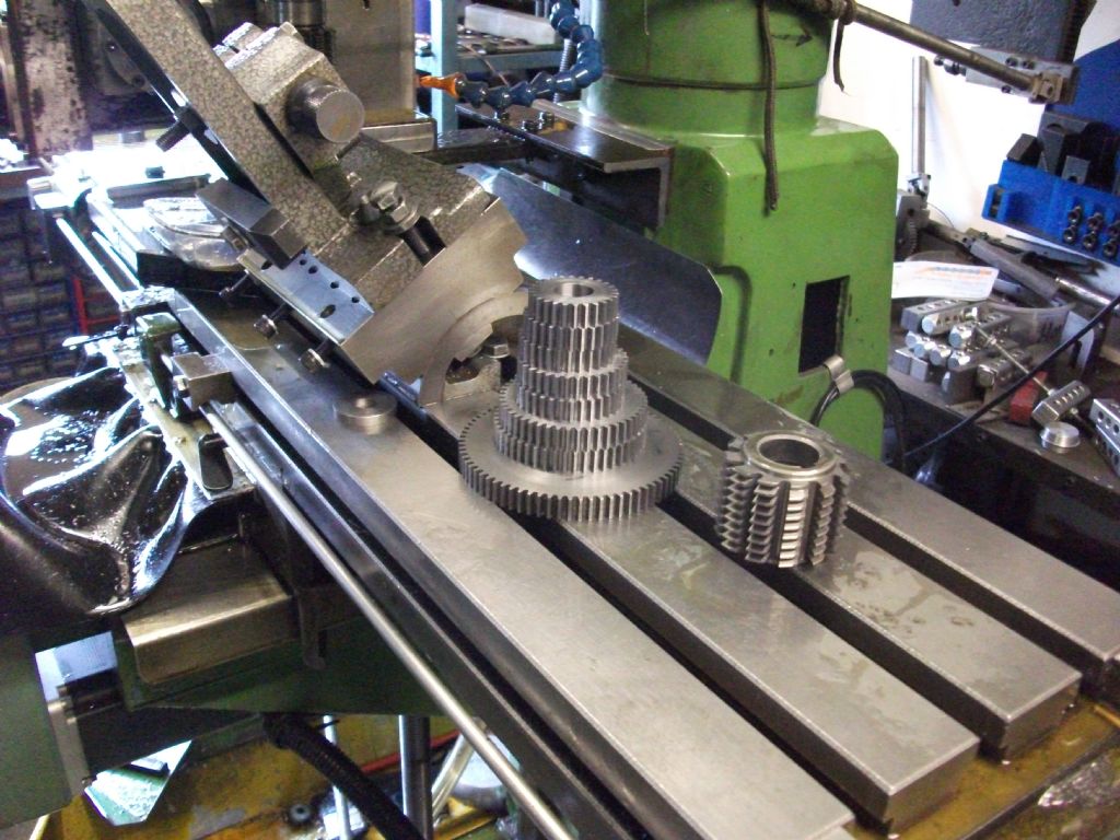

                                                #493465
                                                John P
                                                  @johnp77052
                                                  From my last posting here have bought new 20DP 20 deg PA
                                                  hob from Aliexpress ,arrived in 2 weeks ,identically similar to
                                                  the 14.5 PA that was from Arc euro ,they have about 90 or
                                                  so gear cutting hobs ranging from .1 mod to about 8 DP.
                                                  http://www.aliexpress.com/store/group/Gear-hob/1503094_510830882.html?
                                                  spm=2114.12010108.0.0.30fe2a2eMkcaRV
                                                  Seen here on the mill the Arc Euro 20 dp hob cutting a 73 tooth
                                                  Myford changewheel .Home made R8 arbor has some additional
                                                  underarm support bolted directly to column, i think this is
                                                  essential with this size of hob (50 mm OD) .Cuts steel gears
                                                  at 190 rpm full flood neat cutting oil cut depth .1115 inch.
                                                  Second photo some cut Myford gears and new 20 dp hob.
