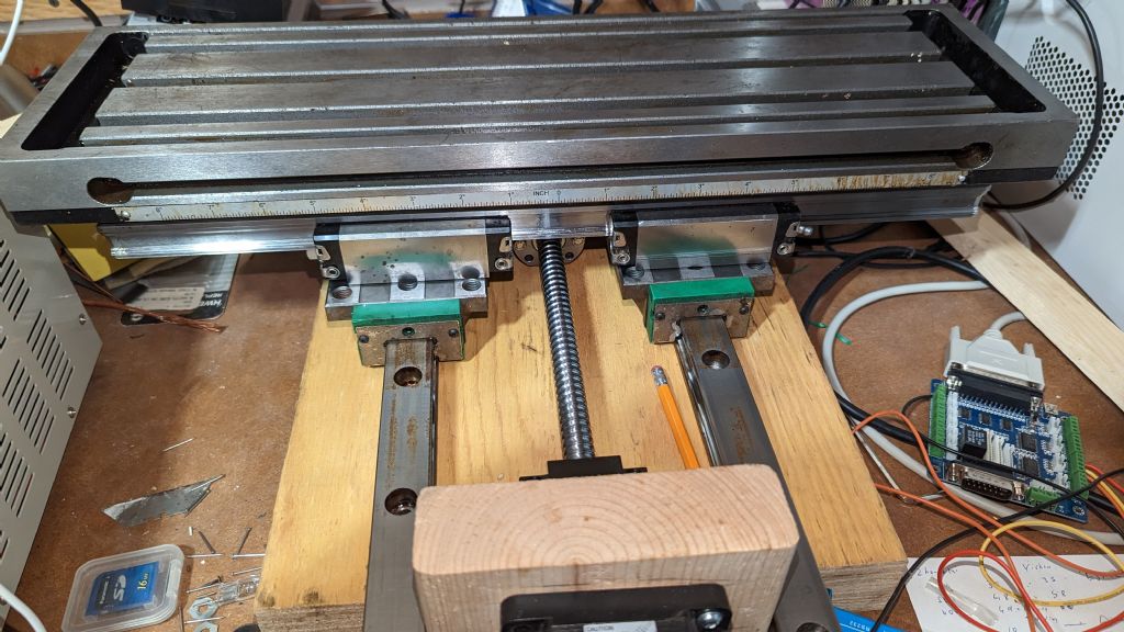

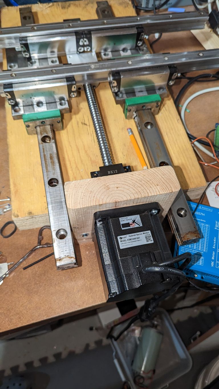

                    Here is the breadboard version of my mill to be:
                    The rails are a bit of an overkill. Got the 30mm 500mm long (y-axis) I picked up on ebay for US$99.00. Better price than many smaller axes so I simply could not resist.
                    Stepper is a hybrid stepper which is basically a stepper with a position feedback loop.
                    Table is off a Shop-Fox M1111.
                    Motor on the floor (in the box is a brushed 90V DC 3/4 HP motor that is planned to drive a modified Taig headstock. Headstock is still in original condition as are most of the parts.
                    #622561
                    Manfred Vormbaum
                      @manfredvormbaum50307
                      Very little bolted together yet. Still trying to figure how to get things together so that I can still align and tram things.
                      With the table:mill-bb-table01.jpg
