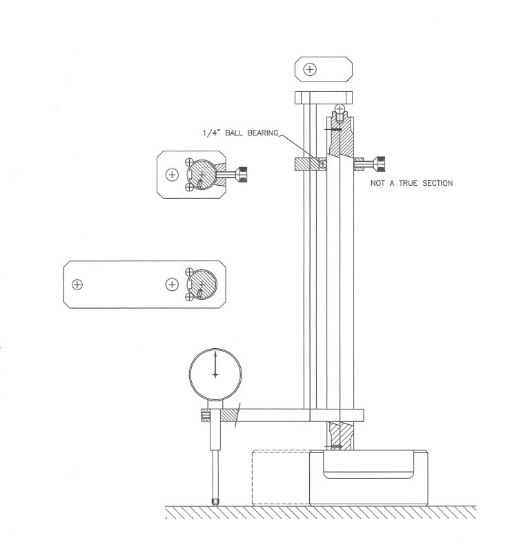

                                    Kiwi Bloke, I like your idea as it can be trailed easily using my FB2 milling machine, tomorrow.
                                    Regards
                                    Gray,
                                    My original idea was to make the Checking Tool below, but thanks to several trains of thought put forward, I can now check this before I set too making the tool.
                                    The Ball at the top of the column gives a constant point of contact. Two 1/4" ball bearings in each of the arms contact the column 90 degrees apart. The weight of the DTI will probably tend to pull the top arm out of contact, so the clamping screw may be needed. An additional screw might also be needed in the lower arm due to the reaction from the force the clock exerts on the probe.
                                    The Tool is first clamped to the one side of the column and the DTI is set to zero. Releasing the clamping screw(s) the tool is raised and rotated about the column and reset. Any deviation will be shown on the clock.

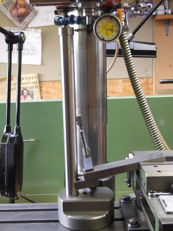

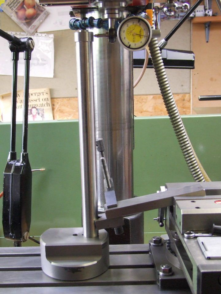

                                          Yesterday was spent checking the Column out. I first turned a "Cup" shaped bush to fit the top of the Column which removes the need to avoid the two key slots in the Column. As this was turned on the O/D and bored at one setting concentricity should be assured. The "Fit" on the Column was very close but I was still able to rotate the bush on the Column.
                                          The Vee block attached to the parallel in the vice machine is purposely angled down in order to present two knife edges to the Column. This ensures only point contact and that any out of squareness in the Column is not masked by a full on Vee block face.
                                          Once the set-up was ready the assembly was placed against the Vee block and the DTI brought into contact. Traversing the Y-Axis the null point was found which meant the DTI was on the Column centreline, (this procedure is repeated as the Column approaches perpendicular, to remove any further sources of error).
                                          At this point the Bush was also rotated on the Column to see if there were any errors in the machining, which there weren't. It always pays to check.
                                          The contact face for the Column is a spot face done by mounting the part on the faceplate.
                                          The initial out of squareness was 0.1 mm in the Y-Axis in the above photographs and 0.05 mm in the X-Axis. Using my Pull Scraper and removing barely 0.005 mm from the surface of the spot face opposite the maximum errors had the Column, virtually perfect.
                                          The maximum error in the X-Axis was 0.005 mm leaning towards the centre of the Base Plate. In the Y-Axis the there was no discernable error. Turning the Column in the Base Plate by 180 degrees gave exactly the same results. Which is what I would expect as I already checked the Columns straightness using two Vee blocks and a Clock on the surface plate.

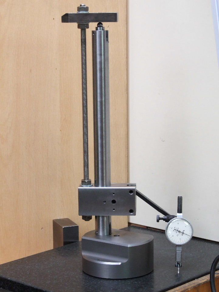

                                              The opening line is that this is a Clock stand with a difference.
                                              The difference being is that this Clock Stand will traverse a DTI vertically and check to see if a machine element, or a machined face on a component is dead square to a reference surface. Such machines are an "arm and a leg" to buy, and are a dedicated item, not dual purpose.
                                              This design was initially a good Clock Stand, the facility to check a Vertical was an optional extra I thought would be good to have in the home workshop. Also I did say the DRO, to make it into a height gauge was another afterthought.
                                              I have a Height gauge that I designed, and it has served me well for over 40 years, so really I don't really need a Digital version, but I am always open to try something new.
                                              Lastly, while a commercial Height Gauge is going to be pretty close to a true Vertical, those I have looked at give no accuracy guarantee for perpendicularity, and in 40+ years in industry I have never seen one used for this purpose. The one designed here will.

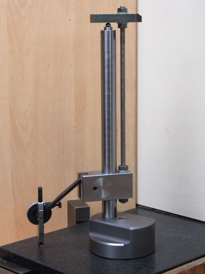

                                                I have managed to finish the Slider today, so took the opportunity to do a second check for Perpendicularity.
                                                Since posting on here last John Slater drew my attention to "Monday Night Meatloaf 116 P2" on YouTube. Tom Lipton is making a similar dedicated device and has a novel way of checking the perpendicularity.
                                                I had watched this sometime ago but forgot all about it in the interim, so I must thank John for refreshing my memory and saving me some work.
                                                Rather than make something as Tom does in his video, I have used a piece of M8 Studding (Allthreads) and one of my Milling clamps to give the same results. Note the Ball bearing to give point contact at the top of the Column.
                                                In this initial set-up I had an light reading, (error), of 0.005 mm at what will be the front of the Clock Stand. This I expected as my first tests before showed a slight lean on the Column of this magnitude towards the centre of the Clock Stand. The clock is sweeping a 200 mm diameter circle and the location points in the FB2 shots were about this distance apart.
                                                Rotating the Clock Stand through 180 degrees and repeating the check showed a similar error but this time it was only 0.003 mm. I know from the report that came with my surface plate that it has a slight hump. Thus when it comes to chasing these sort of errors there comes a time when it has to be accepted that this is good enough for the workshop concerned and any further work is meaning less.
                                                One thing this check does show is that the first set-up using the FB2 Mill is a sound one.
