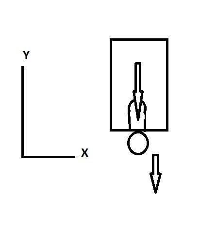

                                    Chris climb and conventional really only applies when using one side of the cutter upto about 1/3rd of its diameter.
                                    In your sketch if looking down the spindle then the part of the tool between 9 and 12 o'clock is conventional and from 12 to 3 o'clock is climb and the two forces will cancel each other out so no real risk of the work being drawn into the cutter. In fact the area from 11 to 1 o'clock will have little effect in the Y axis but if a very deep cut were taken there is a chance the tool could flex to the left.
                                    Edited By JasonB on 23/09/2020 18:35:37

                                        Jason, OK I think I get most of this now, my error was not understanding that cutter direction matters only in relation to where it is milling on the stock (silly idiot).
                                        Having said all that are there rule of thumbs for positioning the cutter on a certain side and moving the stock in a given direction?
                                        Such as for taking a face cut off with cutter in front of stock at left front corner move stock to left for conventional milling?
                                        Chris

                                          Chris,
                                          Just consider your own sketch, and what would happen if you decide to widen that slot by shifting left or right on the X axis.
                                          Thinking it through is usually better than learning ‘rules of thumb’ by rote.
                                                Good point Michael. My sketch wrongly has cutter force represented as a single force. In the sketch as is opposing forces cancel out trouble. However it is an interesting point if I went to widen the slot. I could cheat and just take light cuts of course which is probably all that is needed. If a larger increase is called for then if I was to use the same cutter, each side would need to be positioned accordingly.

                                                    Emgee the straight arrows are the direction of the work, compare my video on previous page with what's shown in the drawings and it's conventional. See the text that goes with it

                                                      Thanks Jason, when struggling to first get this understood the arrows can be confusing. Here they show cutter movement which translates to stock feed with cutter still. It is easier to understand with arrows denoting the stock feed direction. Not a problem now i get it (hopefully).
                                                      So a quick summary, please put me right if I go wrong:
                                                      1. Lead screw mills should use conventional milling as table forced with each flute against back lash)
                                                      2. if only light cuts are to be made you could mill in either direction
                                                      3. No baring on plunge cuts (hole making and slots)
                                                      4. If heavy cuts are taken opposing forces cancel each other out. (why on earth would you take such a big cut, not on my Sherline I think/)
