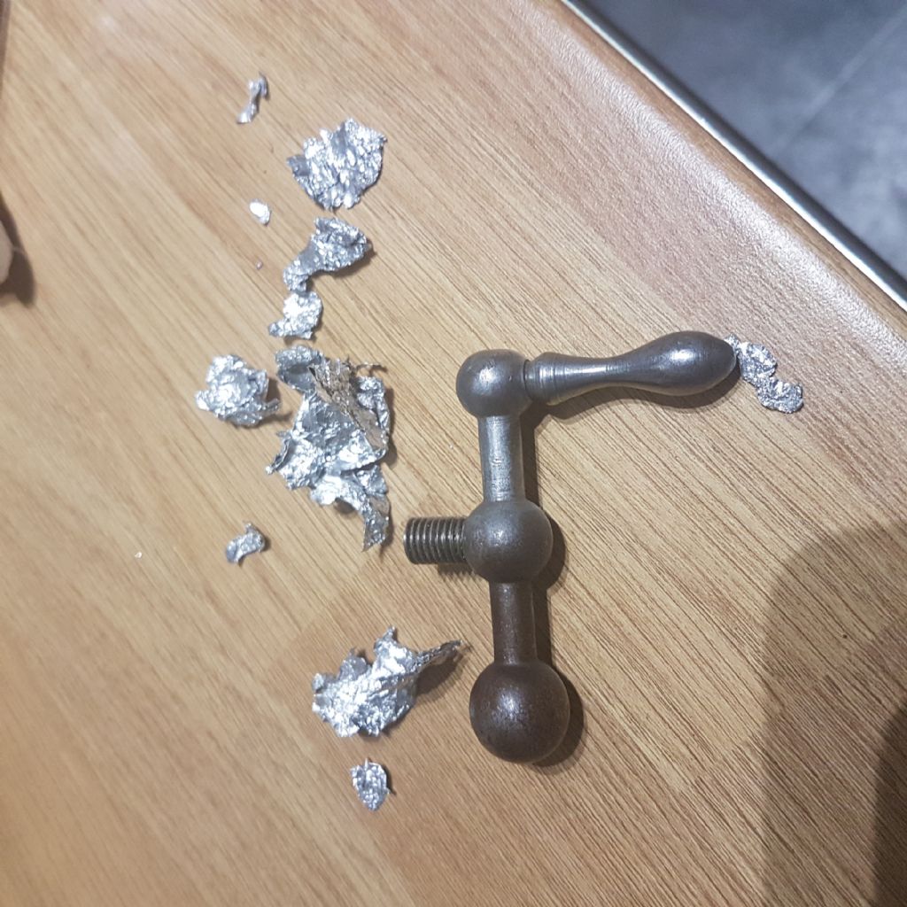

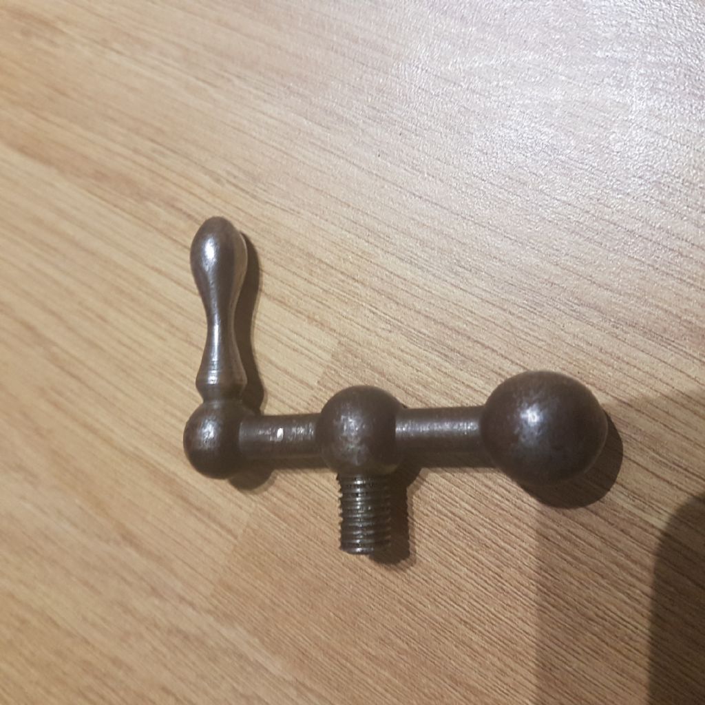

      I want to clean the surface rust from the handles and gears and mating surfaces on my lathe, the rust isn't horrible orange colour, but as I plan to strip the lathe down for a clean, I was wondering about cleaning the dark brown surface rust from parts like the handles, to make them look a little nicer.
      I'm wondering the best way to go about this, and the methods that come to mind are…
      1. buffing wheels, and some polishing paste
      2. fine wet and dry paper and oil
      3. wire wool, then scotch bright pads in various grades.
      Which do you think will be the best solution to give a long lasting finish that doesn't damage the metal under the rust. I have read the myford user manual and that states that there may be a fine rust that appears on the surface but this should not be detrimental to the machine, however I would much prefer not to be taking pic's of rust when photographing parts that i'm making.
      Whats the methods you would use?

              For any pitted rusty chromed surfaces such as handles, where you don't want anything too aggressive, one of the motorcyclists' tricks is crushed aluminium baking foil and Pepsi/Coke rubbed vigorously.
              Works a treat.
              Bill

              Jon Cameron
                @joncameron26580
                Thanks for your replies, I have just had a read through the link that Oldiron posted. Lots of interesting ideas including using potatoes, not the first time I've heard of the humble potato been used in machining, the other use is for tempering tooling. So thanks for that one.
                Mike, thanks I was wondering about whether id be making a rod for my own back.
                Bill, My partners used foil for cleaning battery terminals, when they are corroded so Ill look at that on a spare handle I have before I go further onto doing it to the rest of my lathe handles. I can see that coke/acid been a bit of an issue on the lathe though, I was wanting to avoid any strong chemicals, (I have a two year old in the house and four other kids that stay over weekends), so these household methods are intriguing.

                    Bill I tried your method by the way, this took less than 5mins.

                      Posted by Jon Cameron on 01/03/2018 20:12:51:
                      Edited By Jon Cameron on 01/03/2018 20:34:20
                      It works well for things like motorcycle silencers, that might be impractical to use other methods. Spray the exhausts with Motorex 645 or its replacement afterwards, and it helps keep them looking tidy.

                            With regard to the aluminium rubbing technique – Does it actually remove rust or is the ally being deposited into the rust making it look shiny? …or maybe a bit of both?
                            Ed.

                                Ed when I did that little bit with the foil, a black residue was all that was left, so I imagine that the Ali foil turns the rust to Ali oxide powder.
