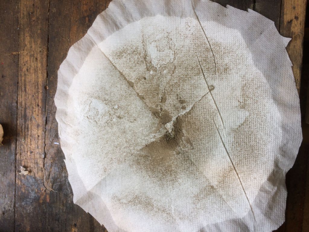

                                    #500086
                                    Speedy Builder5
                                      @speedybuilder5
                                      I have just micro wire brushed the 5" wheels (mounted on their axles) and preparing for painting. The final process was to wash in acetone – the photo shows the muck that came off when the acetone was filtered and put back into a can!
