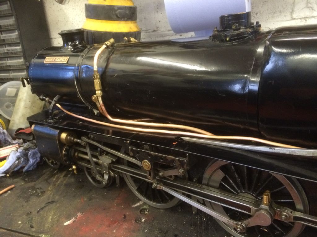

      Hi does any one else have problems with clack valves.
      I have bought 6 in total but cant get any that seal.
      I have tried putting an air line on to check with the other end in water leak past like a sieve.
      I have 5 = 1/4 and one's and 1+ 3/16 air passes through all of them.
      When on the Loco as steam gets up water passes back into the Tender.
      I have made sure the arrow pointing in the right direction of flow.
      I have tried tapping the ball in two of them with a Brass rod but still wont seal.
      Blowing with my mouth they seem to be sealing can all these be foulty or is it the way i am testing them.
      Ron

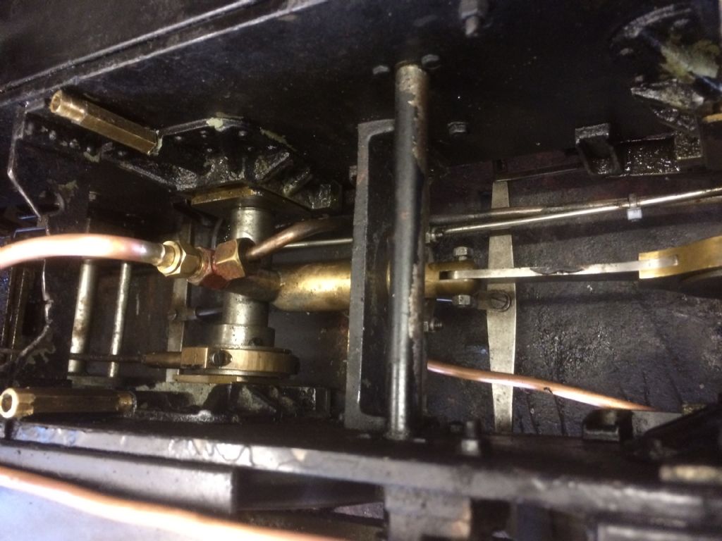

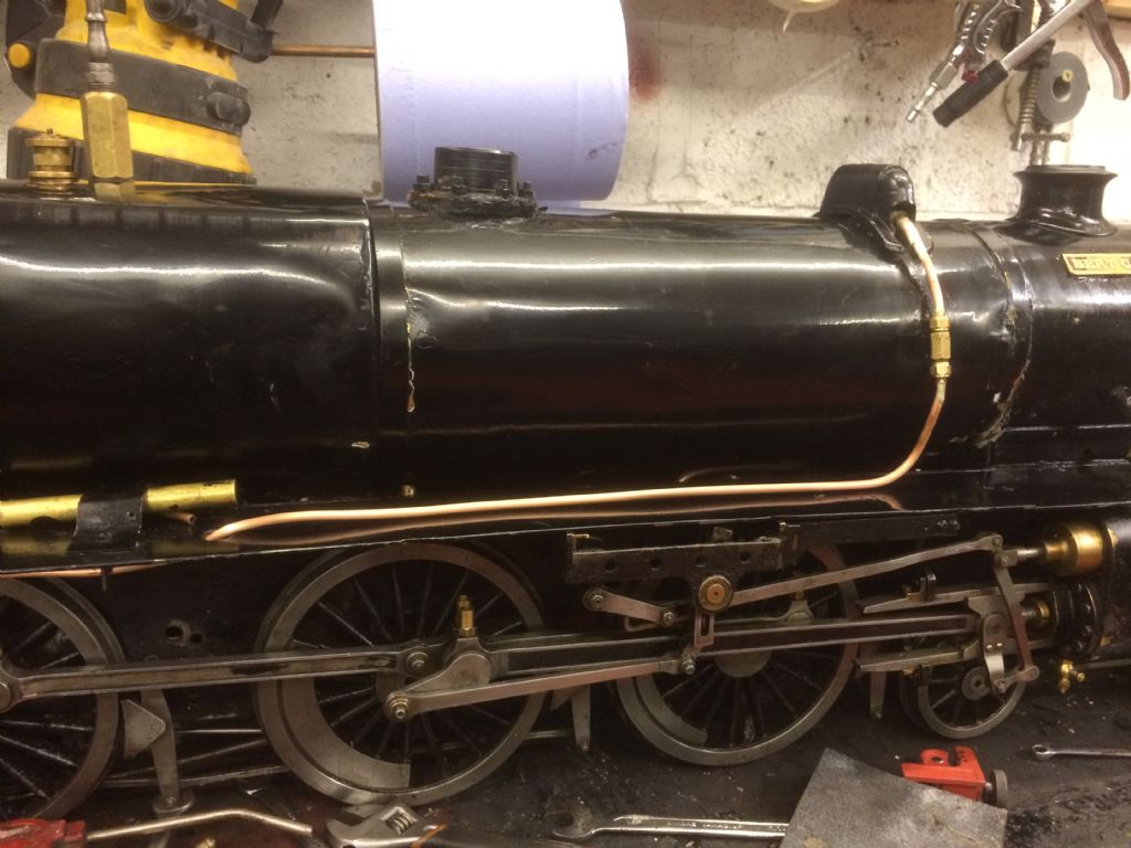

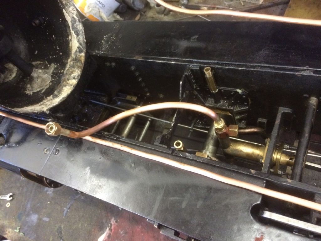

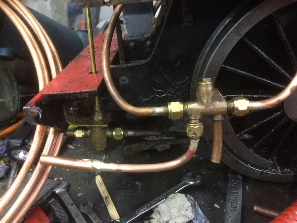

                        Posted by Ron Hancock on 15/09/2016 19:43:34:
                        Hi had several messages asking for Photo of the Pipe work hope this shows it ok.
                        i have disconnected the axle pump just going to run Injector and hand pump.
                        Julian is helping me by sorting my Clacks so might soon be running .
                        Thanks for all suggestions very much sappreciated

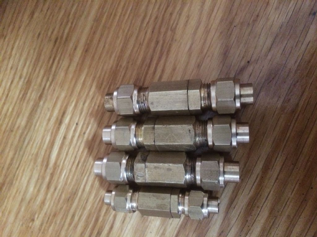

                                    I dont think it would be fair to disclose too many gripes, but of the 4 commercial check valves Ron sent me all 4 leaked.
                                    I've made countless check valves over the years. I dont think there is any magic in making them seal perfectly, just good engineering and machining practice.
                                    Ron's commercial inline valves were 3 of 1/4 ball, and 1 of 3/16" ball he sent me.
                                    The seats of the 1/4 ball type were badly made with the hole not reamed plus a chamfer on the seat. I took a whisker off each seat in the lathe, then reamed the holes. I used a hardened steel ball bearing to biff the seats with a proper drift then the stainless balls were replaced with precision ceramic balls. I also altered the other end which was a straight slot to 2 slots at 90 degrees and altered the lift which was rather constipated. All burrs were removed which wasnt the case originally. 2 or 3 of the originals had machining swarf that would easily have caused the balls not to seat, and another had thread sealent that was generously applied gumming up the works.
                                    All 4 tested on my compressor and sealed perfectly.
                                    I've seen some horrors over the years of commercial fittings particularly injectors. These were not badly made, just badly finished.
                                    They are back in the post to Ron tomorrow hopefully.
