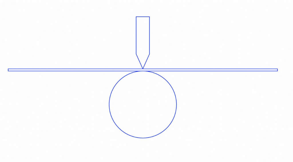

          In regard to your question about drilling into the centre of a bar in the lathe. This is not easily done to achieve an accurate position because the mill head can rotate about its post and its difficult to find the exact centre of the job. One solution that will give a reasonably accurate centre is to place a flat bar (150mm steel rule, etc) on top of the round material in the lathe. Then mount a pointer in the drill chuck and lower it onto the flat bar. Rorate the mill head until the flat bar is horizontal. (A similar method is used for positioning the lathe cutter height on the centre of the part but with the steel rule vertical). Any holes that you want to drill have to be directly under the drill as there is no axial movement of the mill. Therefore not a practical method of machining parts.

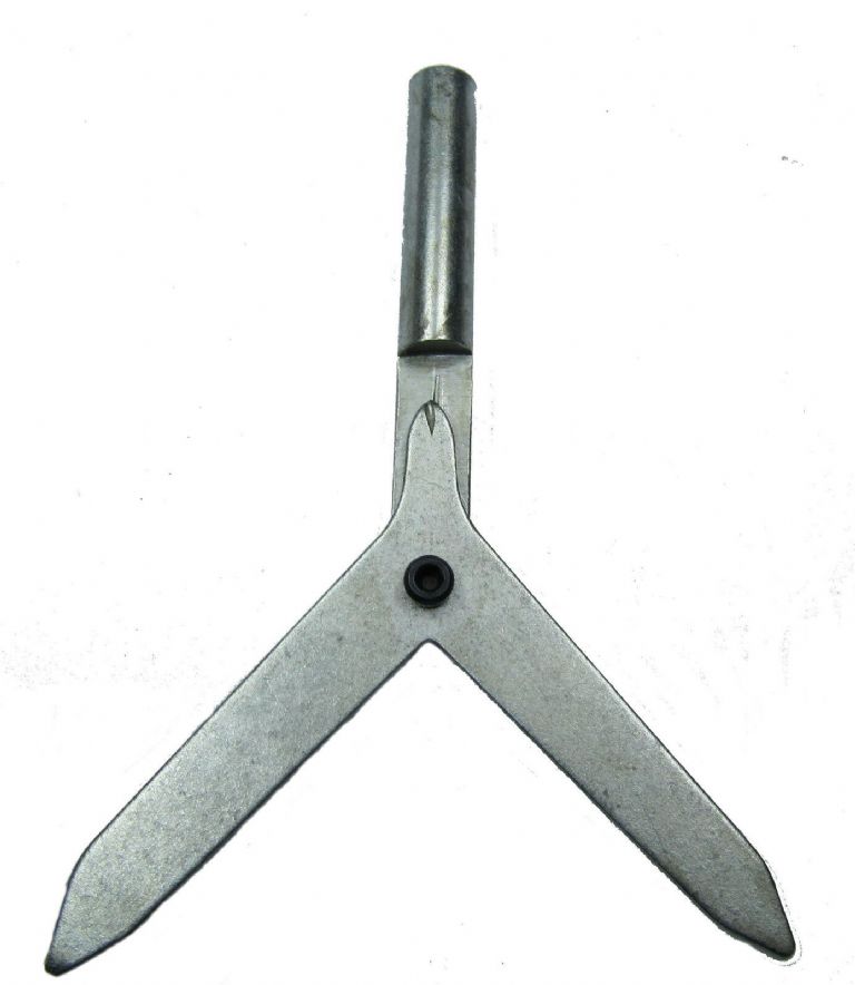

            Google "round bar centre finder" for something that fits in the chuck. It is a Y shaped tool if you look at images.

                The steel rule not a bad solution, which would probably be accurate enough in most cases. I do use that method for lathe cutters, until I can get a face cut.
                Martin, I assume you mean the image below. I think is probably the best and quickest method; notwithstanding the 4 days P&P. But Im sure the tool will be very handy in future. approx £10

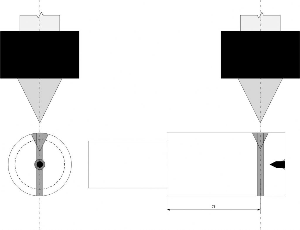

                I did design a solution after I posted the querie last nigh. See below:cf1.jpg
                Its a piece of round bar with a centre hole and through-hole down the centre. You could then use either a centre or a drill/bar in the Mill chuck to centre up. Would still need Martins solution (round bar centre finder) to make this though.
                The only constraint that I can see is the position of the centre-hole, which I think is approx 3" from my Jaws (hence the reason for spigot for holding in lathe chuck).
                Of course this need to be perfectly at 90degrees, but a slight turning of both the chuck and mill head by hand would get this pretty bob on.
                Thoughts, improvements, appreciated.
