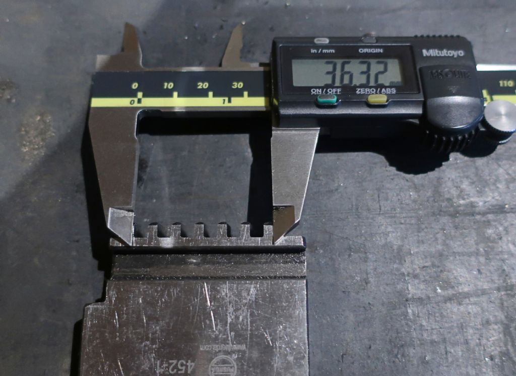

                      I'd say the Chuck is 51/8" and pitch seems to be 6mm with (3mm gap & 3mm teeth)
                      Stamp reads: 7230 if that means anything.

                        It'd be helpful to know the width and slot dimensions.. ..If it's any help, the Warco 125mm ('Fuerda' brand) chuck soft jaws are 6.1 mm pitch, 56mm long, 16mm wide and 45mm high, with an 8mm high slot.. ..the bottom of the slot is about 6.8 above the ends of teeth / top of scroll..

                          It's surprising how many people don't know what pitch means. Please measure from the FRONT of the first tooth to the FRONT of the last tooth, no.7. The chuck is likely 130mm. We need the width of the slot in the jaw and the width of the jaw. The number is a serial number and the chuck body should have it also, it has no other significance.

                            These are:
                            54mm long (not important)
                            16mm wide (same)
                            42mm high (not important)
                            bottom of slot to ends of teeth: 7mm (compared to 6.8) – do you have some that you could double check?

                                  img_2.jpgimg_1.jpgimg_8.jpgimg_7.jpgI'd say your luck is pretty good.. ..the figures vary by some fraction of a mm here an' there, but mostly to do with holding calipers in one hand and camera in the other on the floor of a harshly-lit shed..
                                  I'm too tired to work out the order & captions, so note that pitch is about 6.05, but they need to be a very free fit in the scroll, so that will be okay – they're also not the easiest things to measure, being curved.. 6.1 was from Warco's website, I got 36.32 over 6 teeth on the edges..

                                    To keep things clearer, thought I'd add this bit last.. ..they're from Warco, listed on the invoice as Soft Jaw Set SJ-11-125; they aren't listed on the website as that, so it might be best to ring them, and in any case it'd be worth checking the price, probably £thirty-something.. They are made by 'Fuerda'. .img_9.jpg

                                                  Anyway – the jaws suggested by @diogenesii above (SJ-11-125se) are the same as the product 125/130mm jaws (Item No. 9157) on the Warco site. I have them in my Chuck cost £33.70 all incl. (I found a discount code on the site to give me a couple of quid off).
