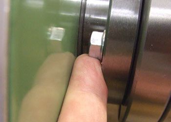

      I have a BV20 (8 1/2” x 14&rdquo Lathe that uses 3 M8 cap head socket screws to secure the chuck to the lathe flange. The holes in the flange are counterbored. I’ve just noticed that some mini lathes use Hex headed bolts instead. I obviously can’t use them on my lathe due to the counter bored holes. I’m just wondering though if I could re-drill three new holes in the flange. It then occurred to me that if I do that I could maybe fit studs to all my chucks and then secure them with nuts instead. I have to say that the present setup using cap head socket screws is a bit of a PITA as there’s so little room the manufacturers supplied a cut down hex wrench for the job. Any thoughts? If you have a mini lathe how it the chuck secured?

              You could just glue some spacers in the counterbores?, Or if you don't mind the faff and always losing them just have loose spacers.
              #554386
              Lathejack
                @lathejack
                If you would rather avoid drilling more holes in the spindle flange then I would do as Duncan suggests and machine up some spacers to match and fill the counterbores, although drilling three more holes won't cause a problem.
                I would then make them a light press fit, or glue them as suggested to keep them in place, and then use studs and nuts. If there is enough room behind the spindle flange it would be worthwhile machining a plain unthreaded portion on the ends of the studs, equal to about the length of the nut if possible and a snug fit , this lines up the nut with the stud threads and makes refitting them quicker and easier.

                        I would go with spacers, as suggested by Duncan, in the counterbores. Fit studs to the chucks and use flange nuts to save faffing with washers. Works on my lathe!

                            Some interesting ideas folks, thanks. I hadn’t thought about “filling up” the counterbored holes. It might work. The problem is there isn’t a lot of room behind the flange and you can’t see what you’re doing. Even measuring up could be difficult. If I decide to drill new holes cleaning up the back of them could be a faff. I’m really not interested in removing the spindle at the moment. laugh

                              My inclination would be to follow Duncan's advice and to go for spacers, Loctited into the counterbores.
                              This would allow all chucks to be fitted with studs.
                              The risk of dropping muts during fitting and removal can be greatly reduced (almost eliminated ) by making up a DannyM2Z "Widget".
                              An extremely simple kit of kit that holds the nuts, whilst allowing access for a spanner.

                                      The counterbore seems to be about 13mm Diameter and 7.5mm deep. The hole through the flange for the 8mm bolts is about 9mm. Clearance for digits etc is around 20mm. I think I need a drawing! laugh

                                          I have a similar chuck mounting arrangement on my lathe. I had great difficulty manipulating the standard socket head bolts, too, not to mention the fiddly cranked allen key. I replaced them with hex head bolts with a threaded collar to bring the heads to the level of the rear face of the mounting flange. All this is a round about way of agreeing with John (Journeyman), above.
                                          One thing I do to assist me, not having the benefit of three hands, is to clamp a piece of rod in the chuck itself and the tailstock chuck, bringing the ensemble up to the chuck mounting plate until the chuck engages with the register, leaving both hands free to fight the mounting bolts. Gently rotate the chuck until the holes line up and then insert the hex bolts. Start them off with your fingers and finish off with a spanner. I suspect many on here do the same.

                                                After some thought I think I’d prefer to re-drill three new holes in the flange if I can. I will test it with a new bit soon. One concern for me was bolt spacing with the flange in situ. I do however have a collet Chuck with threaded through holes so I could clamp this in place and use it as a guide with some threaded guides in the holes. I did also think to space the new holes equidistant with the old but I’m not sure there’s any advantage in this. If I can drill the flange I plan on using hi tensile socket set screws and flanged nuts. My thinking with all of this is that provided the threads are kept clean I should be able to spin the nuts on and off most of the way with tools, just resorting to a spanner for final tightening.

                                                      If you plan to mount a 4 jaw chuck at any time in the future, it may be worth having one of the new holes common to both 3 and 4 jaw fixings.
                                                      And it means one hole less to drill!i, so that the flange does not start to look like Edam cheese!
                                                      By that stage it will have 9 holes in it!, 3 counterbored and 6 new ones for the chucks.
                                                      Personally, I would turn up collars for the existing holes and drill the three extra holes for the 4 jaw chuck, fit studs to the chucks, and use nuts.
