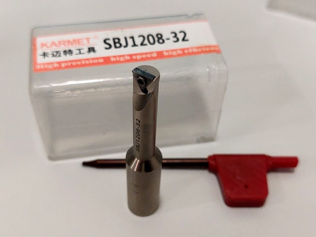

                You may be interested in this type of 12mm shank carbide insert boring bar to fit these boring heads, available in a variety of lengths. The TBGH Inserts are almost as sharp as CCGT types for aluminium/stainless.

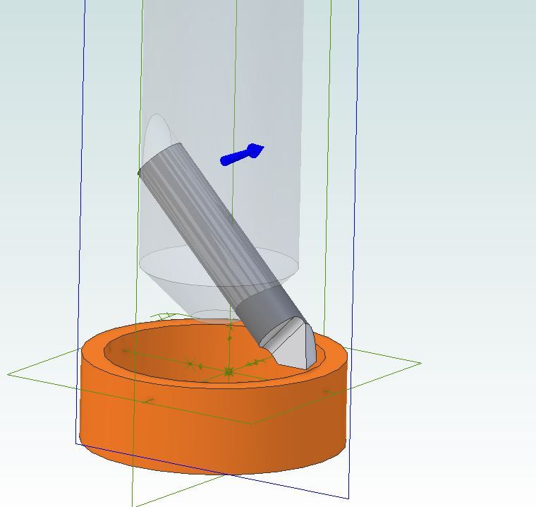

                                      The point about the grinding was his specific requirement of a 25mm starting bore, an 18mm dia. bar and a 6mm dia. toolbit.
                                      If the bar is 18mm dia. and centred as shown in the plan, the annular space is 3.5mm. The grind on the cutter shown looks to be roughly half of that, 2mm in plan. I do not know how easy that is, hence the question. Drawing it out as you have done is the way to see, and as you say, presenting the bar at 45 degrees gives more space. Maybe some dimensions on the toolbit would allow assessment of practicality.
                                      Also, if necessary, the bar does not need to be concentric with the hole. It could move to the right to give more space.

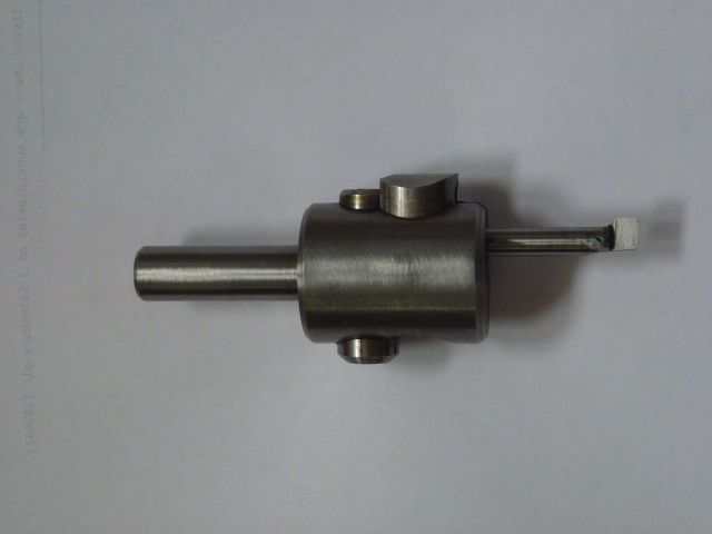

                                        Here's mine. It's intended to be held in an ER collet The boring tool is made from silver steel.Boring Head

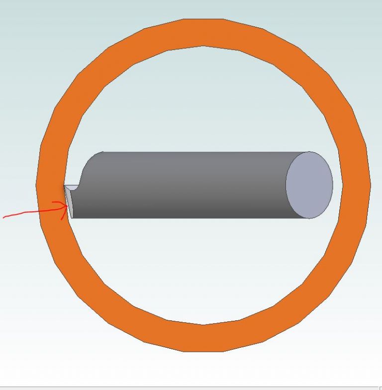

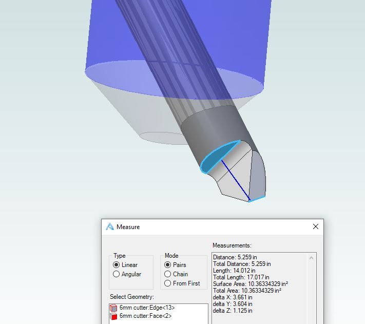

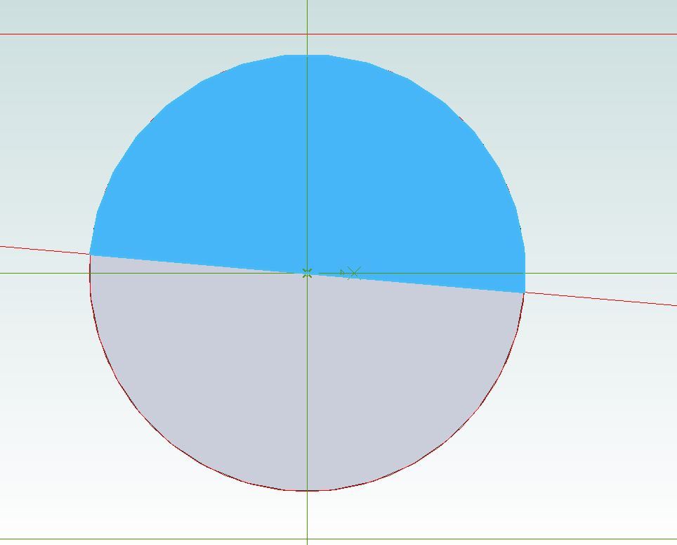

                                            Posted by DC31k on 27/08/2021 10:09:07:
                                            The dark blue line is the distance from the tip to the extent of the grinding shown in light blue and measures 5mm. As the drawing is to scale there is another 4mm or so of unground shank sticking out so it could have been ground back further without issue. I made the toolbit 32mm long, this being 1/3rd of a 100mm x 6mm dia blank toolbit with cutting allowance so you could get 3 different shape cutters from one blank

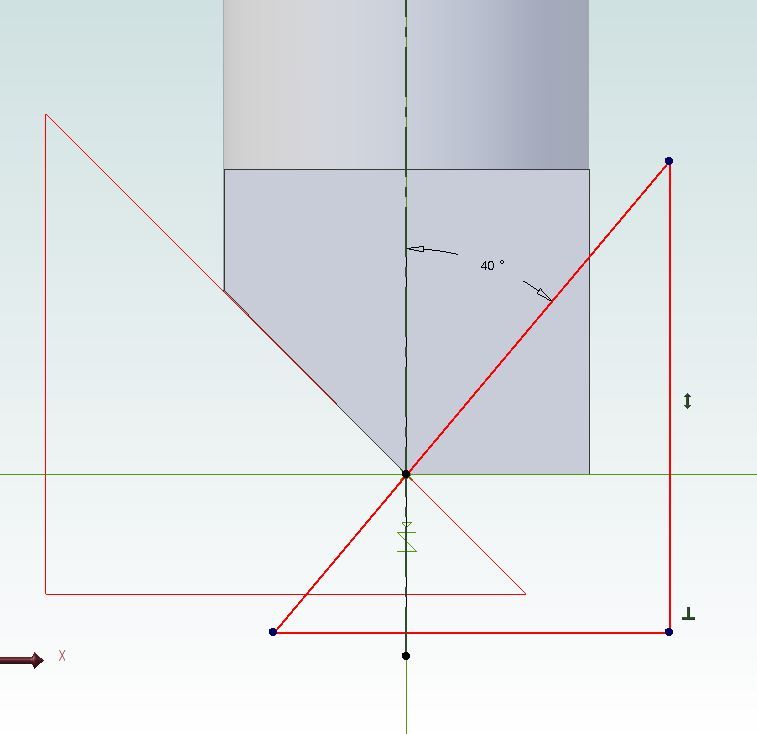

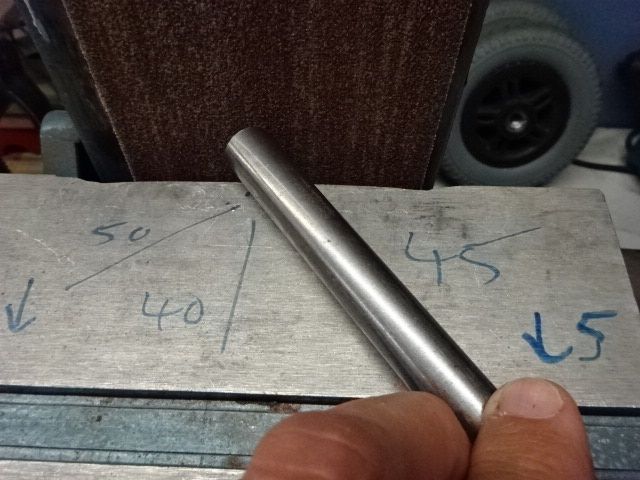

                                                Are you sitting comfortably?

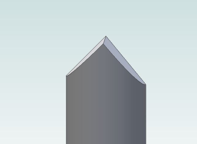

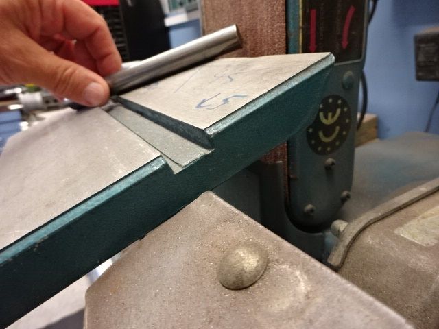

                                                If I were grinding this I would first do the grind that forms the near vertical forward face. Although this needs a slight angle it would be best done simply grinding to half diameter and then rotating the blank approx 5 degrees for the subsequent grinding. This is what it would then look like when viewed from the end, face 3 in your annotated pic is not critical nor is the fillet but that is likely to be left by your grinder.

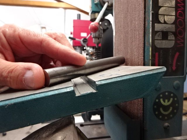

                                                Next will be the grind that forms the bottom edge of the tool, this is ground at 45degrees to the tools axis and also given 5 degrees of clearance by tilting the grinding rest downwards by that amount.

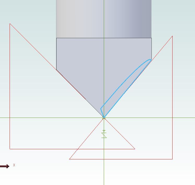

                                                The final cut is the the other near vertical face, this is ground at 40 degrees to the tool axis so that it does not rub on the cut face and with a steeper clearance of 10 degreed minimum so the back edge does not rub
                                                See angles marked on grinder table in first photo and then more tilt of th etable

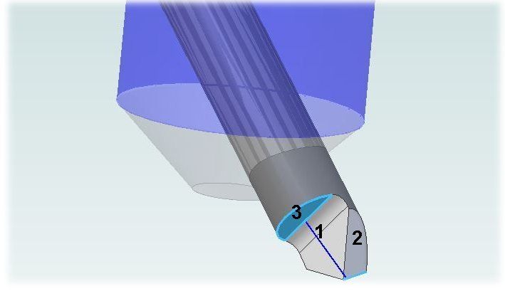

                                                Looking at the back of the tool you will have the 2nd & 3rd grind meeting at an 85degree angle and the two clearance angles will also show.

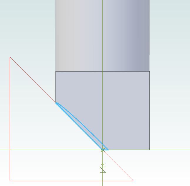

                                                As I said face 3 is not critical and could just as easily be ground like this
                                                None of the angles are set in stone so a bit either way won't hurt, the main thing to watch is that the back of the tool does not rub and you are clear where the red arrow points, as hole sizes get smaller you will need to alter the grind and make the 10deg steeper to maintain clearance or even grind a curved surface

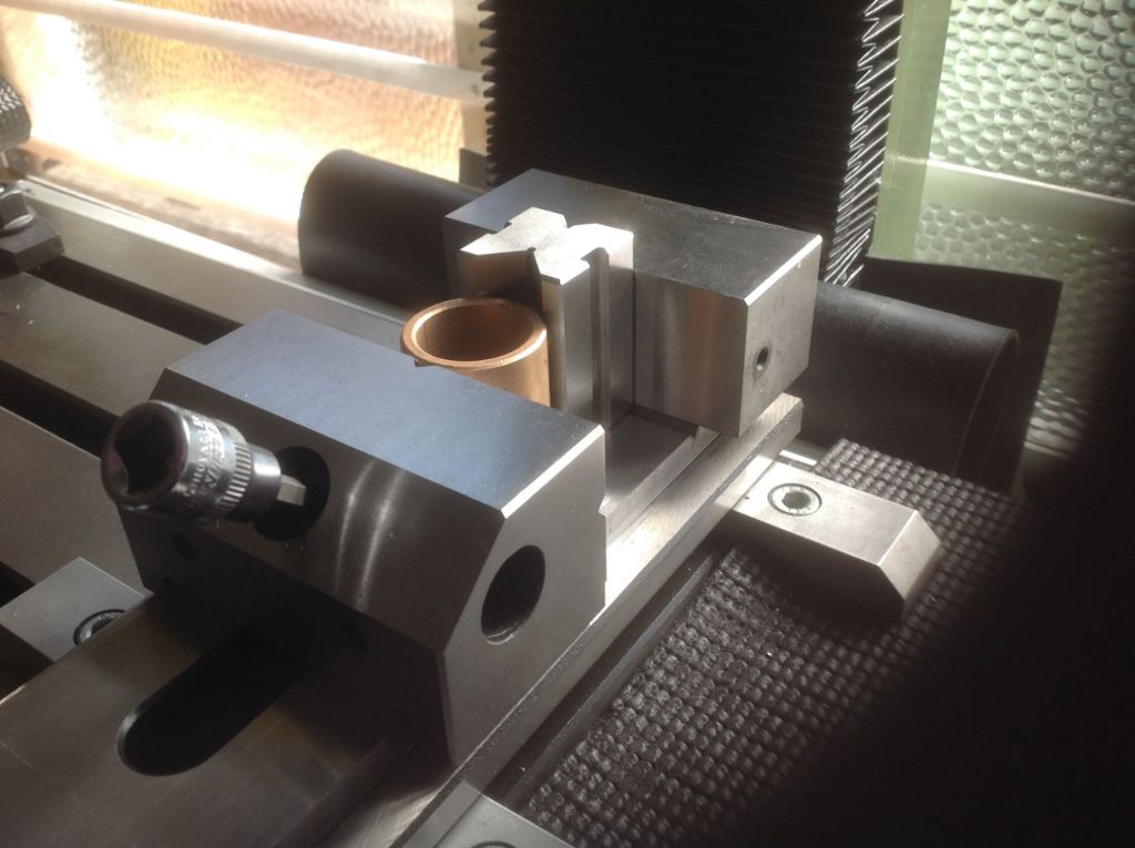

                                                  #560099
                                                    What are you intending to do about holding the Oilite bush for machining?
                                                    #560132
                                                    Bill Phinn
                                                      @billphinn90025
                                                      Like in the photo, or possibly with a vee block front and back and with the bushing raised up slightly on parallels to bring it level with the top of the vee block[s].
                                                      One concern I have is whether I can hold the bushing firmly enough without the vice jaws squeezing it out of round slightly. I intend to take very light cuts.
                                                      I'm assuming edge-finding for boring is typically done with a DTI, not a mechanical edge finder/wobbler.
