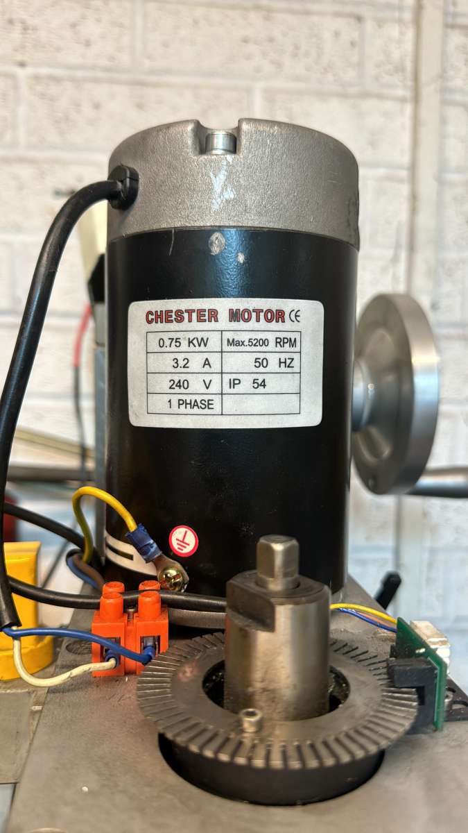

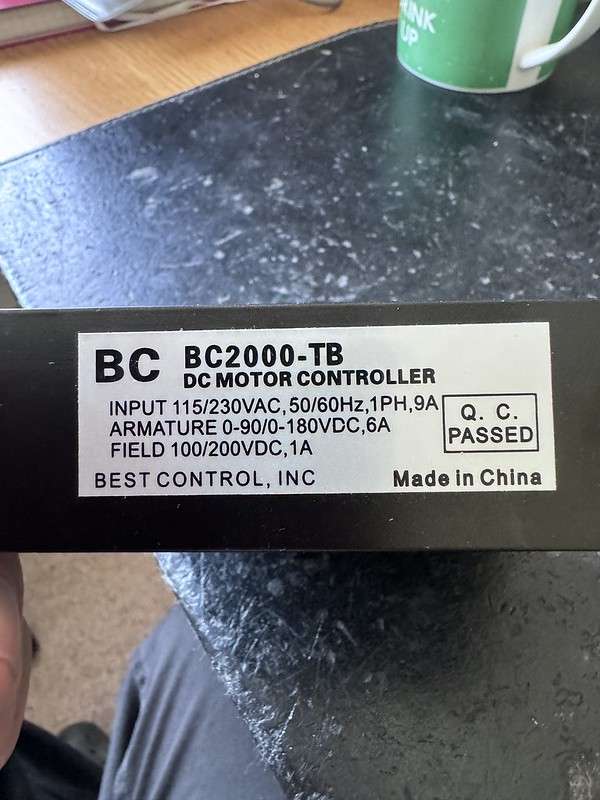

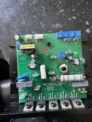

            #730136
            buzzer1955
              @buzzer1955
              here is the board.  A chap off here is currently going to take a look for me, but I suspect its the motor thats blown the board, so I need both!
              53713346618_4ed68124e8_w
              53713133456_a7052ee469_c
              53713565925_e5966310d1_k
              #730151
              Hugh Stewart-Smith 1
                @hughstewart-smith1
                You can test the motor by putting a 9v battery across the leads and if it runs then put a multi-meter across it to measure the resistance which should be between 3 – 13 ohms. If so, then the motor may not be the cause of the blown board.
                The circuit board looks quite similar to the mini lathe/mill in our machines and others.
                In case the motor is the problem you could compare dimensions with the our AMA25 750W motor on our website. It’s likely to be the same.
                You’re welcome to give a call to discuss. Wifey has just arrived in Rhodes for a 2 week holiday so I have all the time in the world to assist if I possibly can!
                Hugh
                Amadeal Ltd
