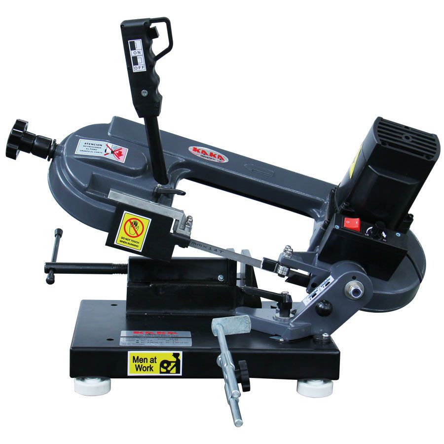

      Im in the market for a bandsaw that will let me get the most choppy chop with the least financial and spatial investment.
      Chester H80 looks like it might fit the bill. Can anyone comment on its capability? Any competing bandsaws that give it competition?

          Can't find that designation on the Chester web site. Could you post a link to make it easier to see the one you're on about?
          found it. Here:-https://shop.chesterhobbystore.com/products/h80-swivel-arm-bandsaw
          Think long and hard about whether the capacity is going to be enough for you over the next ten years or so. If it will, then get it, if it might not, then keep searching for an acceptable price on a larger saw.
          I started with a collection of hacksaws, got a good price on an Axminster 6"x4" Chinee bandsaw and now sometimes curse the 7"x12" saw for being too small. But for stuff that's only 25mm across, often use the hacksaw, just for the exercise.
          If you do go for that one (and the price does seem to be good compared with the other sizes on offer at the moment), you can improve it by doing some woodwork or metalwork and replacing the stand with a cupboard, Thus getting more use out of the space.

            I have a similar Chinese bandsaw fitted with a variable speed motor. Not sure about the Chester H80. Have not had any problems and a good investment. Note: Use bimetal blades. They cost a bit more but last longer.

              I have an H80 – for price it is fine – limit is about 100mm max dimension – there are several mods to make more convenient eg small sub vice to hold smaller items than possible with the built in vice.
              Works well for mild steel, ali, brass – not stainless steel I suspect (I use a small angle grinder in a frame for this)
              throw the stand away tho

                  Weld decent steel fillets at the bottom of the legs, drill them and add castors.
                  Best mod I ever did to mine!

                    I've got the slightly bigger version with 6" limit but you can flip a piece of plate and cut from the other side. The only problem then is that at the angle of the arm on 12" there is insufficient leverage so hang a weight from the tension knob. I recently cut a slice off a near 12" wide piece of 15mm steel plate that way. Not saying it's ideal but ya can do it.

                          My other niggle is the lack of length to the moving jaw, easily overcame with a piece of flat but more convenient if the jaw was longer almost out to the blade as per the fixed jaw.
                          Remove the totally pointless plate screwed to the fixed jaw, and screw the patterned side of it to the moveable jaw so it line sup with the fixed jaw.
                          Problem solved, no more marking of stock by that coarse diamone pattern, plus an extra 1/4" of capacity!
