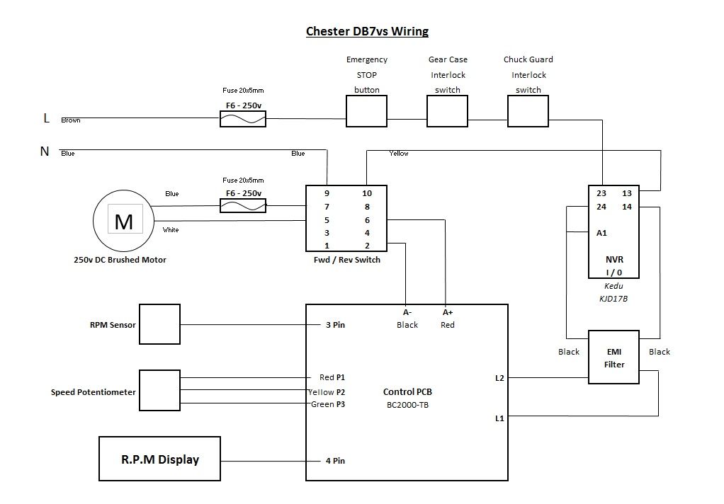

      Hi Forum,
      Strange issue with my Chester DB7, in that the NVR switch wont lock down, but if held, the lathe runs perfectly. after it's warmed up a bit, the switch stays locked.
      I thought originally that this'll be the NVR switch, so sourced another, yet the fault still exists. Coming from the NVR on the Chester, is a mains filer unit, then the control board – which is a BC2000-TB
      Has anyone experienced this fault? Has anyone replaced the BC2000TB control board with a KBIC240? It's a little different but the same spec.
      I'm going to try and ring Chester tomorrow, see what they say, but it's weird for sure.
      Cheers
      Ian

          If any of the interlocks are open or perhaps have not closed properly then the NVR will not latch as the interlocks are placed in series with the hold on coil in the NVR switch as a safety precaution. Check the chuck guard and make sure that you can hear the microswitch activate or better still check that it operates with a DMM or something that can indicate continuity. UNPLUG from the MAINS before trying any of the above.
          Hope this is useful.
          Martin

              …after the lathe has warmed up…by holding down the start. Picture below. Although the link to A1 on the switch meters ok… I'm going to remake those connections first I think.

                  Reverse switch shows 9 and 10 together as in, unswitched

                    The symptoms suggest Martin is on the right track: either the NVR is faulty, or one of the interlock switches is intermittent, perhaps right on the edge of breaking the circuit. As it works when the NVR is held down manually, I can't think of a fault after the NVR in the filter / control box that would explain that. The NVR has an internal magnet operated switch that pops out when the mains input fails; they're ignorant of what happens to the output.
                    On my lathe the interlock switch protecting the gears is unlikely to go wrong. It's a solid reliable plug/socket affair, that either works or not. Not so the switch on the chuck guard. Closing the guard rotates an axle, which, inside the control box, turns a simple lever to close a microswitch. The microswitch and lever may need to be tweaked physically to ensure reliable make/break, but when mine misbehaved it turned out a loose guard wasn't turning the axle properly. Fixed in a few minutes by removing the guard, turning the axle manually into the 'GO' position, and then refitting the guard and tightening up the screws.
                    Not looked at my other interlocks, but don't trust any of them. I'd use a multimeter to look for a trigger happy interlock switch, or make sure the mechanical side of each is properly adjusted. I wouldn't spend any time inside the lathe until I was convinced the interlocks and NVR were all 100%.

                      Many thanks chaps. I've just metered the Live line from the plug, to 23 on the NVR (via all the interlocks) and that gives me a good reading of 00.2 ohm. Operating each switch returns to the same value. Interesting that the NVR doesnt care whats passed it, so that rules out the board and filter. It's got to be either a dodgy NVR (and replacement) or iffy supply then.

                        I can, on my DB7, replicate the fault that you described above. With the chuck guard 'open' the NVR will not latch but if I hold the NVR down then the lathe will work. Your schematic shows the interlock in series with the mains feed to the NVR if this was the case then it would not be possible, certainly on my incarnation of the DB7, get the lathe to run by holding the NVR on with an interlock open.
                        The safety interlocks are normally wired in series with the 'Hold On' coil of the NVR and not as part of the mains power feed circuit to prevent overloading the interlock circuits and potentially leaving them live when the NVR has reset to OFF, a certain washing machine manufacturer put the full mains load through their interlock system and the result was a potential fire hazard.
                        The connections to the NVR in your schematic show terminals A1 and 14 to be linked, I would expect these terminals to be connected to any safety interlock circuits. It might be worth checking again how the wiring your machine is configured with regard to this. If I recall correctly the reversing switch does interrupt the mains feed circuit and is intended to stop the lathe from being switched directly from forward to reverse instantly.

                          If you activate the chuck guard interlock by having the guard in the up position and then press and hold the NVR switch and the lathe starts then the interlocks are not in series with the mains feed to the NVR.

                            Hi Martin, this is definitely the way mine is wired… Live feed via all 3 interlocks, then to the switch. with any of the interlocks open, there is absolutely no power available, held or otherwise.Interesting then, because it sounds like they are wired differently, and if so… why? I know someone has been in the NVR before, as it's been fudged, so I wonder if they've done something else with the wiring. (it is all brown coloured though and heat shrunk, so maybe not) For some reason, the main quick blow fuse has gone…probably having all the wires out while testing, so that's the first bit now. I wonder if It's worth re-wiring while it's all out? I might drop Chester a mail to see if they have the wiring diagram.

                              Had another look at your wiring diagram and it looks as if the 'Hold On' coil has been wired incorrectly. Your diagram shows contact A1 wired to contact 14 and therefore the hold in coil will have no voltage across it as it is effectively connecting mains neutral IN to mains neutral OUT across the hold in coil. This assumes mains neutral is applied to contact 13 and mains live to contact 24 that said connecting the mains the other way round will make no difference to the operation of the NVR. If you move the link so that A1 is connected to terminal 24 then it should function as intended as the mains will applied across the hold in coil when the switch is active/on.

                                Always worth a double check, so thank you. I did just re-check the diagram on the side of the switch… It's a KJD 17B
                                The diagram on the side of the switch does show a connection between 14, and A1. If you do a quick google image search for the switch, you can see the diagram. (Although there are a few) I'm sure that 24 to A1 you give exactly as you say. Bear in mind also, that this did work and has gotten worse. My Live comes in on 23, and out on 24, N in on 13 and out on 14.
                                I have spoken to Chester also, and Mark over there sent me a diagram, but unfortunately, it's nothing like what I have and shows a 400v brushless motor (I think – 4 cores), BUT, he did say I could send it up… they'll collect for £35.
                                I'm absolutely convinced the interlocks are OK, but this evening I'm going to wire a light bulb up to the switch, and have a dabble. It's a shame I have nothing on it now though. Has the main board failed? I have no idea now. I'd like to see the chuck and gear case interlock on the A1 link, and the emergency stop switch on the Live feed. I'll see what I can find out tonight though. Annoyed, but I've made my beginner mistakes on this lathe, taking far deeper cuts than I should have, with chatter, and stalls…. so my thoughts are check all I can, then let Chester replace what they find. Take the hit on the cost. It's a great little lathe that owes me nothing

                                  Going back to your first post you said that if the NVR was physically held in then the motor would run and that the fault was that the switch was not latching. Is this the case still? If it is and the motor responds to the speed control then there is nothing wrong with the drive electronics or the motor.
                                  If the switch has the A1 contact then to activate the latching mechanism this must be taken either directly or via normally closed interlocks to contact 24. The other version of the KJD 17 NVR doesn't have the A1 contact and the coil is internally wired between contacts 14 and 24. In both cases the mains live and neutral can be connected either way round to contacts 13 and 23 without affecting the function of the switch or latching operation.

                                    Martin, bang on! Somewhere along the line, I've got mixed up… what's thrown me off trail totally is the new switch is DUFF!
                                    Wired a plug up, and a table lamp to the old switch…. it was occasionally latching as before, put the new one on… not even the slightest hint of a latch. Nothing. Metered the lathe out to make sure nothing was adrift, old switch back in, lathe turns on by holding the on side.
                                    So, I'll get back in touch with whee I bought the switch from and get a replacement.
