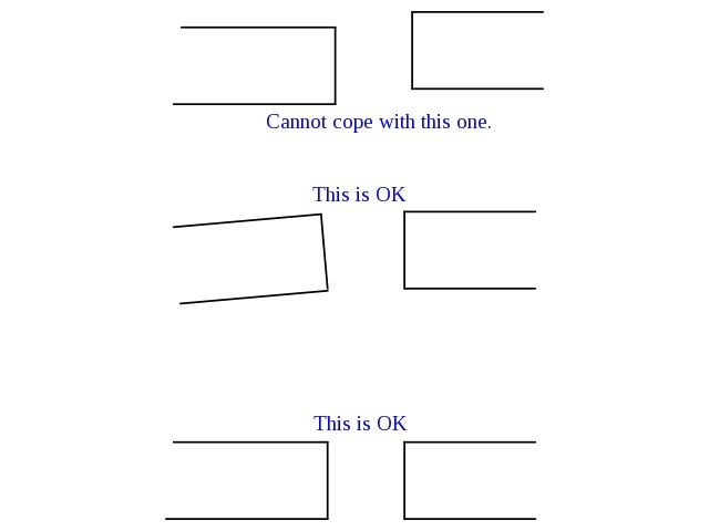

                    Incidentally the plastic coupling in the picture won't allow for any offset between shafts not in line.

                              John Baron, yes it will allow shaft misalignment, the flexible metal connections deal with it.

                                  Hi Geoff,
                                  I don't think that I was very clear in my post when I said
                                  [quote] won't allow for any offset between shafts not in line. [/quote]
                                  That type of coupling copes well for shafts that are at a small angle to each other, the shafts still have to be co-axial, ie on the same centers at the ends.
                                  NOTE: How do you put pictures into posts ?

                                        Hi Guys,
                                        This is what I meant. I hope that it makes sense now.
                                        PS:
                                        What a horrible procedure just to insert a picture.

                                            John Baron,
                                            It's a rather extravagant solution [and probably best avoided] but:
                                            Two couplings and a short rod should accommodate a modest mis-alignment of the type shown in your first example.

                                              Michael I agree ! This is where "Oldham" couplings score. They can tolerate quite a large axial displacement but are very limited with angular alignment.
