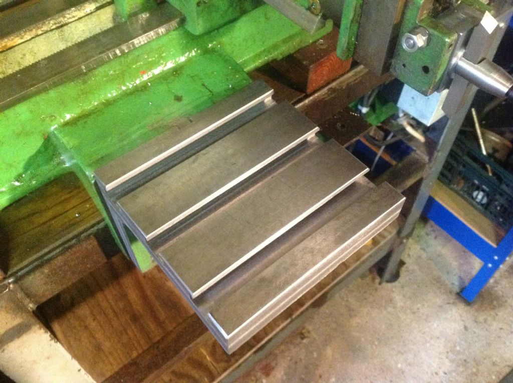

              I have a 16mmØ one from Glanze. Had it a while but only used it infrequently. However, over the last few days I've used it to true up the edges of the table of my Perfecto shaper and very good at it, it was. Using light cuts of between 0.5 and 1.0mm, it gave a perfectly adequate finish on the cast iron.
              Thats better!
              There's no sign of wear on either cutting edge.  At that price, I'd buy one for the inserts alone.
