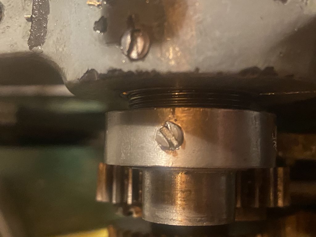

      Hi all

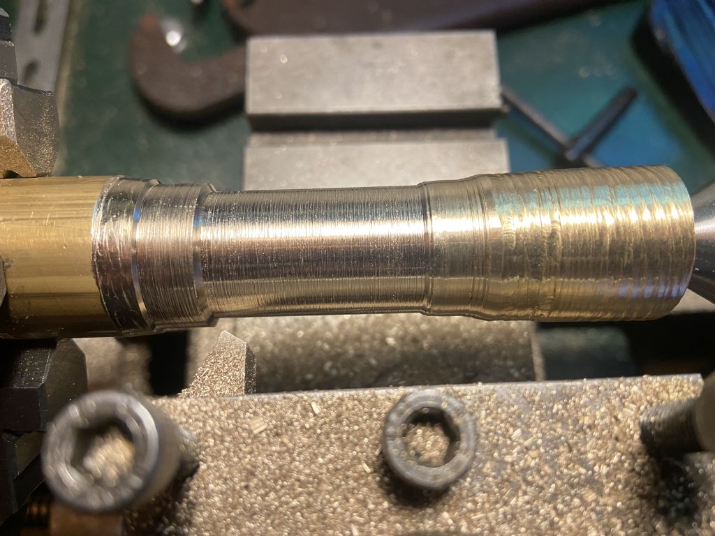

      Warning – over enthusiastic novice alert!
      Ever since I got my lathe a couple of months ago, it has had a finish issue. I presumed that it was my lack of experience, and I tried lots of cutting bits, different speeds and feeds, modifying the cutting point on lathe cutting bit et cetera. But nothing really made any difference. When I got the lathe, it was bolted to a piece of plywood, so I presumed that vibration was the issue, and I got hold of a proper stand, beefed it up with a piece of 6 mm steel plate as a table, and installed the lathe on it.
      I then went through the process of adjusting all of the gibs, aligning everything, measuring the different run out, aligning the tailstock et cetera.
      Same problem, worse in fact. See pic.
      That was supported by the tailstock.

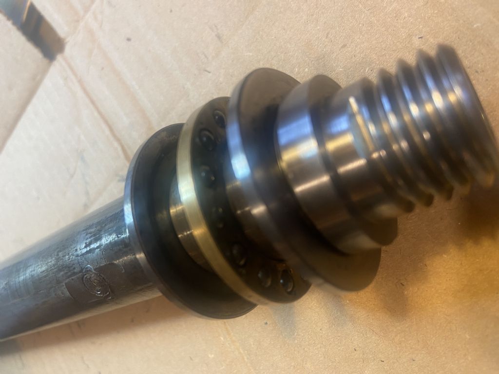

      I had it to bits to change the V-belt, so I’m now familiar with the main spindle and the associated parts. Once the main spindle was reinstalled, there is no perceptible lateral movement, and the dial indicator does not measure any runout. However, I did discover that there is about 0.5 mm of longitudinal play. It seemed to me that that could easily be the culprit, and should be resolved anyway. The funny thing was, when I did some facing cuts, there did not seem to be any finish problem.
      The race bearing (?) all seems fine. The bearing that the spindle sits in are lined with a brass sleeve, with a hole for oil and an indent for a grub screw to stop them moving about, and then obviously a bolt to set the overall tension. When running, I’ve managed to adjust it so that’s the brass sleeves do not rotate with the spindle, and the overall temperature of the bearing area is “slightly warm“ after running for 10 minutes or so.

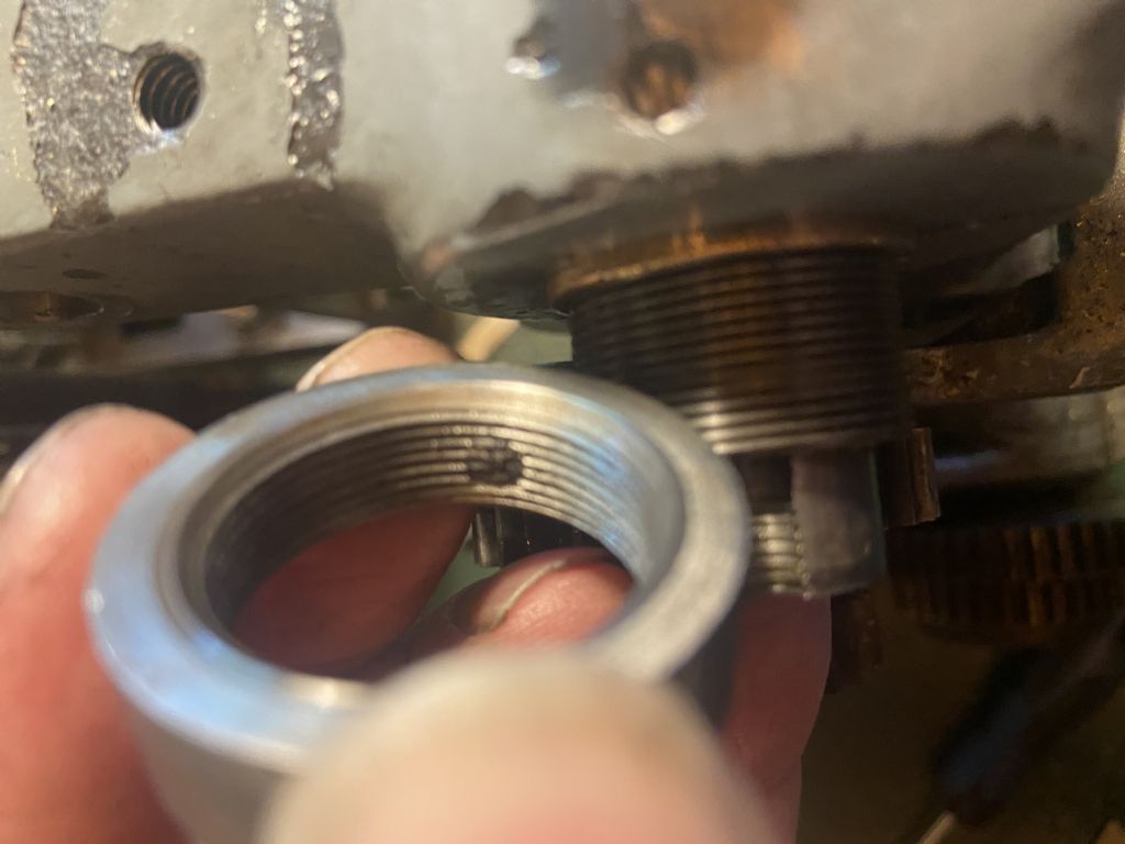

      on the far end of the spindle, there is is thread and a collar which screws onto it. This seems to be the way the longitudinal play is controlled. It is secured by a grub screw (which doesn’t seem to go all the way through ?!). But if I screw it up tight enough to eliminate longitudinal play, the spindle will not turn.
      And it doesn’t look as though that collar is designed to run against the face of the second bearing (which is painted). So I’m not really sure how to secure the longitudinal travel of the spindle correctly.
      questions…
      Am I barking up roughly the right tree? Or is it like to be a different problem?
      Am I doing this correctly?
      How to fix the longitudinal travel issue?

          There was no end-float while facing, hence the better finish. End-float should be very close to zero, if not zero.
            It looks like there is a thrust bearing assembly missing !
            You mention a painted surface … could that possibly have been a ‘touch-up’ paint job ?

              I don’t think so. I think it only has a thrust bearing (if that’s the race bearing parts) at the chuck end. The gears end just has the brass sleeve. I’ve watched some YouTube videos of others refurbing the headstock of this lathe (Zyto) and it is the same as mine. And I am 99% sure the paint is original…..

                End float is the usual suspect. You don't say what type the lathe is , if you don't know post a pic of the entire lathe. Some small English lathes have a bronze washer as a thrust bearing others have a needle roller. If it's the washer type a conversion to needle roller is often an easy fix and worth doing.

                  If you are cutting longitudinally towards the head stock, then I don't see there being any end float either.
                  Is the spiral pattern a 'spring cut' effect whilst winding back the tool?

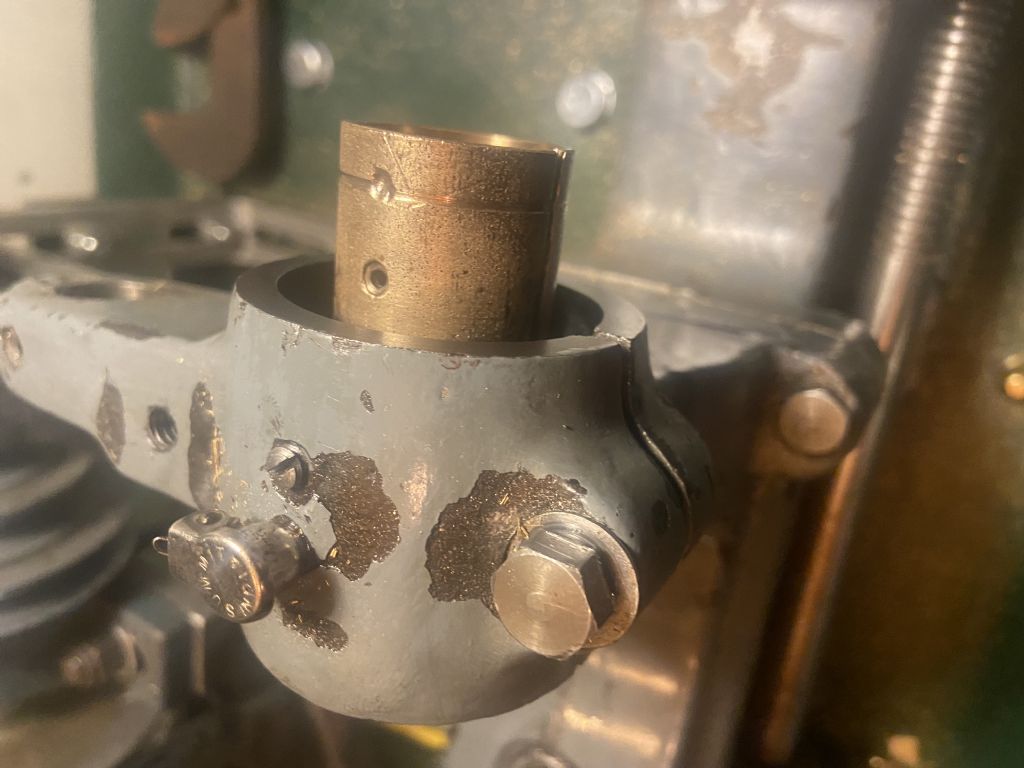

                          I rebuilt a machine similar to yours and when i adjusted the collar you show a much more experienced friend instructed me to put a 0.001” feeler gauge between the cast face and the collar face then tighten the locking screw. This allows the spindle to run free but with minimum end float.
                          Work just fine for me.

                              With a zero top rake HSS tool you should get a fizzing noise and a shower of tiny chips when cutting. Some brasses will dig in worse than others especially if there's a lot of backlash available to snatch the tool in.
                              #564452
                              Steve355
                                @steve355
                                Posted by Dave Halford on 27/09/2021 13:02:01:
                                That’s exactly what I get, and they go everywhere.

                                          Posted by Daggers on 27/09/2021 12:37:48:
                                          Good luck.
                                          That’s really interesting. Looking at mine closely, it isn’t quite like that. The bronze or brass “sleeve” in the bearing is actually slightly wider than the bearing and so protrudes by about 1mm on both sides. The edge of the “collar” is actually chamfered, so it doesn’t ever actually contact the cast iron, if the sleeve is secured properly by the grub screw.
                                          see pics
                                          I wonder why this is….. is it different to yours?

                                              I think the trouble with machines of this age is that they have had many modifications over the years. Mine had a number of mods so its possible that he headstock is not as original, but it seemed to work fine.
                                              Just watched a Zyto rebuild where he rebuilds the headstock, looks like he tightens the locking ring a gentle finger tight then looks the grub screw.

                                                #564495
                                                  Posted by Steve355 on 27/09/2021 15:37:56:
                                                  Good luck.
                                                  I’m back angel
                                                  That new picture makes much more sense than the one that I was commenting upon earlier
                                                  … You actually have something appropriate against which to adjust the collar
                                                  … Go for it !!

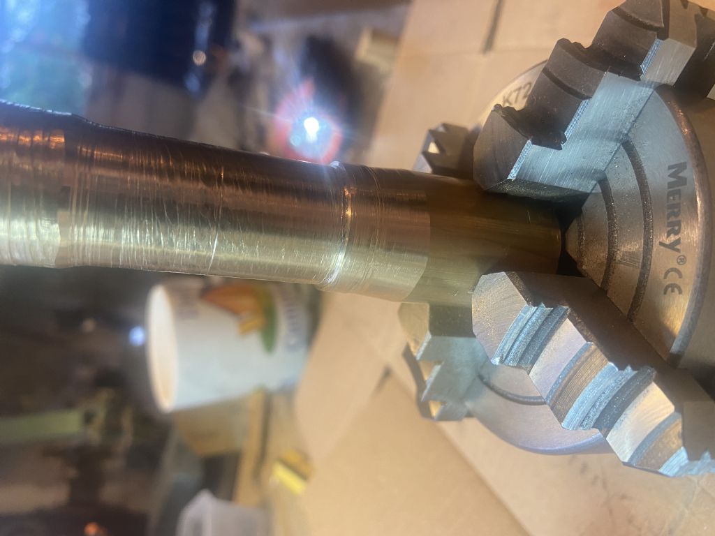

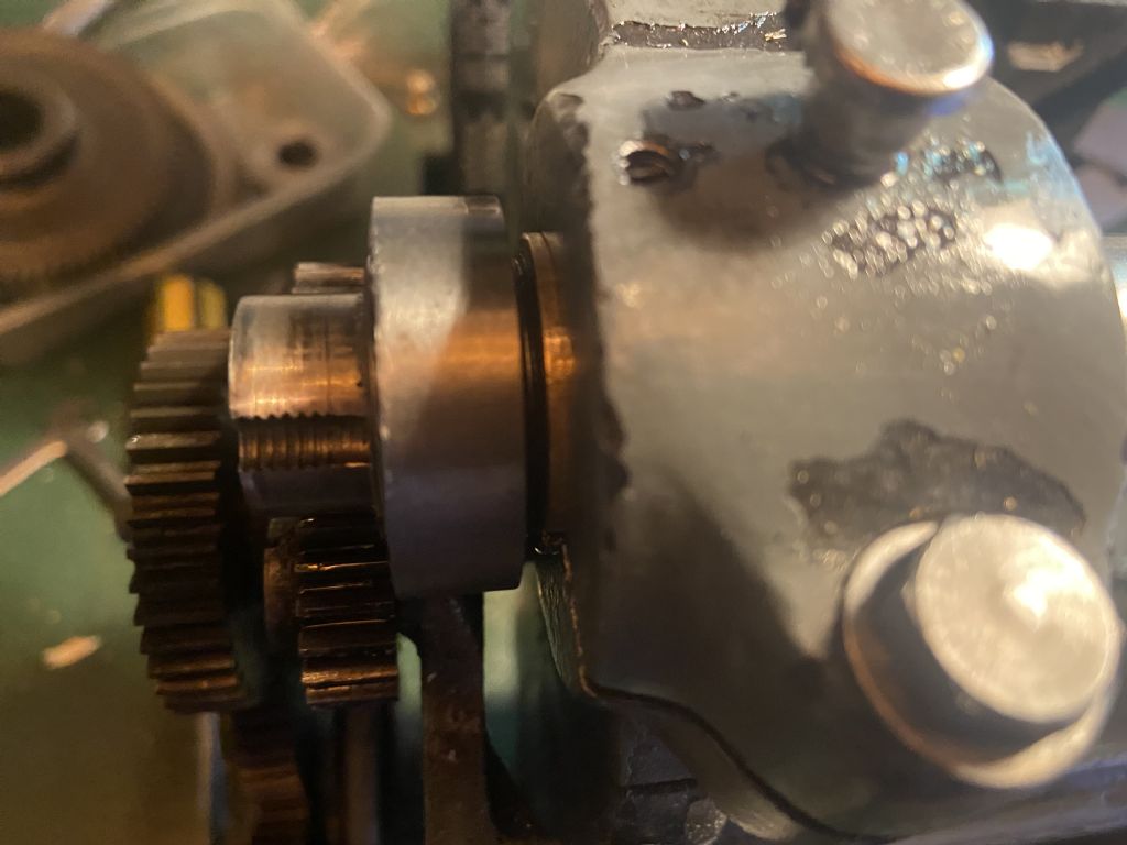

                                                    Ok, I reassembled it all and put a little grease on the collar thing, tightened it and now there is no discernible longitudinal or lateral movement.
                                                    I made another test cut, see below, the middle section, and it’s way better, still bad, but consistently bad rather than having diagonal lines and random scratches all over it.

                                                      I think your tool may have too much of a point and/or your feed rate is way too fast. You're basically creating a screw thread. Have a look at this video by Joe Piecynski about surface finish.
