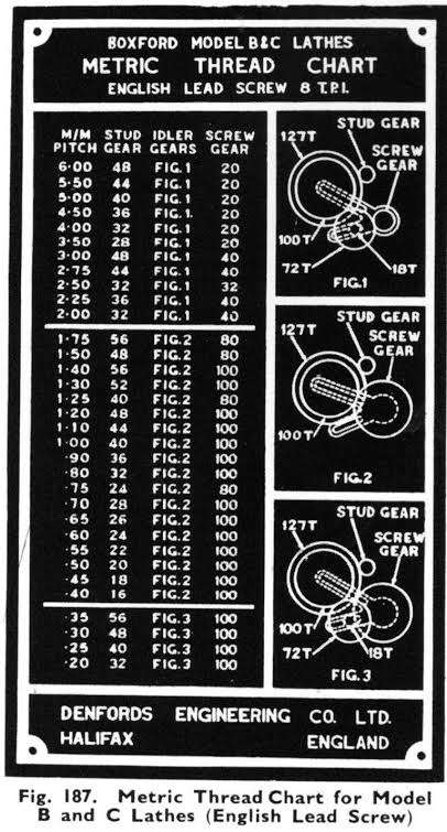

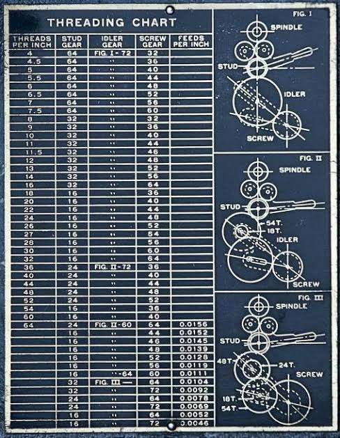

                                                  Fancy computer programs and ChatGP to the contrary,  Boxford use such 2 and 4 tooth increment counts. See chart below. Their imperial charts also use the same 2 and 4 tooth steps. Many many other old lathes used similar sets based on 2 an 4 tooth steps rather than Myford’s 5 tooth steps.
                                                  Perhaps twos and fours were the American way and crossed the pond with the Southbend from which the Boxford was copied?
                                                  images-6
                                                  #795385
                                                  halfnut
                                                    @halfnut
                                                    images-8images-7
