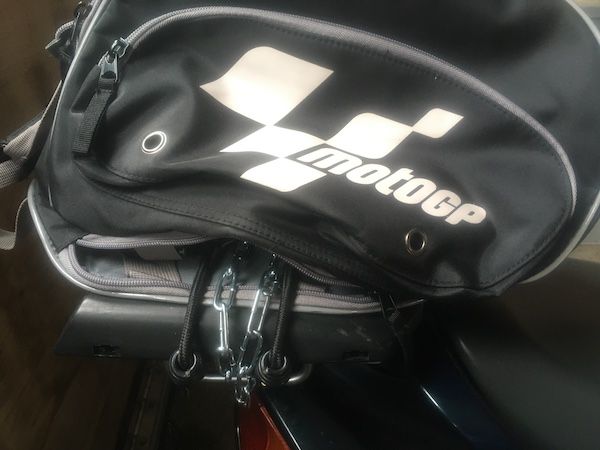

                                      My application requires the chain to go make a 180° turn round a pair of relatively thin rods, perhaps 3/8" diameter, and four fairly sharp 90° bends. The 180° turns need full link to link flexibility and the 90° bend radius is probably too sharp for a chain in a thick walled tube to follow well. Only a braided or woven protector can properly follow the 180° bends. The thin silicon skin on the woven glass fibre braids might stretch enough to follow. Or it might not. Something I'd need to try.
                                      A tightly woven braid will follow a sharp bend so long as the outside isn't sufficiently tensioned so as to open the braid all the way round. The Gorilla sleeve is tightly braided and, if a little oversize, ought not stretch enough when run round the outside of the chain curve to separate at the contact points.
                                      We shall see.
                                      A picture being worth a thousand words this is the application :-
                                      Helmet bag on a Krauser K2 top plate fitted to my Yamaha GTS. Plenty of space in the compartment under the bag to hold the lock but the chain needs to follow the bends quite closely so as not to rattle uncontrollably. It cannot of course be made tight enough to hold the bag.
                                      Lockable closure is already sorted.
                                      Clive

                                              When it comes to a suitable size for the braided sleeve the short answer is "I dunno". Had some preliminary thoughts which I will look over tomorrow then will order a couple of sizes to try.
                                              Compared to the inconvenience of carrying the helmet all the time when I park up, or having light fingered laddie lift £400+ worth of head gear, if I just rely on the aero elastics wasting a few £ on unused sizes of sleeve is trivial. Usually such stock comes in handy in the future anyway. I'm tired of running round with big panniers all the time just so I can park my hat.
                                              Clive
