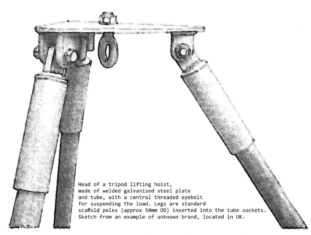

Here is a sketch of the scaffold-pole tripod head that appeared in a second-hand advert, mentioned above.
That's not a structure, it's a mechanism. Even with the bottoms of the legs tied together it can all move.
Wouldn't that only be if the lugs holding the tube sockets bent across the plane of action? As in, two of the lug-pairs would have to bend as the third leg moved over the centre? Or am I not visualising that right?

the gap between the vertical lugs looks a lot wider than the blade on the end of the upright, and there will be clearance on the pin, so it will wobble until some clearance somewhere is taken up.

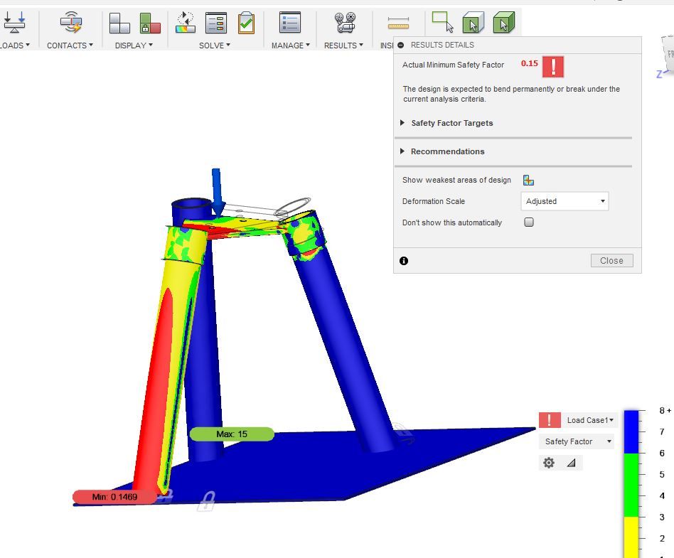

I'm recreating Stan's design in Fusion 360 to see if I can get a FEM analysis to work. It's challenging my Fusion skills! However, the attempt highlighted a useful feature of Stan's design. Welding the adaptor plate as he describes simplifies construction.
Good point, Richard. That greater safety factor does bring the theory much more in line with the practice. Ta.
Dave, I hope you're going to give us screen shots of that FEM analysis! Love to see it – would be very impressive.
Well, here it is. I'm sorry to say there are multiple faults with my model, so don't take it seriously:
I'll have to have another go at modelling the design; I've got some dimensions wrong, plus the way I modelled the angled tripod legs is suspect. At least one of them is at the wrong angle.
The analysis shows a 10000N (approx 1 ton) load on a badly compromised structure, which models most of the load on one undersized leg. In addition, my virtual version is weaker than Stan's actual design. Despite the mistakes, the tripod doesn't actually fail, though it's close!
I wish I'd started with a simpler example. However, provided you define the model correctly, it's straightforward to specify materials, and apply loads to the structure. Running the analysis is easy. Making sure it's set up correctly is more challenging. The colour coding and numeric output of results seems plain enough – risky bits go red! In more skilled hands, I'm sure the tripod could be modelled properly. As my mistakes all weaken the model apart from leg length, the real thing should be stronger.
