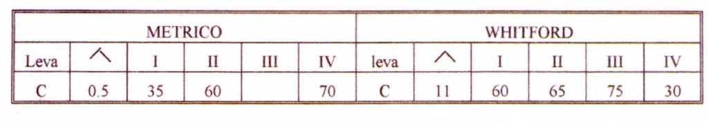

                Got it. There is some error for example
                11tpi would be 2.3091mm pitch but the lathe cuts 2.3077mm
                14tpi would be 1.8143mm pitch but lathe cuts 1.8132mm
                18tpi would be 1.4111mm pitch but lathe cuts1.4286mm
                As there is no change of the driver or on the gearbox then they are just using the nearest possible gear train from the provided change gears which do not seem to include 63 or 127.
                Also shows that people could easily fall into the trap of thinking that they are paying for a gearbox full of pitches when infact they will have to be swapping change gears for almost any change of metric, Whitford (as they call it) and Mod. Even then the range of pitches is quite low compared to similar size far eastern machines

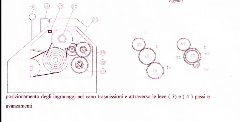

                  Jason's calculations show errors less than a thou.
                  I suspect that '11' setting for the gearbox on the Whitworth chart is part of the solution
                  The manual does pose the problem of being in Italian, but the change gear setup itself seems straightforward enough:

                      Neil, the "11 setting" is the desired pitch eg 11tpi and not a setting, the manual is just a reprint of the top line of the chart from the front of the machine.
                      The gearbox setting is the first Leva (lever) column and that can be moved to position D changing 0.5mm pitch to 1.0mm pitch and 11tpi to 22tpi so a simple 2:1 gearbox
                      The diagram of the gears is what was throwing me last night as it looks to show the 60 driving the 75 and the 65 driving the 30. but it should be 60 driving 65 and 75 driving 30 giving 0.923 and 2.5 multiply those together to get pitch of 2.3077. On the metric side a simple 60T idler so 35T driving 70T = 0.5. Note both these pitches use the gearbox in exactly the same "C" position so there is nothing in the box to give better imperial ratios

                            JasonB – thank you for working those out for the various pitches. I was reading the drawing the same, but it seemed really very odd to me. 65 / 75 is a poor translation ratio to use, I would think.

                              You need to look at the whole gear train for each pitch not just two of the 4 gears being used in a particular train.
                              Comparing the result for 11tpi the gear train gives to the true pitch I would say its a very good result, 0.0014mm per turn or 0.06% error is negligable unless you are making long screws

                                  Okay, I follow your math now, at least. You're calculating (60/65) x (75/30). You expressed this in an earlier post as "0.923 and 2.5." I believed I understood compound gear train calculations, but you've proven me ignorant. Having just skimmed Screwcutting in the Lathe by Cleeve and Machine Tool Operation by Burghart for review, I'm clearly lost.
                                  embarrassed
                                  Some quality time with the books are needed for me on this one.
                                  #234366
                                    I divide the driver by the driven so
                                    60 divided by 65 = 0.923
                                    75 divided by 30 = 2.5
                                    Then multipy these two together
                                    0.923 x 2.5 = 2.3077
                                    Or as you have written (60/65) x (75/30) = (0.923) x (2.5) = 2.3077
                                    Luckily in this case that equals the pitch, in most cases the driver on the spindle and the lead screw pitch come into the equasion too.
