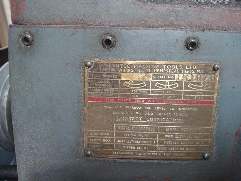

                                              Sorry to disagree, but my Mk2 Automill has a brass plate riveted to the side of the mast showing the speeds appropriate to a 2 pole motor. If it's an after market bodge-on its very convincing. From what I remember of the Centec brochure courtesy of Tony Griffiths the 2 pole motor was a factory option. I get the impression Centec would have made you pretty much anything you wanted to suit your production line. The machine (when I bought it) was immersed in aluminium swarf – I don't know its history but I assume it was bought for a specific purpose. I've robbed the motor off it and popped it on my Myford S7 with a VSD as an experiment – documented elsewhere on this forum – but mainly because the bottom speed (with a 2 pole motor) was too high for a horizontal mill for what I want to do, which is cut gears in steel.
                                              So I'm pretty sure the 2800 rpm motor version was original ex factory . I'll upload a pic' of the gearbox plate in the morning, but I can't get to it just now.

                                              #319998
                                              Simon Williams 3
                                                @simonwilliams3
                                                Herewith a pic' of the gearbox plate on my Mk2 Auto mill, as promised:
                                                Rgds to all
                                                Simon

                                                Dave Halford
                                                  @davehalford22513
                                                  And suddenly I agree. blush
                                                  Though it doesn't mean the gearbox is the same as the slow speed versionsmiley
