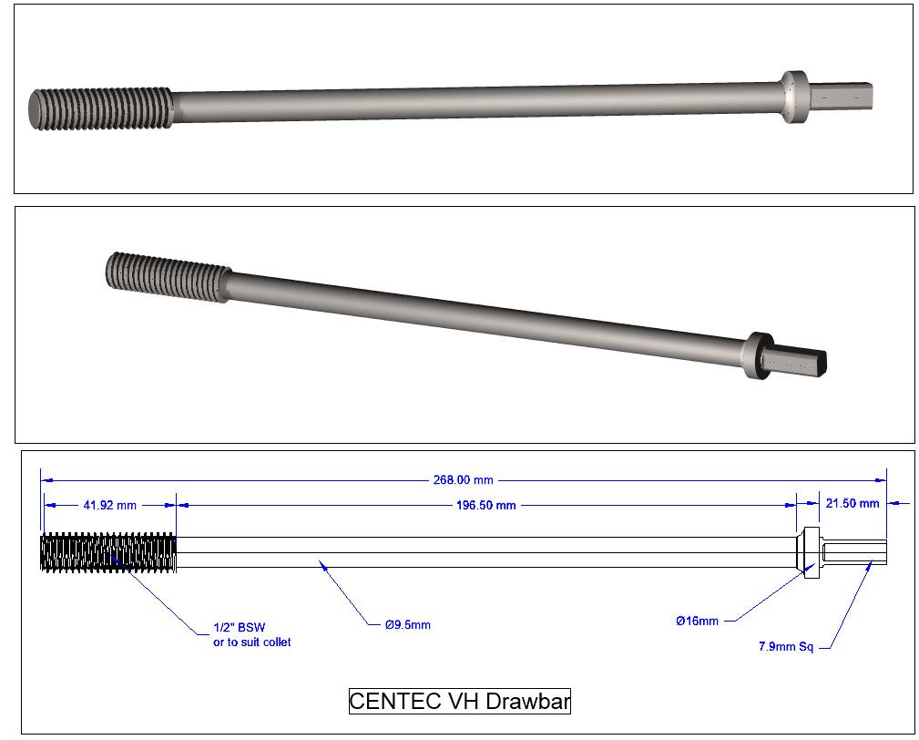

                the vertical head is missing its drawbar, could anyone please help with pics/ dimensions of theirs.

                #278828
                Gary Wooding
                  @garywooding25363
                  Here's mine
                  #278835
                  jason evans
                    @jasonevans10206
                    superb gary, exactly what I'm after. many thanks
                    jay
                    #278876
                    duncan webster 1
                      @duncanwebster1
                      Mine's 3/8" BSW. Most 2 morse tooling has 3/8"BSW or M10. There has been correspondence here or somewhere else about it being impossible to get M10 down the central hole, so I'd just check if I were you

                        Just checked – I have *five* drawbars for my 2B. Two of them are M10, differing lengths, some came with the mill, some were made by yours truly.
                        Different M2 tooling will have different requirements, as will the lengths for the horizontal and vertical spindle.
                        The ER25 holder (M10 thread) has been in the vertical head for about 5 years; I do have some small drill chucks on stub (straight) 1/2" shafts that do fit in the ER25 collets, so there's no need to take the ER25 collet holder off the machine.
                        The M10 drawbars were made with M10 threaded rod ends, drilled, (possibly loctited) and certainly pinned on to some round steel shafting, with another bit of steel hex (1/2"??) at the top – drilled, (loctited?) and pinned. There are washers under the steel hex.
                        I've made drawbars for my CNC milling machines, same method, except one of the mills, I used a hex head cap screw loctited in place for the top, as getting a spanner on it would have been difficult.
                        I'm sure the purists would scowl at the methods, but, no issues, and making them simply/quickly allows more time for model building… (so I should log off and get to the workshop!)
