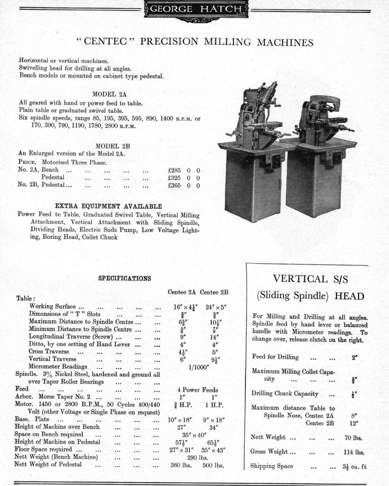

                          #228589
                          Nicholas Farr
                            @nicholasfarr14254
                            Hi Putney man and Hugh Allen, the scan below may give you a good idea.
                            Regards Nick.

                            #228596
                            Nicholas Farr
                              @nicholasfarr14254
                              Posted by Michael Gilligan on 08/07/2014 15:29:13:
                              Not sure if it's enough, but there is a useful photo of one here
                              To a first approximation, I reckon you could estimate the size by scaling from the known dimensions.
                              Hi Michael, that one is an Automil, which is a little different **LINK**
                              Regards Nick.

                                      Thanks very much Nick and John. Very helpful responses. They tell me that a) I can get it downstairs and b) with rubber feet I should have about 7" headroom, so swivelling the head will make drawbar removal possible. I was thinkin g of a 2a with a riser block and swivel table but I think the small table (16 inches) and the 9" travel might be too much of a limitation. May I ask you if you think that the asking price of 2K is too much? Very clean for its age, not much wear on the original paint, clean table and everything works,

                                        #228703
                                        Nicholas Farr
                                          @nicholasfarr14254
                                          Hi Hugh, I believe these machines are quite popular, but as for value I don't know and as John has said, you can really only decide for yourself. Maybe someone else who has bought one could give you some idea.
                                          The prices in the advert are from 1963 to give you some sort of idea.
                                          Regards Nick.
