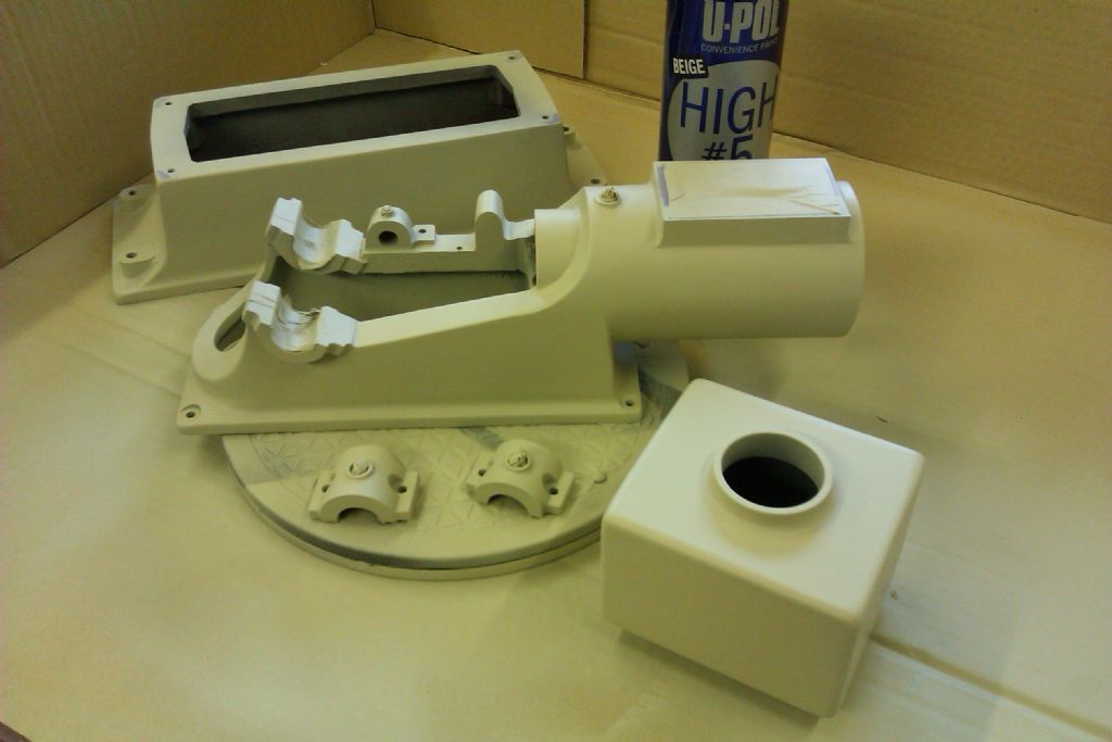

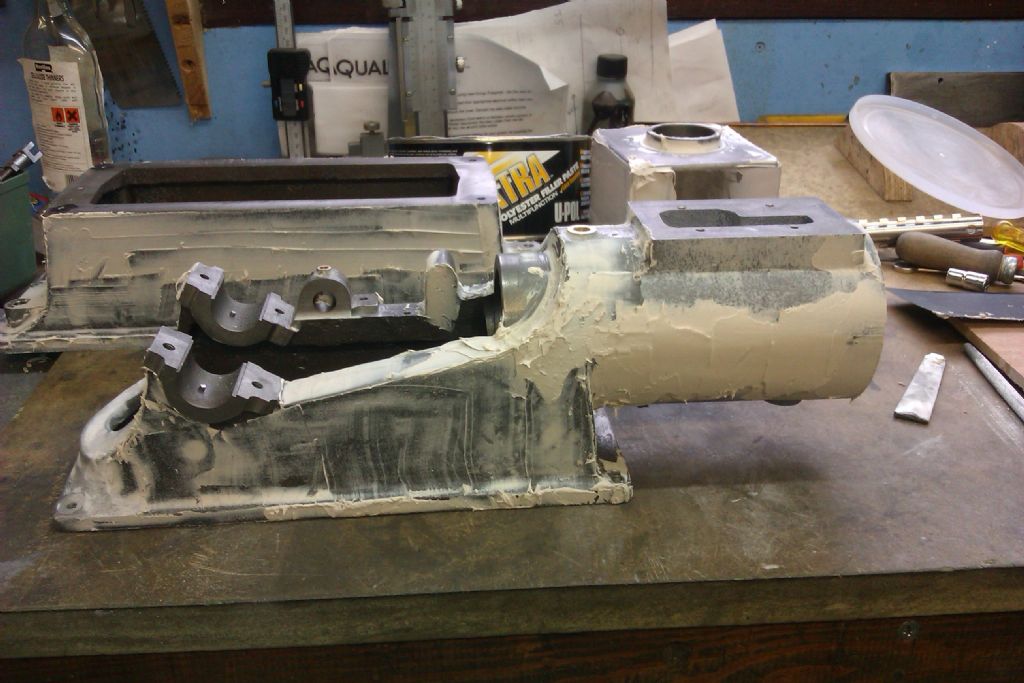

                    Like the others I fettle the castings first, removing the part lines also gives an indication of a chilled casting as the thin bits are the first to go hard. On smaller items I run a die grinder with a grinding bit over the surface to knock off the high spots.
                    Mostly I don't paint before machining, you should not really need coolant on CI and I tap/drill it dry
                    Unless there is a major problem with the casting I won't fill it on a live steamer like a traction engine but on some of the stationary engines then its out with the U-pol. As an example I filled this last weekend as the model used three castings where the original was one piece so there are joint lines to hide and the large amount of filler down the side is where they trimmed too much off at the foundry.
                      Thanks for the detail, Nice illustration, much appreciated.
                      Is U-pol a filler from the car paint factors?
                      Steve

                          Halfords do U-pol, I find it sands better than P-38

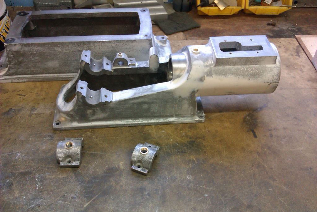

                                On softer castings I use an old Wolf engraver to reinstate the texture if its required, this Lukenheimer carb is a good example, you can see the smooth areas where its been fettled and plugs silver soldered in to fill fuel passages.
                                And the same thing after 5mins with the Wolf
                                This is the side of that engine I posted above showing where it was ground away by the foundry and where the lower casting has had to be milled away as one mating part was 3/16" smaller diameter than the other. This engine also suffered from the nasty habit of using Dymo lables to identify the patterns which are reproduced on the castings, by the time they have been ground off you loose all the sand texture
