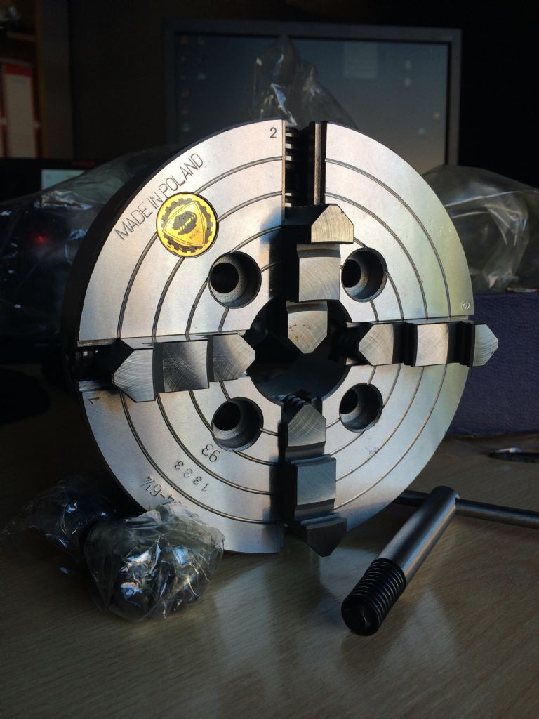

      Hello peoples.
      Just had this delivered. laugh
      I have new cast iron D1-3 backplate for my Boxford. I now have to machine a rebate into the backplate.
      I have never machined cast iron before so some general tips for machining, drilling and tapping this job would be appreciated.
      Or shall I just stick it on with evostick or no nails.? cheeky

          As its a part machined backplate there should not be any skin on it so just tackle it with what you would normally use to turn steel. Drills fine, taps nicely do it all dry as the graphite in teh iron will be your lubricant.

            When I last did one I mounted the back plate in the lathe and machined the rebate and mounting face, make sure when you mount it the faces are clean as you want the back plate to run true.
            I then made up a bush for the tapping drill and drilled one hole and tapped the hole once one was done I used the tapped hole as a location and drilled and tapped the other three. It does not need accuracy to the 0.001mm but it is nice to get it close as the rebate and the face are the location and the bolts/cap screws hold it all together.
            If you can try to make the finishing cut at least 0.003" I usually aim at 0.01", other wise the chances are the tool will just rub on the surface and not cut.
            It's an idea to cover the bed of the lathe but not with a rag/cloth that could get caught up in the work piece and also wear a mask as it is likely to be a dusty job, do not be tempted to use any coolant as cast iron is machined dry.

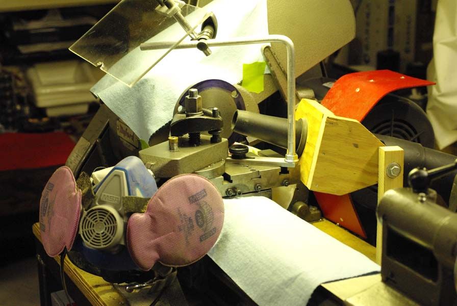

                        “Bill Hancox”
                          @billhancox
                          Nick
                          This may be of interest to you. I constructed the adjustable plywood bracket that clamps to the rear of my lathe bench. A hole accommodates a tapered Shop Vac Nozzle that can be maneuvered close to the work. Cuts the airborne dust down significantly.
                          Bill
