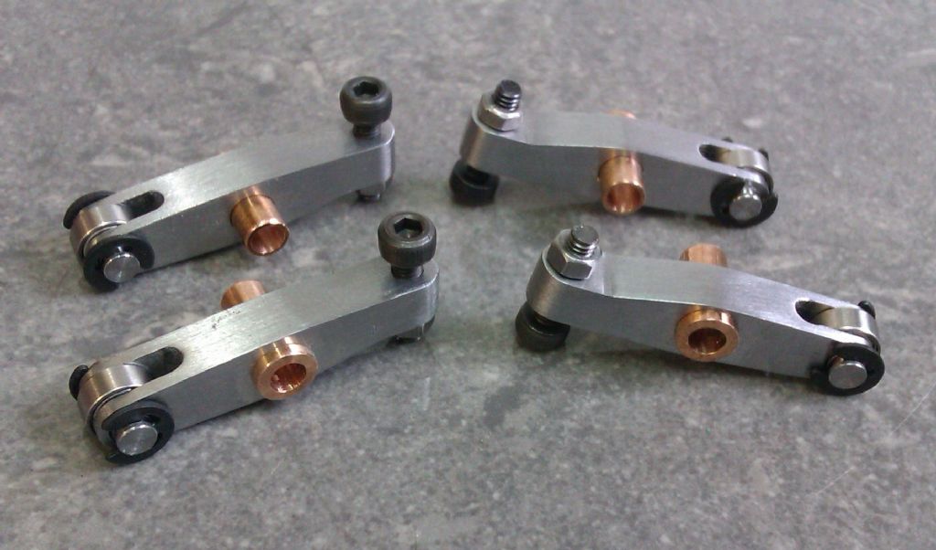

                      PS Pic of the rockers finished yesterday
                      Rockers
