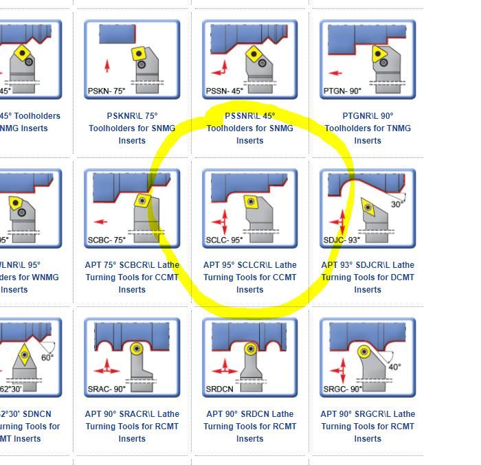

                            this was the link from another member
                            https://www.arceurotrade.co.uk/Catalogue/Cutting-Tools/Lathe-Turning-Tools-Indexable/ARC-Indexable-Turning-Tools/SLTBN-Part-Off-Blade-Tool-Blocks-with-Part-Off-Blade
                            this was the bewildering link from apt
                            https://www.shop-apt.co.uk/lathe-turning-tools-apt.html
                            no way to select shank size all seemed to be 20mm+
                            i dont know how to get to your page
                            #553733
                              Posted by brian jones 11 on 11/07/2021 18:29:57:
                              From your link click on a tool that is shaped how you want and that takes the insert shape you want, I went with the one ringed as that's a good all rounder as one tool will face and turn diameter and they fit boring bars too so you don't end up having to keep a big range of insert shapes/sizes.
                              From there look at the code numbers given, 0606 is 6mm square, 0808 is 8mm square and so on.
                              SCLCR is Right Hand SCLCL is left hand but L/H get a lot less use in this style of holder hence why not so many in sets

                                  You select the type of tool you want then the size options are available.
