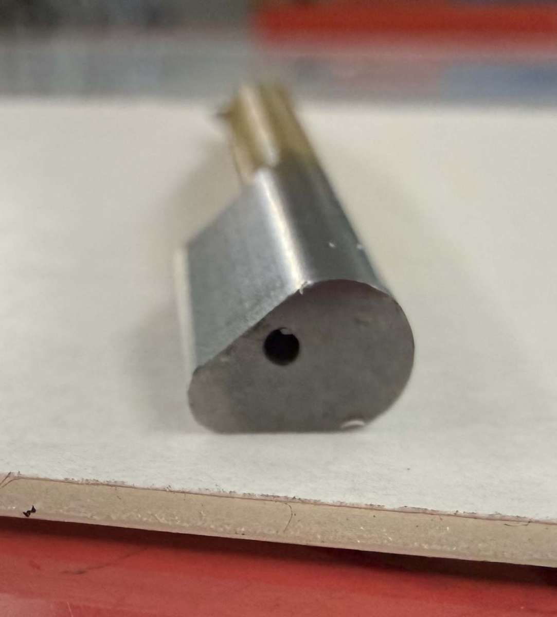

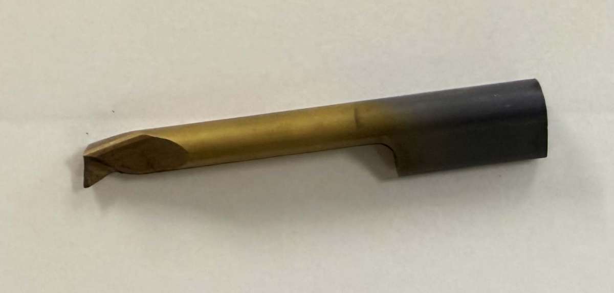

      I have a box of these tips. They look very useful but they have a strange mounting arrangement that makes it difficult to use without the correct holder. The shank is an unequal oval shape. I thought about cutting off the large portion and just using the thin bit but that is not regular either.
      Overall about 40mm long.
      I assume they are for boring small holes but am by no means certain.
      Does anyone recognise them or know anything about such tips please?
      IMG_2686
      IMG_2687
      #832917
        They are made by P H Horn although a few other makers use the same teardrop style shank. Holders are available but not cheap
        For hobby use use can make a simple holder with grub screws to push them against the side of a plain round hole.
        I have another form of shank on some of mine and that is all I do.
        https://www.1st-tooling.co.uk/Horn-Mini-Boring-Bar-Holder

          Thanks Jason,
          Having now seen a holder, I might be tempted to make something up. I can CNC the hole if I am careful.
          Looked on ebay – yes, they are not cheap!
          #832919
          bernard towers
            @bernardtowers37738
            Did mine about 20 years ago by drilling the large dia hole and using a small slot drill for the minor one and cleaned up by broaching with a broken tool. Use a grub screw to hold location.

              I made a couple of holders for this type of insert years ago as I ended up with a box of used ones. All types of threading, boring and grooving tips.
              From memory, I think i just drilled 2 holes for clearance and milled the location angle.
                Another option is to drill the small hole, plug it back up with a cylinder of the same material and loctite. Then drill the larger one. Heat up to break the loctite.
                A long-winded way would be to fabricate it from two halves and make the thin end pointed (vee rather than oval).

                  From a German forum, quite a bit on the Horn tool holders. I have hundreds that I purchased at auction and use them often. Easy to break if fed to deep, ask me how I know.
                  https://forum.zerspanungsbude.net/viewtopic.php?f=59&t=44478

                      I can’t read German but the drawings tell me all the dimension I need!
