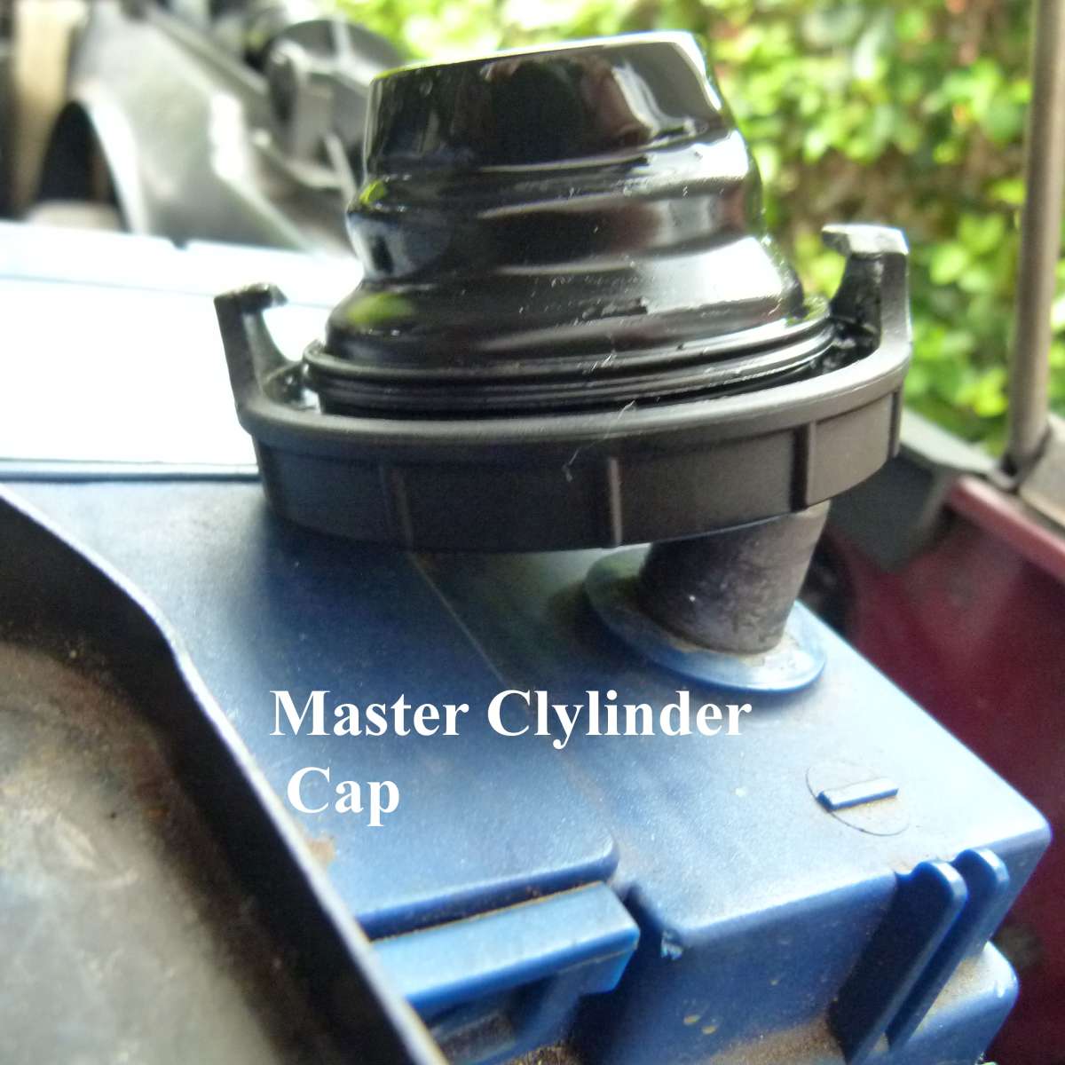

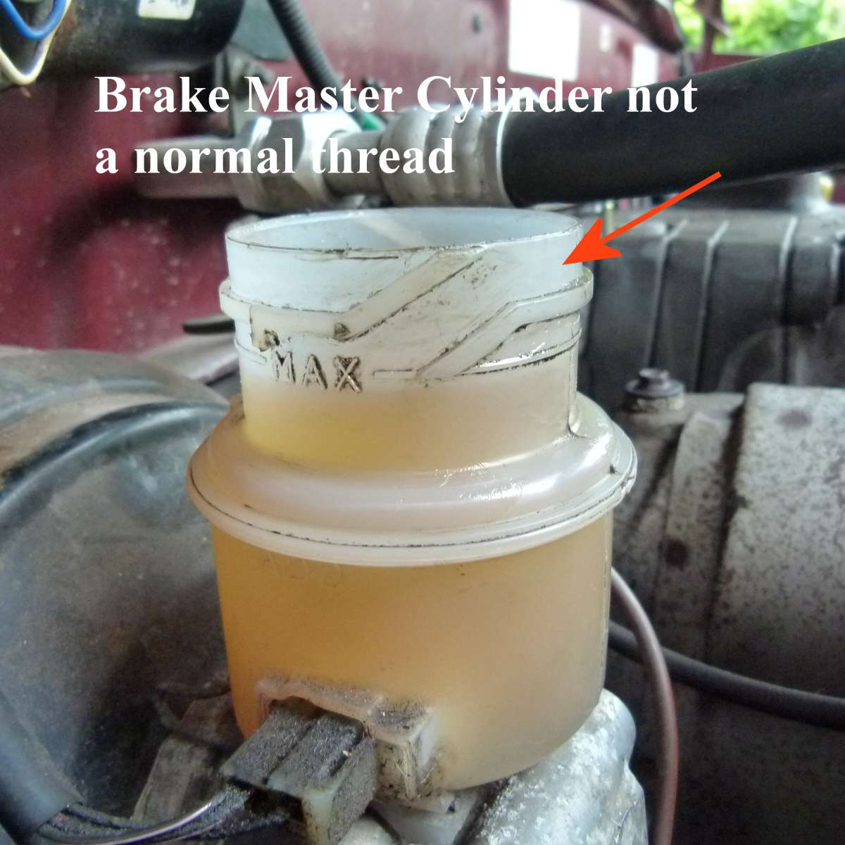

        Can someone out there with a lathe drill a hole down the length of say a 10mm diameter bolt so the brake fluid can travel down it and then turn the shank end down a bit so it’s a tightish fit in a 8mm outside diameter tube, I think the bore on the flexible tubing is about 5mm diam., I’m sure someone will have a bit of tube lying around they can try it on for fit.
        The only thing I have is a hand-held drill and one of those cheap drill stands a hand drill can be put in, so drilling down a bolt is not so easy as doing it in a lathe, besides the bolt shank diameter will also need to be turned down so I can push the plastic tube on and be able fix it with a clip.
        The bolt thread would need to be long enough to go through the 5mm plate which I already have but with enough thread length so I can fit a fibre /rubber washer and nut on both sides of the plate.
        If someone would like to private message me and tell me how much they want that would be great.
        The brake fluid cap on the car is like the one in the photo, I’ve not seen any like it before, that’s why I’m going to try a get something made which will hopefully do the job.
        P1050864
        P1050863

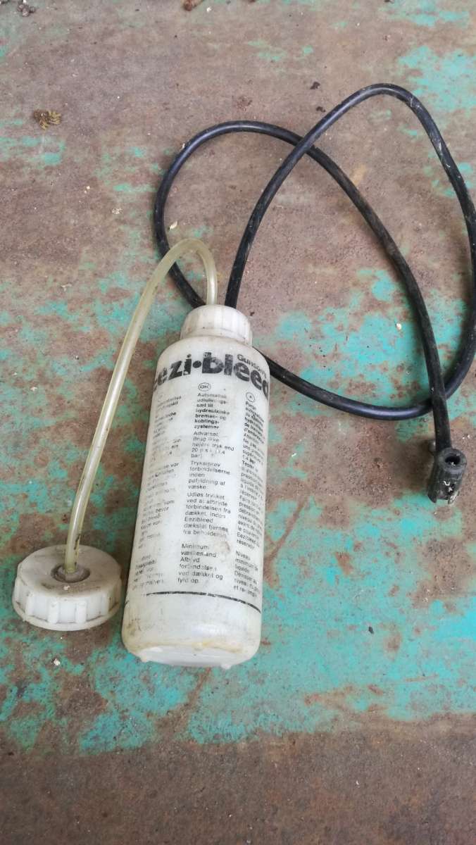

          Hi, I have an Ezi-bleed, which I’ve used many times, and it only needs to be attached to an inflated tyre to about 20 psi. I’ve never had any leakage problems with it, but I haven’t needed to use it for quite a while.
          Ezi-bleed
          Before I had that, I fitted some simple automatic bleeders, which had a spring loaded pointy bit that went into the cylinders, and all you had to do was crack them open a little bit, put a transparent hose on the nipple, and put it into a container, and then gently pump the brake pedal a few times until there were no bubbles in the tube and then shut the nipple, but of course you would need the open end of the tube just a little higher the the nipple. You could do all of the brakes on your own, but it did need you to get in a out of the car a few times, and remembering to top up with brake fluid.

            Somewhere I have a bit of plastic pipe with a non return valve on the end. You just slip this over the brake nipple and put the NRV in a jam jar, fill up the master cylinder, slacken the bleed nipple and pump away. No need for slacken/tighten, just make sure you don’t empty the master cylinder. Pressure/vacuum pumps just seems an unnecessary complication.

              Thanks for your replies Nick and Duncan, I may as well give the Sealey one I bought a go, now I have it.

                  Why not just buy a fitting which has a 1/4″ BSP female thread such as this one.
                  https://www.toolstation.com/brass-female-socket/p57447
                  and solder  (Or silver solder.) it into a hole in the 5mm plate.
                  Les.
