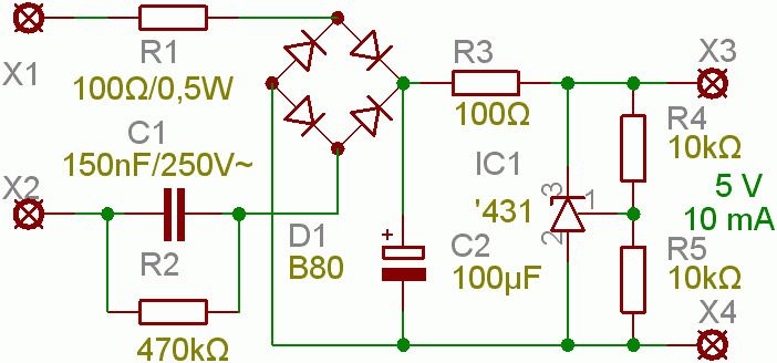

                          Capacitor dropper power supplies can in fact be found in small appliances. For example, we have a hot air fryer, sold in the UK as a Tefal Actifry. It decided after the warranty ran out to shutdown regularly with an error code. Being me, I took it apart to investigate and found it has a small controller board powered by a capacitor dropper 1/2 wave power supply (on the same board), It powers the mcu (an 8bit ST model) display etc direct from the mains with no isolation. A bit of research indicates these types of supplies are more common than one would think, because they are very cheap and in the case of the Actifry saves putting in optoisolators to sense the AC zero crossing point detection and for the triac motor control.
                          Be very careful with these supplies on the bench. I do my test work with the board connected via an isolation transformer as otherwise they are dangerous (even then working carefully).
                          If anyone is interested in knowing more about the capacitor dropper design the following Applications Note from Microchip may be of interest, which is quite often referenced by other sources on the internet..
                          https://www.microchip.com/wwwAppNotes/AppNotes.aspx?appnote=en021083
                          As for power factor I have not investigated as I don't yet have a meter for that.
                          On the point about wall warts raised earlier, the limited number I have taken apart have either had a transformer, the older type, or have a genuine switch mode power supply, both types giving genuine mains isolation.

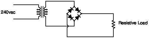

                                          Here's my go at understanding what's going on.
                                          First, a rectifier circuit that doesn't cause PFC or harmonic problems:
                                          This is OK for Power Factor because the diodes rectify throughout the AC cycle, and the un-smoothed DC output is fine for electric railways, heating, lead acid battery chargers, electroplating and other unfussy applications. Good Power factor, rotten DC because the circuit outputs 100Hz half cycles obnoxious to amplifiers, radios and many other requirements.

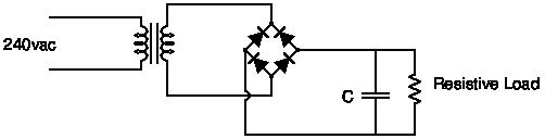

                                          The 100Hz half cycle DC can be improved considerably simply by adding a big capacitor. It stores electricity during peaks and releases it during valleys, putting cleaner DC on the load by filling in the gaps.
                                          Unfortunately adding Capacitor C has a profound effect on the rectifier diodes. They no longer conduct throughout the AC cycle, instead they're called on to charge the capacitor mostly at the top of each AC cycle. This causes the transformer to draw current from the mains in far from sinusoidal pulses causing harmonic distortion.
                                          Power Factor, in the sense of a phase shift caused by an inductive motor doesn't cover this situation so the governing standards express acceptable distortion in terms of harmonic content at various frequencies. Seems that basic capacitor smoothed power supplies meet these standards up to about 60W, beyond that power supplies need some form of Power Factor Correction.

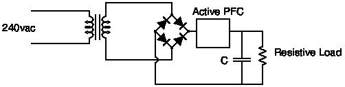

                                          The modern approach (over the last 30 years) has been to replace massive chokes with some form of active power factor control.
                                          PFC can be improved with a suitable arrangement of rectifiers, capacitors, and resistors. The circuit manages the rate at which C is charged, buffering the rectifier from the brutal current requirements of the simple circuit. However, more likely than this simplicity, a switch mode boost converter circuit is used. It draws near sinusoidal current from the rectifier, generates high-frequency AC from crude DC, and much smaller inductors and capacitors can exploited to filter fast switching pulses into clean DC. Rather than being a simple filter, the convertor will be a fully regulated circuit. The main disadvantage is the interference caused by high speed switching.

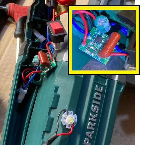

                                            Would this be one of these beasties? It's from my bandsaw, appears to have gone short circuit and to be delivering 300v to the LED which made that understandably unhappy.
                                            4 legged chip has 810 on it and I think is a bridge recitifier, there is an obvious electrolytic but I haven't attempted to decipher the rest of the circuit yet.

                                              The brown tubular thing looks like a power resistor to me.
                                              #519268
                                              Martin Connelly
                                                @martinconnelly55370
                                                It does look like the circuit board in the main picture has R1 under the brown component. I think the 4 legged IC is likely a bridge rectifier.
                                                RS bridge rectifier example

                                                    The brown rectangular component is a film capacitor. I'd agree that the 4 legged IC is a low current bridge rectifier.
                                                    Andrew
                                                    #519273
                                                    Adrian R2
                                                      @adrianr2
                                                      John – thanks, that's not likely to be the problem then.
                                                      Martin – agreed, I think this is also probably still OK as I am getting output voltage.
                                                      I suppose next step is to desolder and test the electrolytic. If any of the surface mounted components are dead then it's probably game over.
