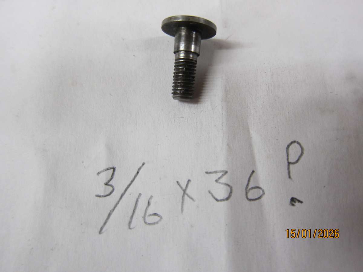

      Does any recognise the thread as machined on a pair of Juliet X-Head pins which mic up as 3/16x36tpi? The drawing for the item calls for a 5/32×40 or a 3BA thread but it does not conform to either of these standard sizes.Juliet X-Head Pin

        How sure are you of the tpi? as 2BA is only a couple of thou less than 3/16″ at 0.185″ but coarser at 31.4tpi
        There is also #10-36 UNEF which is the right tpi but 0.190″ dia

          Pedantry corner: #10-36 seems to be UNS, S for Special, not UNEF which apparently only goes as small as #12-32.

              I can’t belive that it us anything as exotic as a UN/UNF thread form but at the moment I have yet to come up with an answer. 2BA and 10-32 are close on diameter and make a partial entry into to the corresponding  tapped hole but are not right on TPI which unaccountably records a pretty good fit at 36 on my thread gauge.

                A look at the thread form should readily distinguish between BA and UN
                Get the Loupe out

                  Hi. apart from what has been said, the only thing I can find is ANF 8 36TPI, but that is just under 11/64″, Maybe someone just screw-cut the threads that you have, but of course they would have done the nuts as well.

                    4.5mm X .75mm ?    0.177″ X approx 34tpi . Worth a try ? Noel.

                      I have decided to cut my losses and drill out the X-Head to receive a newly made pin threaded 3BA. Thanks for all the help offered.
