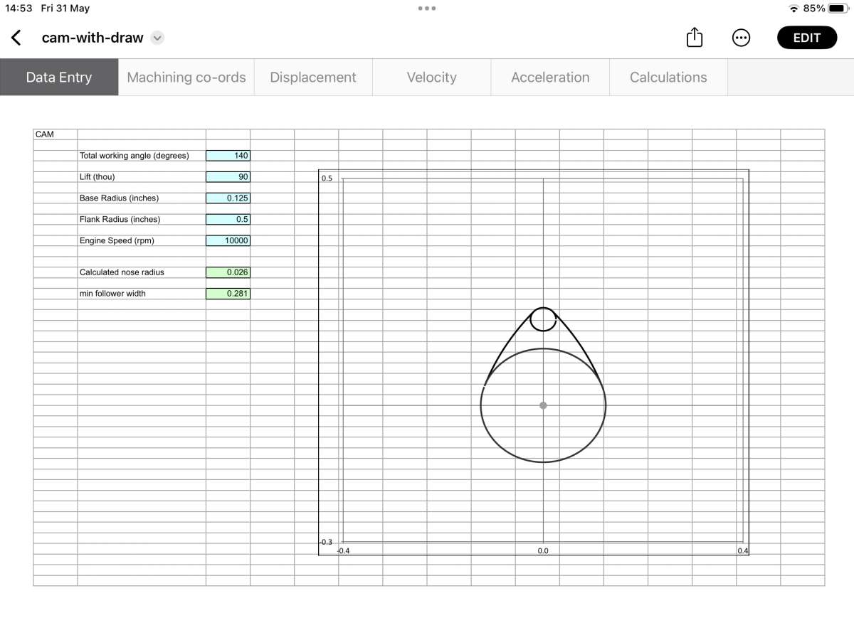

                          For Rod …
                          IMG_9691
                          Aspect ratio of the image looks a little odd [?]

                            Michael, thanks for that.  Getting Excel to plot a graph with equal X and Y scaling needed a technique involving a ghost graph hidden underneath the cam display graph.  I guess Apple’s display handling differs from Microsoft and Android.
                            Rod

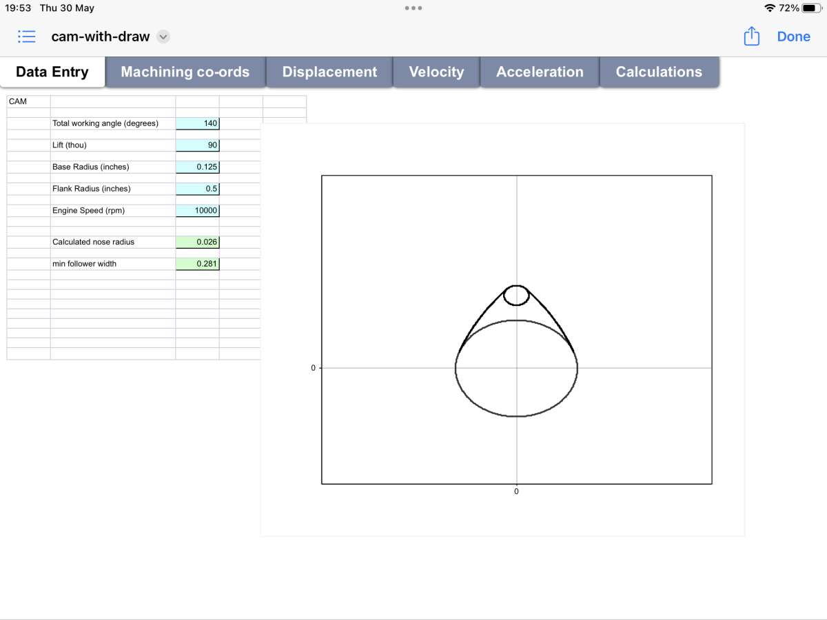

                              #733520
                              Simon Musson 1
                                @simonmusson1
                                For Rod
                                caculations work ok but doesn’t do the drawing bit-but not bothered about that
                                Simon

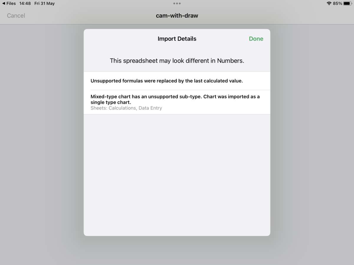

                                #733528
                                  I had only viewed the file before … but properly importing it into Numbers pops-up this warning message:
                                  IMG_9696

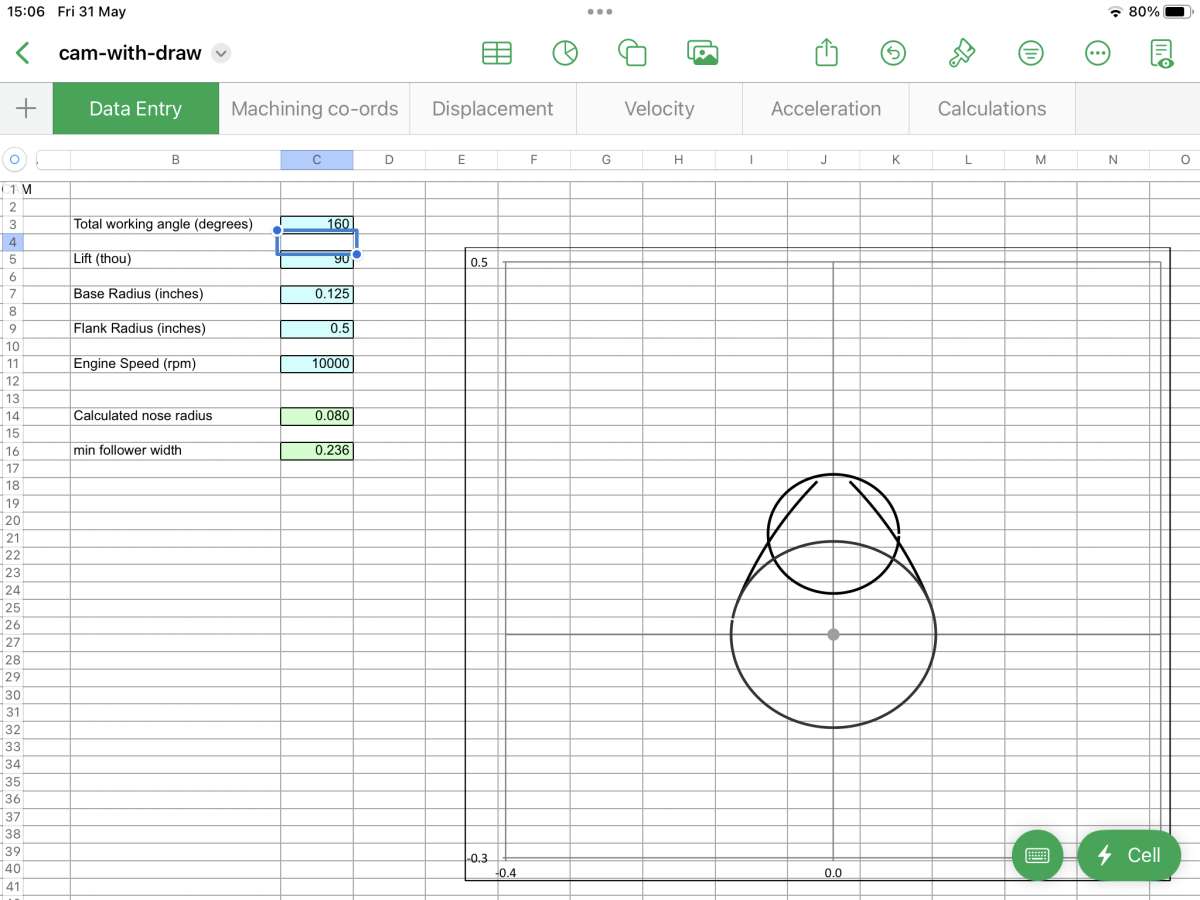

                                  Edit: __ the image of the cam looks much better proportioned, but it doesn’t re-draw properly if the input values are changed.
                                  [ unless of course it was utterly stupid of me to try changing tha angle from 140° to 160°]
                                  IMG_9697
                                  IMG_9698
