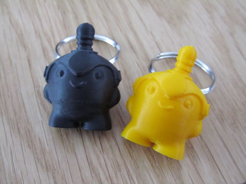

                              A couple of samples arrived this week. The Black one was printed on a Zortrax M200 in ABS and the yellow one on the Ultimaker 2+ in PLA. Both 90micron layers.
                              Not much between them some areas better than others on both. Still leaning towards the flexibility of the Ultimaker.
                              Samples

                                PLA prints like dream, it's an absolute doddle. Prints look good, they don't warp, they are stong – minimal effort required.
                                ABS is very tricky, it's inherently low friction so bonding to the build plate and to itself is much more challenging. It also requires much higher temperatures and warps easily.
                                It's not a fair comparison really, but I think even with all the above stated, the Zortrax takes it, just keep in mind that with the Zortrax your locked to their own brand consumables, there's no tweaking or playing, no settings to adjust, it's all locked out. I would get an ABS sample from the Ultimaker and the CEL Robox for comparison.
                                The CEL also has preprogrammed print settings, but you can change, modify, source your own materials if you wish – it's an incredible amount of innovation for the money, but a limited Z height (usually not a problem)
                                #233895

                                    Hi Russ,
                                    I agree, I thought it was a unfair comparison when I saw they were different materials. I have read mixed reviews about the Robox, have you any photos of parts you have printed?

                                      John, The Robox and the M200 both have perforated build plates – I've noticed they get excellent ratings so I'm looking for one myself. From photo's they look like the material PCB's are made from but I haven't seen one up close – no doubt they have a specific coating, or are perhaps a specific type of PCB board if that's what they are (I'm thinking – probably not)
                                      Michael,
                                      I don't have a Robox, I have a Rostock MAX v2 (rev 3 or 4) cheeky
                                      I think the early Robox did have some software issues so I admit, it is a tricky one. My Rostock MAX got some poor reviews but now I've updated to the lastest ball joint effector arms and injection moulded spring loaded carriages, its smooth (and very accurate) sailing all the way!
                                      What height are those samples and can you point me to a model or website. I'll make an ABS and PLA version on my printer for comparison using the same 90 micron layers but I can print at 5 microns! I would be very interested to find out how long each printer took to print those samples.
                                      The smallest layer height isn't the best, you're just increasing the chances of a slip up, and massively increasing print time – it depending what you're doing.
                                      I'm sampling some XTC-3D from Bentley Advanced Materials in the next week or so which will be interesting.

                                        The samples I have been sent are about 35mm high and the paperwork says they both took 1 hour to print with a layer height of 90 microns.
                                        Interested to see how well the XTC-3D smoothens off your prints!
