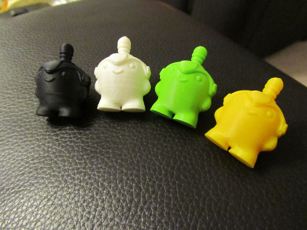

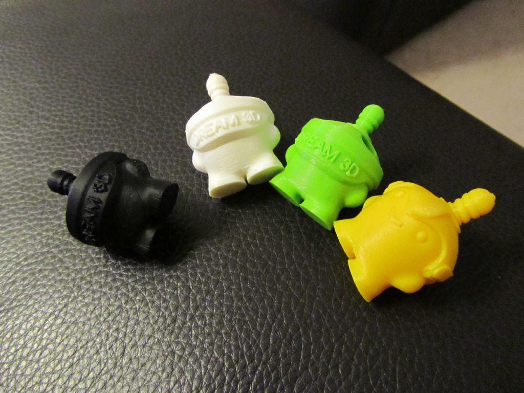

                Couple more samples arrived:
                Black: Zortrax M200 ABS 90microns.
                White: Ultimaker 2+ ABS 90microns.
                Yellow: Ultimaker 2+ PLA 90microns.
                Green: Ultimaker 2+ PLA 90microns Simplify 3D software.
                Samples3Samples2

                  Today I was able to visit Mach 2016 and see the Ultimaker 2+ next to the Zortrax M200. There is no question that the build of the Zortrax is more superior and solid compared to the Ultimaker. A noticeable difference is the Zortrax uses a ballscrew for the Z plane compared to the Ultimakers lead screw.
                  Unfortunately the Zortrax is very restrictive on materials and programming settings so the Ultimaker wins on the overall versatility of the machine. If my requirement was to just print ABS prototype parts then I would choose the Zortrax.

                    Zortrax is very restrictive and expensive. I think my company likes this, less options, less fiddling, it ticks a lot of boxes for them, it may mean we can't experiment with things as much. I printed a semipermeable/filter the other by lowering the extruder to 50% which printed me a sort of rigid mesh. I was trying to set my software up to write dual extruder code (which is did successfully) I then wanted to set one "extruder" to extrude at 50% and the other one at 100%. I then told it to print a block, inside a cage, the block being on the 50% extruder. I then saved the file as gcode text, and replaced all T1 with T0, so all instructions were sent to the same extruder. (I also removed a few of the other settings like wipe and prime etc)
                    It all worked from the hardware and trickery side of things, but my software refused to recognise 2 different materials and printed both solids with the same material settings, even thought I'd told one to be 50%. I also tried telling it the fillament in second extruder was larger in diameter to get the same effect, but again, it ignored me and used the primary fillament settings.
                    So a fair anyway, but more to do with my slicer than my printer or programming.
