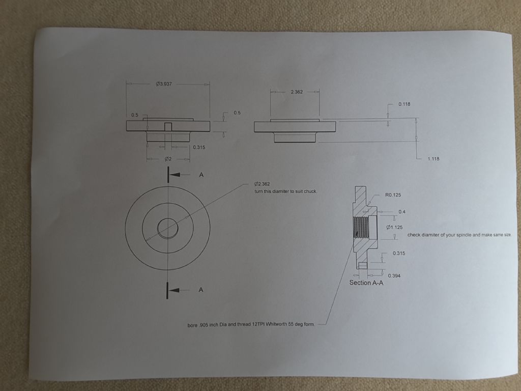

                                #605157
                                David George 1
                                  @davidgeorge1
                                  I have drawing of a back plate if it helps.
                                  David
