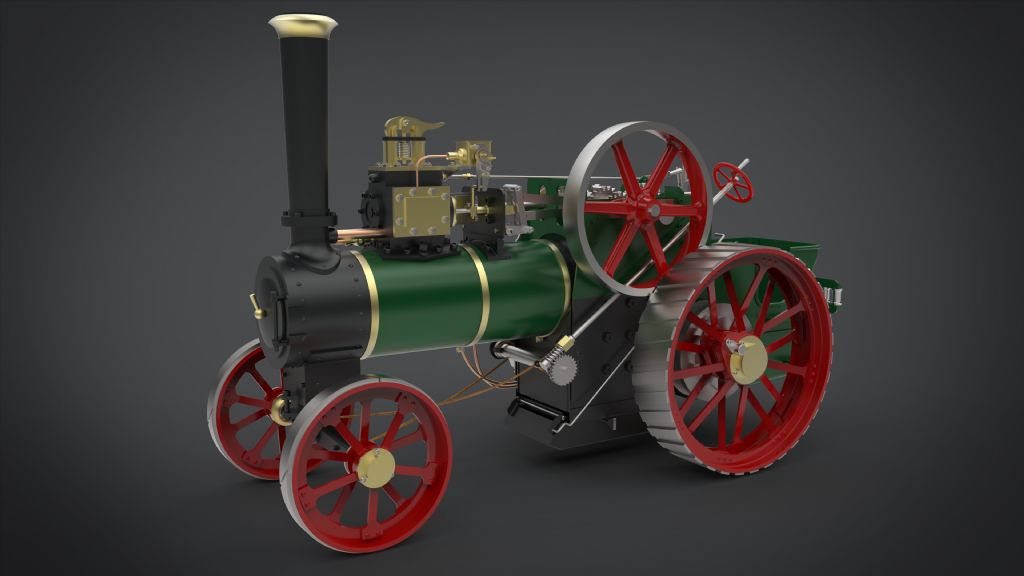

      Although I have some lathe experience. I have not tried to tackle anything as big as this
      I have the necessary castings, so any thought, tips etc will be very much apreciated

          The book of the build is worth getting a copy of and check out some of the later thinking for the stays and horn plate attachment.

            L C Mason wrote a book on the Minnie, W J Hughes wrote on the Allchin, if you can get hold of either they would be a great help, but might be hard to find at a reasonable price. Alternatively, the Minnie was serialised in detail in ME in the early '70's IIRC. The Allchin was serialised twice.

              Could you be more specific, or tell me where to find the information you mentioned please.
              A pal of mine is just starting a Minnie and would be interested in anything new that is not on the drawings or in the book.

                There is a build thread by pgk pgk on this forum **LINK**
                There is another build on MEM but it suffers from the FB picture loss but a link was supplied for Firefox users on the same forum  **LINK**

                Paul Lousick
                  @paullousick59116
                  A 3D CAD model and photos of the 1" Minnie can be downloaded from GrabCad
                  **LINK**

                        The book by Len Mason calls for threaded stays soft soldered, but it seems silver soldering is now required/preferred. The silver soldering seems to allow a plain stay eg a copper rivet. The array of nine stays for the attachment of the horn plates can be modified to 4 hollow stays to bolt through and Five plain stays. Plenty of Minnie’s have been built using both methods and a bit of a look round this forum will turn up some info and a Google search will find details of how people have done this. This is what I have found out and yet to put into practice. Others will guide you from real experience.

                            I have been a bit busy the past few days, BUT WOW what a set of very kind responses. I have now joined GrabCad, and started to look a the files,
                            Thank you all so much faorv helping me.
