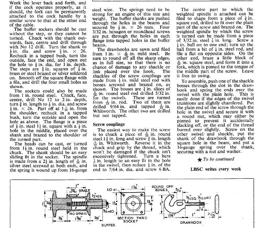

                                    Help once again…. I am in the middle of machining the buffer beams for the Pansy, so far so good. Now I don't know if I'm being blind or just stupid, as I'm new to loco building, but I can't find the drawings for the buffers. They don't seem to be on the drawings. Can someone point me in the right direction, either purchasing a set already made or to the details required for machining.
                                    Thanks in advance.
                                    Richard.
                                    #313306
                                      ME Vol 119 issue 3005 shows the buffer drawings
                                      Edited By JasonB on 22/08/2017 08:22:42

                                        Thanks for this. I recently purchased both volumes 118 and 119, and shall have a good read.
