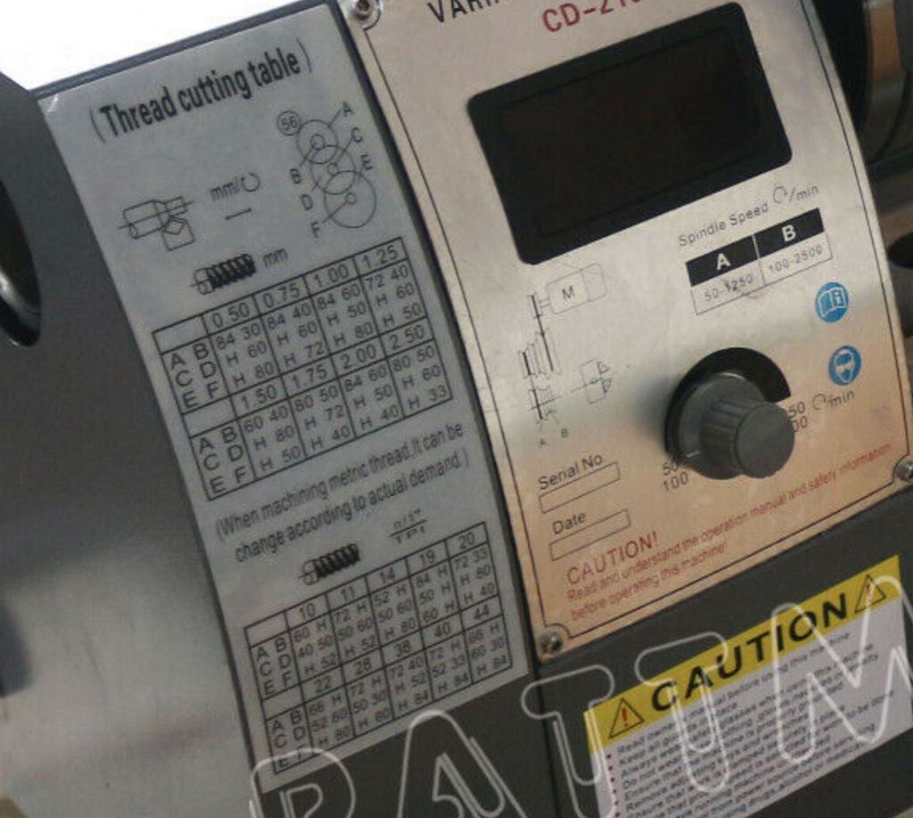

                          #539027
                          Brian Wood
                            @brianwood45127
                            Howard,
                            I was making a lot of assumptions with my calculation. I now have Julian's photo of the headstock [with a fixed 56 T gear on the lathe spindle] and showing the threading tables; he tells me his leadscrew pitch is 2mm
                            I have had to recalculate accordingly, the value one gets from the machine plate is 9.84 TPI
                            I am hoping Gerard O'Toole will get in touch, he has the same lathe and my new tables might be of interest to him as well
                            Regards
                            Brian

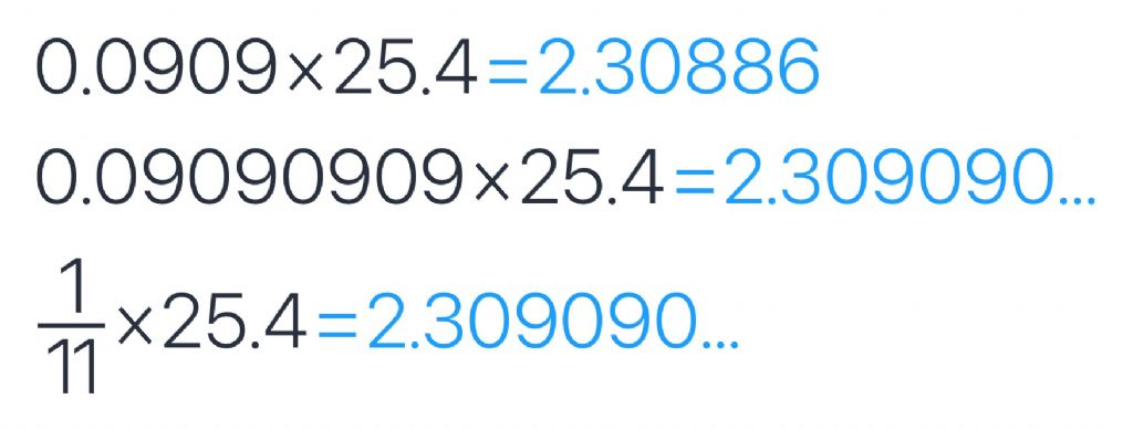

                            #539043
                              Posted by Howard Lewis on 10/04/2021 16:13:53:
                              Your 5/8 BSW thread is 11 tpi ( 0.0909 inch pitch which calculates as 2.30886 mm)
                              dont know
                              There’s a Devil in that approximation
                              … try working to a few more decimal places
                              592e30dc-31d5-4915-99fa-38cd7234bb54.jpeg.
                              I believe the 09 sequence repeats to infinity [but I can’t be sure … yet]
                              You are, of course correct about the 127 conversion angel
                              Edited By Michael Gilligan on 10/04/2021 20:01:22

                                    #539134
                                    Brian G
                                      @briang
                                      I took this screengrab of the change gear table on a CD 210V lathe currently on eBay. I do very little screwcutting, so hopefully I am wrong, but the table looks spot on for 0.5, 1.0 and 2.0mm threads with a 2mm leadscrew (which leads me to fear I may be right).
                                      It doesn't do as well for the others. The worst metric thread is 2.5mm which I think comes out at 2.121mm (56/80 x 50/33 x2 mm). It would be closer (2.545mm) if B & D were swapped, so perhaps this is a simple typo?
                                      Imperial screwcutting appears totally chaotic, with only 20tpi coming close. Like Brian Wood, I can't get the numbers to work with a 12tpi leadscrew either, so I don't think they took this part of the table from an imperial lathe.
                                      PLEASE will somebody prove me wrong, I really don't want to believe I am right.
                                      Brian G

                                            #539180
                                            Brian G
                                              @briang
                                              Hi Brian
                                              I am fairly confident that whatever pitch leadscrew the lathe has in practice, the metric table at least is based on a 2mm leadscrew, which agrees with Julian's measurement of what was meant to be an 11 tpi thread.
                                              I had already tried 12tpi in my spreadsheet and according to the plate in the photo the metric threads work (at least approximately, apart from 2.5mm, which looks like a typo) if the leadscrew is 2mm pitch, but none of them come close at 12 tpi:
                                              Pitch, 2mm L/S,12tpi L/S
                                              0.5 mm, 0.500 mm, 0.529 mm
                                              0.75 mm, 0.741 mm, 0.784 mm
                                              1 mm, 1.000 mm, 1.058 mm
                                              1.25 mm, 1.244, mm 1.317 mm
                                              1.5 mm, 1.493 mm, 1.580 mm
                                              1.75 mm, 1.750 mm, 1.852 mm
                                              2 mm, 2.000 mm, 2.117 mm (56/84 x 60/40 = 1:1, suggesting 2mm leadscrew)
                                              2.5 mm, 2.121 mm, 2.245mm (2.545 mm with 2mm L/S if 50t & 60t gears swapped)
                                              The imperial threads are a mess with either pitch leadscrew, it is as if only the gears for metric threads are supplied.

                                              #539187
                                              Brian Wood
                                                @brianwood45127
                                                Hello Brian G,
                                                Your analysis agrees with mine, point for point using a 2 mm pitch leadscrew, the results when trying a 12 TPI leadscrew were a whole lot worse and I hope others with recent purchases who will send them back. These results are quite frankly atrocious which ever way you cut the cake and I suspect the 56 wheel is a big mistake..
                                                The Grizzly lookalike GO 768 has a 40T spindle wheel and results that are acceptable when matched to a 12 TPI leadscrew, which threw me to start with as in my experience it is very unusual
                                                It is all very unfair on a potential purchaser who is in no position to do other than take the values on trust. There are at least three other Chinese factories making these under different names than a CD 210V, all are fitted with the same gearing plate.
                                                Caveat emptor I think.
