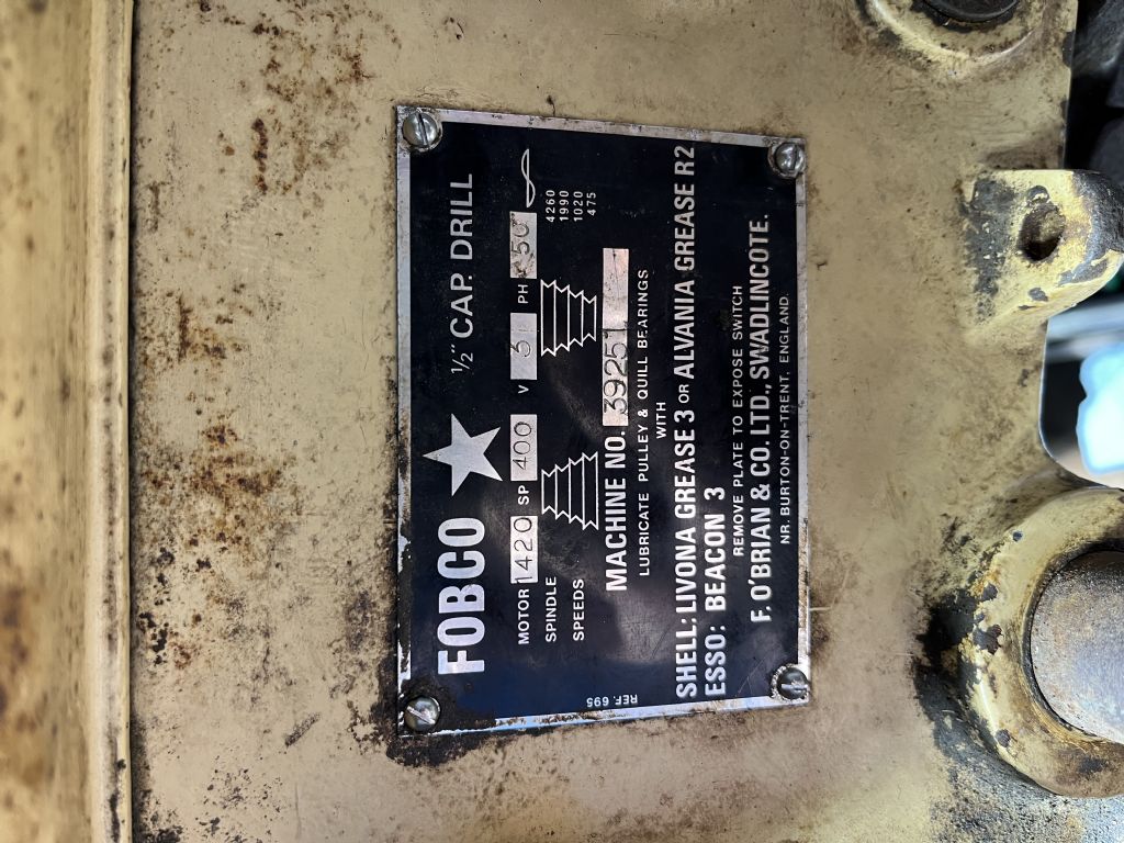

        Hi
        Now this might be a stupid question but here goes. I have just acquired an old fobco star pillar drill and the information plate is held on by some small screws, half of which are missing so I want to buy some. I measured them using my calliper as 2.75mm across the thread crests which according to my conversion chart makes it closest to 7/64 (2.78mm). However I can’t find 7/64 fasteners for love nor money. I’m relatively new to old British fasteners so am I measuring it wrong? Has literally nobody in the world ever used a 7/64 bolt?
        Thanks
        Dan

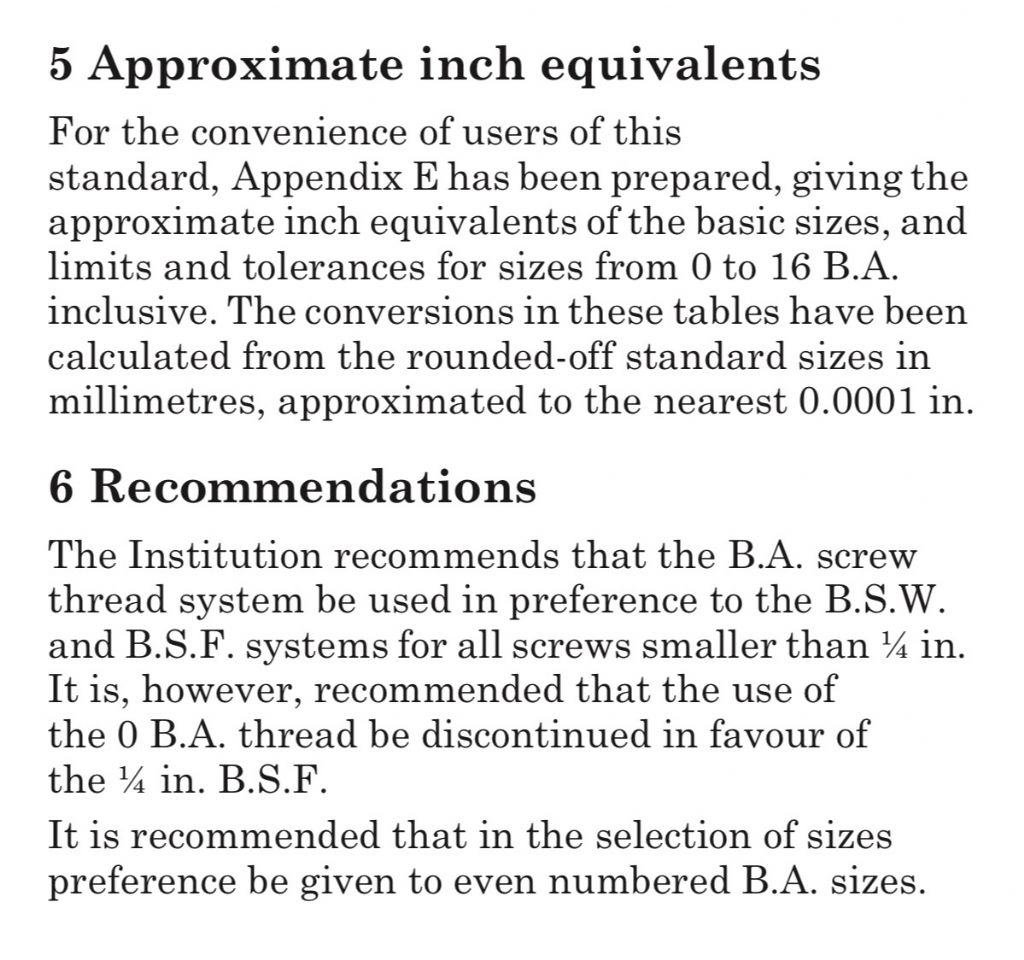

                            Posted by Mike Poole on 15/05/2023 22:33:27:
                            It was quite common practice to use BA for sizes below 14”
                            Not only ‘quite common’ but ‘BSI recommended’ practice
                            Sorry, I can’t recall the standard number or its issue date, but I know it was clearly stated.

                                Posted by Michael Gilligan on 15/05/2023 23:44:08:
                                Found it smiley
                                BS 93:1951
                                In the spirit of ‘fair use’ … Two brief paragraphs quoted:

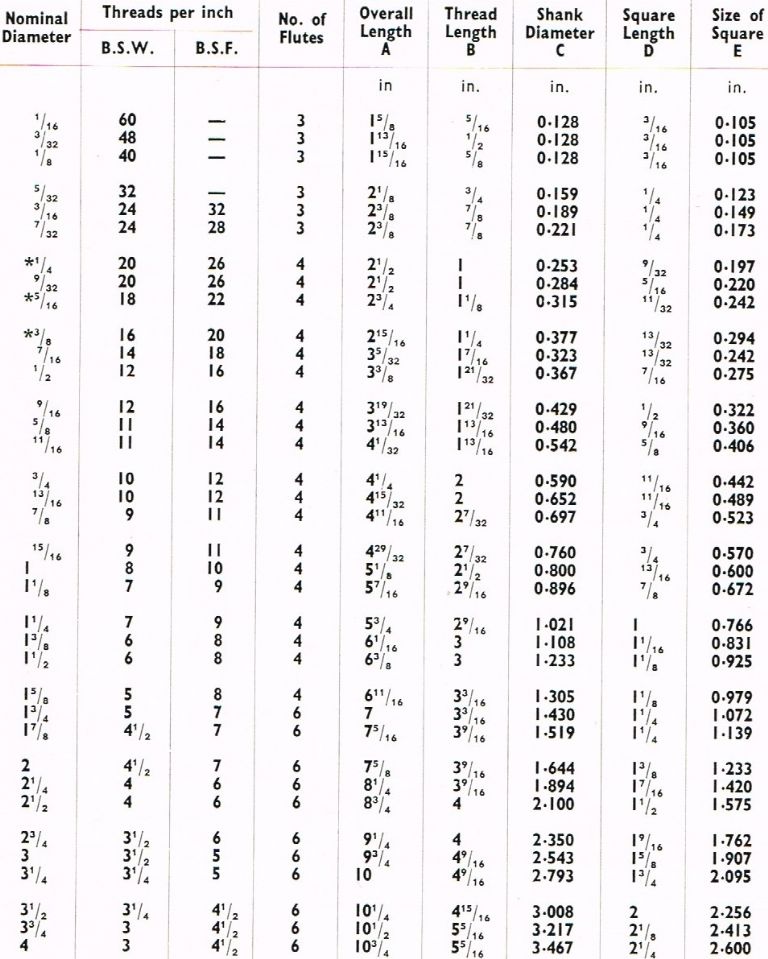

                                  Nicholas Farr
                                    @nicholasfarr14254
                                    Hi, in all my days in industry I have never come across any standard BSW/BSF threads or lists with any size that has a 64th increment. Below is the best list that I have.
                                    As you can see, they go up to 9/32 in 1/32 increments, and from 5/16 to 15/16 in 1/16 increments and then from 1-1/8 to 1-7/8 in 1/8 increments, then the rest is in 1/4 increments.
                                    Regards Nick.

                                                      6BA were a good shout. Fit perfectly
                                                      thanks again
