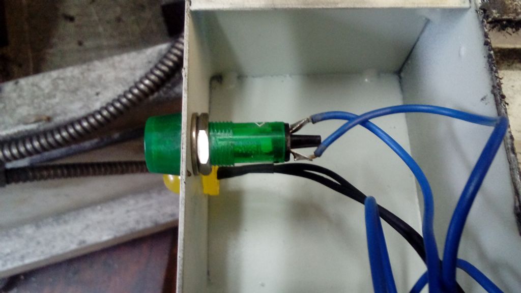

      I wonder if any of the electrical/motor gurus can help
      Over the last couple of weeks I had noticed the odd drop in speed of the X3 while cutting, not enough to stop it just a slight fluctuation for a fraction of a second. Thought I would have a look at the brushes (switched off at wall socket) and one was worn down to about 1/4" long the other fine so I put in a new one.
      Turned back on and nothing. Took brushes back out and held multimeter in the brush sockets and got 34V but that did not vary when pot turned. Then tried the same with a lamp in a pendant and no sign of life, tried the multimeter again and nothing.
      I am getting 240V to the board but not reading anything where the motor connects. The green light is not comming on but I think that may have been dead before and I am getting 240V to that as it connects to teh on/off switch not the board.
      Any suggestions of other things I could check?
      Thanks J

          My SX3 has had the board in the head fail and the main board has a problem too as the tapping function doesn't work anywhere. It is 10 years old. The green light not working was a symptom before total failure. I know nothing of electronics unfortunately.

            I think the main control board has some fuses, so worth checking those before you go much further. Can't suggest anything else at the moment, except maybe a loose connection somewhere.
            #319347
              No fuses on the board.
              Quick blow fuse is fine as power has to go through that to get to the board.

                Check fuses, then check cut out switches on guards and covers. Are the new brushes seating on the commutator?

                  I have checked all the obvious things. Loose Wires and interlocks
                  As there is no DC output from the board I don't think brush seating is the problem, lamp test also shows no voltage to motor.

                      Looks like the fault was probably caused by a plonker.
                      I went back and did a continuity check on the safety interlocks, chuck guard was working OK and I had it in the closed position. just thought I would check across the safety cut out on the front of the machine and it was open. Quick turn to release the button and circuit complete.
                      Strange as I had pressed and released this button a few times to see if things would work but depending on how it is tripped you do need to turn the power off to reset it, combined with the non working green light I had not set it correctly.blush
                      All back together and running nicely now. Thanks to all those who responded in the thread and by PM.
