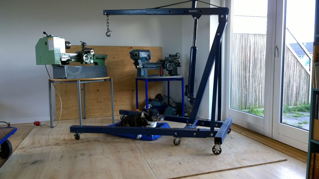

      Two comrades and I each gave a good month wage to buy a single Myford S7 in 1965.
      Yesterday I bought an almost complete Boxford A and a Chineese 916 for 900£ total.
      Plan is to rebuild both with the biggest possible spindle.
      It can then be answered once and for ever if UK or China made the best lathes.

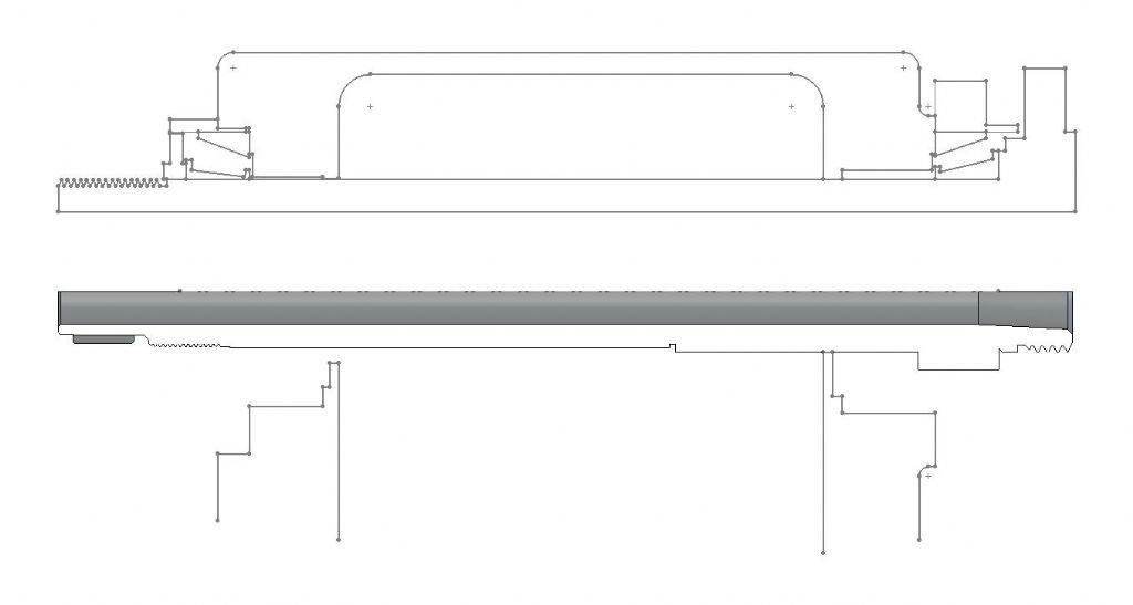

                                    The 180 spindle with 30mm bore described some time ago could have been made on the 180 size lathe.
                                    My wish is to inspire importers and chineese manufacturers to sell kits for upgrading and I have resently seen a complete headstock kit for a 210 lathe with 38mm bore.120£ I think.
                                    The goal at moment is to make a 50mm full bore spindle for a Boxford.
                                    Very handy for british veteran motorcycles in living room.
                                    Boxfords and Allegros (the only secondhand cars I could afford some time ago) share the trait that no tears are wept when they go to scrap.
                                    The max diameter of spindle is 160mm and length about 400mm,so should be within Boxford possible making envelope.
                                    Sketch to follow

                                        A sketch of Boxford headstock with standard spindle and new with 70/50mm and 160 flange for chucks.
                                        As far as I can measure the bearing boring and seals and traps and what not was made in one setup and it will be possible to put in the new main bearings and hope for concentricity.

                                          I have sold the Boxford as parts and got what I payed.
                                          The simplest Boxford spindle enlargement is to put two 32910 bearings in the 72 and 76.2mm holes and make a 50mm outside spindle .The bending stiffness goes up a factor 2.5 ca.Everybody can do it and not much sport.
                                          My 918 lathe has been put on a tombstone and has been partnered with a 100£ industrial sewing machine motor of 600 watts and 4Nm torque.
                                          There is a video here and I have a feeling of it being a long and nice afaire .
                                          918 lathe and blue swarf
