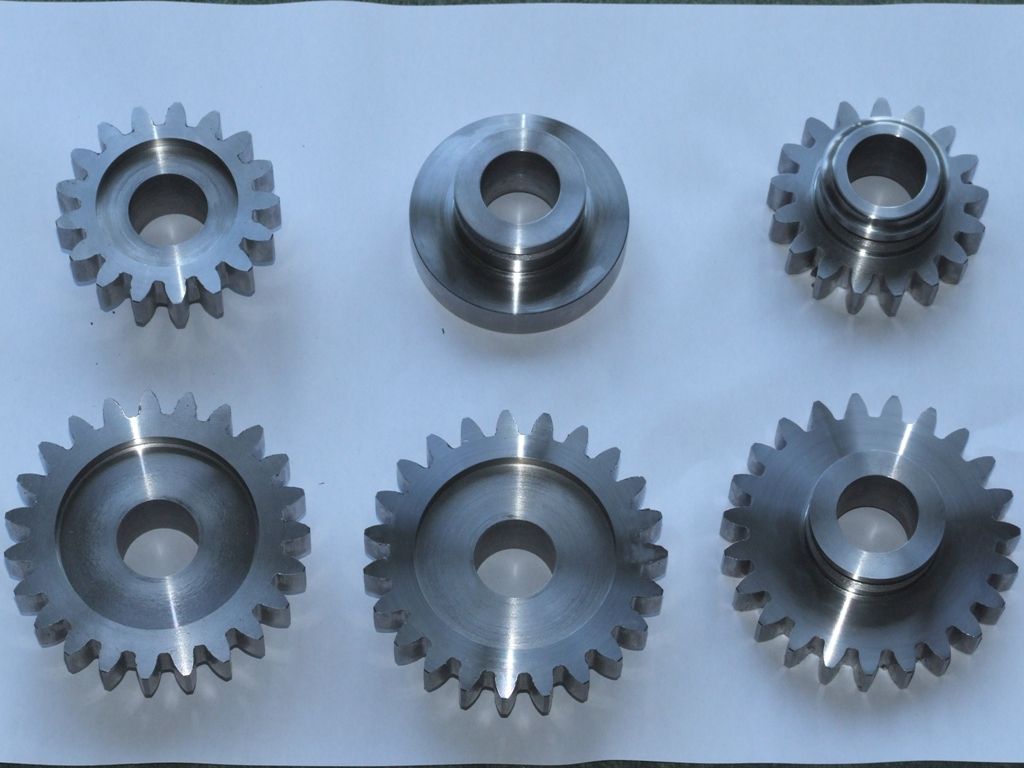

                                            #432628
                                            Anonymous
                                              Must be getting old, I thought I made my 6DP traction engine crankshaft gears from EN8, but looking back I actually made them from EN24T. Gears shown here, before the splines were machined:
                                              If I recall correctly I had to turn at fairly high speeds to get the nice finish with insert tooling; probably 800 or 1200rpm. Depth of cut and feeds were nothing special.
                                              I cut the gears in one pass; anything else is a waste of time and just increases wear on the cutter. Spindle speed would have been around 60rpm. I can't remember what the feedrate was, but I normally aim for around 4 thou per tooth when horizontal milling. Anything much less and the mill shakes. Gear cutting shown here; coolant not essential but it does help cool things down:
                                              6DP Pinion Gear
                                              The cutter was secondhand, bought from the US via Ebay. A new cutter should cut a complete gear without a problem, although it may depend upon the source of said cutter.
                                              Andrew
                                              #432631
                                              Adam Harris
                                                @adamharris13683
                                                Andrew many thanks – so 60 rpm, full depth "one pass" cut, but rate of table feed (I don't understand what you mean by 4 thou per tooth)?
                                                Edited By Adam Harris on 10/10/2019 11:44:06
                                                #432632
                                                  Multiply RPM x number of teeth on the cutter x 0.004" and that will give distance per minute feed.
                                                  #432634
                                                  Adam Harris
                                                    @adamharris13683
                                                    Aha thank you Jason. 36T x 60RPM  x 0.004" = 8.6 inches/minute
                                                    Edited By Adam Harris on 10/10/2019 11:50:34
