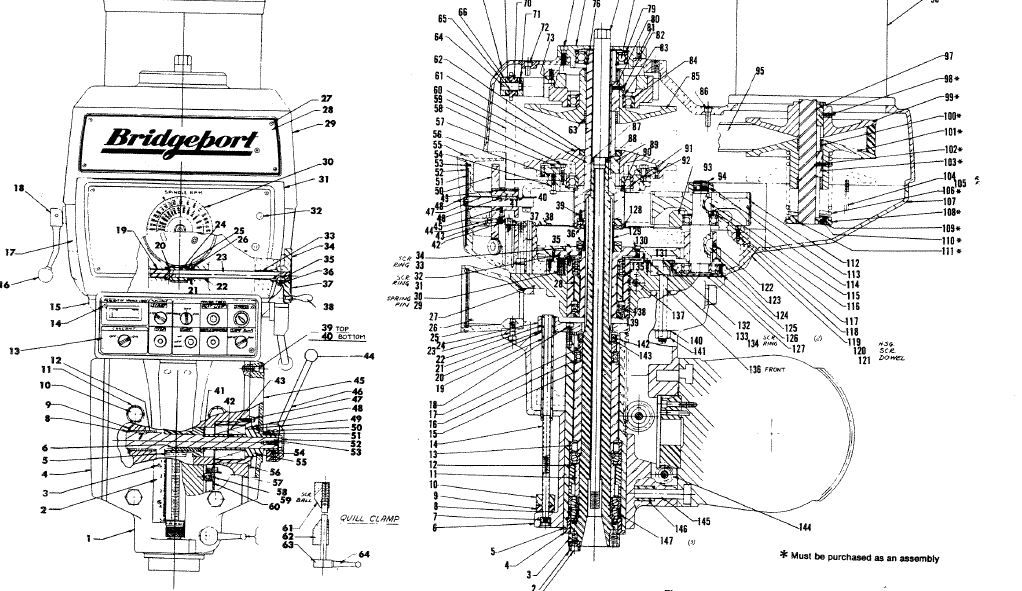

      Does anyone know what the set screw is for at the back of the 2J head its the same as the set screw A on the side but at the rear?
      It says the backgears are pregreased for life so is this where they inject grease at factory fill, and is it really greased for life due to the age of the equipment now or should grease be added to replenish due to age?

              I had a look on the Jhead diagram but cant see it on there so here is a pic I found showing the rear of a Varispeed 2J head the pic shows the rear of the head just above the plate is a grease nipple.
              Mine does not have a grease nipple but a setscrew like setscrew A but at the rear?
              I assume its for greasing the bull gear and greased for life maybe it should have a topup ? any thoughts

                That link has a lovely drawing of the head do you have that on the varispeed one?

                  There's probably one out there but I have the stepped pulley machine myself. However, there is a nice section view in the "series 2 manual". I have collected a variety of BP manuals from the internet over the last few years – you want a copy?

                    Thanks for that drawing I didnt have that one, great for looking inside.
                    I have some manuals collected from the internet too from a few years but as yet no mention of the setscrew at the back of the head, I think its where the factory inject grease once its all built up and then pop the grubscrew in but I wonder if the setscrew is for what I think then maybe greased for life didnt mean 40/50+ years and maybe it should have some replenishment?

                          I didn't even know my Bridgeport had a hole there. It is shown in some of the isometric drawings in the manual, but not mentioned in the text. It doesn't seem to appear in the exploded parts diagrams in my manual.
                          On the machine itself I don't even have a set screw, just a threaded hole. embarrassed Poking an Allen key down the hole results in the key being covered in brownish grease, nothing like the white lubriplate grease used in hole A. I've never done anything with the hole in 15 years, so I don't think I'm going to start worrying about it now.

                            Andrew, Richard, you're still one-up on me. I don't even have a hole there, threaded or not, and certainly don't have an information plate like that shown in Richard's photo. My (horribly abused, and neglected) Series 1 2HP machine was built in Singapore in the mid-eighties.
                            Speaking of Screw A and Lubriplate, I agonized for a long time over sourcing some of the genuine stuff, but finally decided to have a look at what was in there first. After removing the screw I saw nothing. A probe hit a dry hard wall about 10mm in. I spent ages with a pick trying to carefully remove what I deduced was dried grease, without pushing it further in. In the end I used a 7/32" drill bit to dig it all out then squirted in some standard Lithium-based grease. We'll see if it outlives me.

                              Roger, I to have no hole in my 1990 built series 1 2HP machine which also has the Singapore built head.
                              I seem to recall the earlier machines used Lubriplate in hole "A" and possibly in the rear hole "B" ? I still have a tube of Lubriplate but will most likely just use a lithium based grease when it is gone. An ebay seller lists the Lubriplate as part of a Bridgeport service kit but it is pricey.
