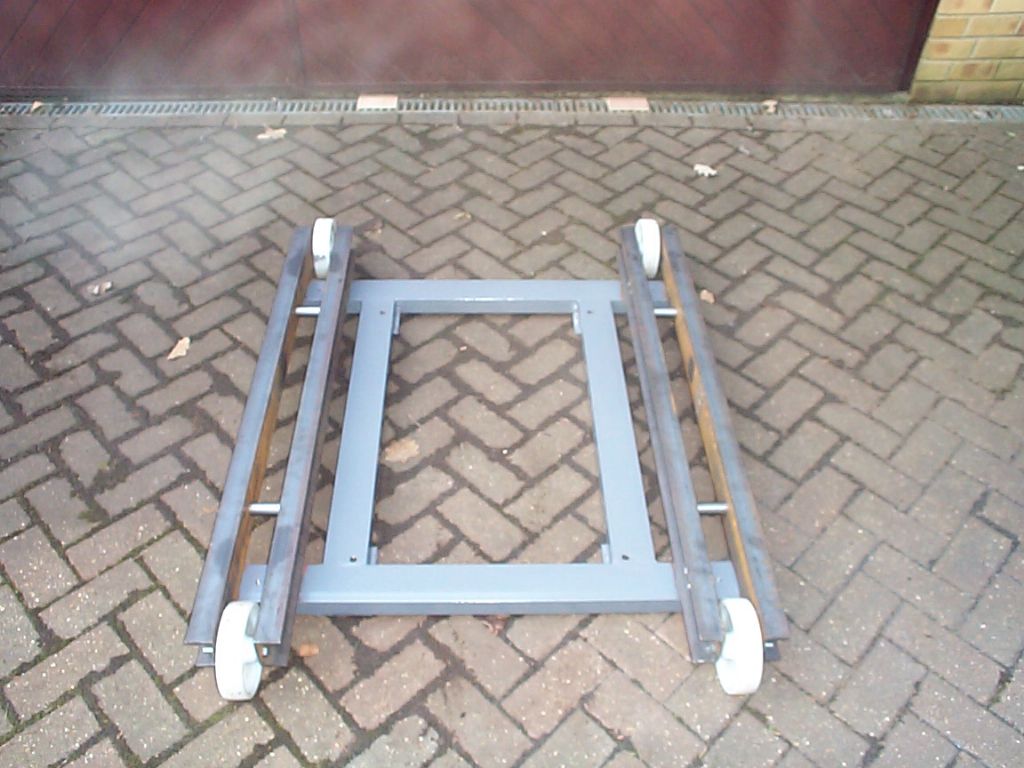

                                KWIL
                                  @kwil
                                  BpT Frame
                                  This is how I moved a complete Bridgeport single handed, inverted head into travelling position to lower centre of gravity. Only needed to lift it just clear of the deck onto the light blue frame. Holes are threaded (welded on nuts underneath) to secure mill base. Use of lifting eyebolt no problem, "Bridgeport approved"!
                                  Edited By KWIL on 01/08/2013 19:32:34
