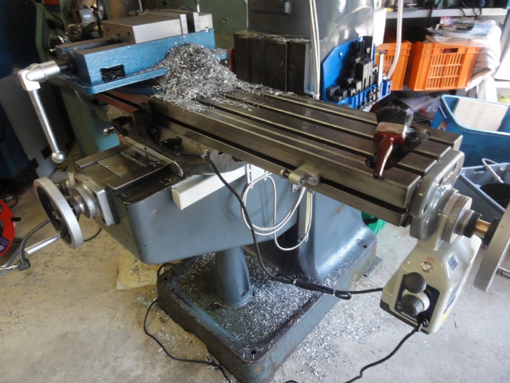

      Hi All,
      I am looking to add a power feed to the X and possibly the Y axes of my A&S machine. Would anyone know if I will need a new lead screw as all of the power feed kits seem to be designed to replace a machine with existing power feed i.e. they have a lead screw which protrudes sufficiently past the table end plates. Hope that makes sense? In essence is my old lead screw long enough (don't think so), do the kits come with an extension for this manual type of lead screw? All advice very much appreciated. Nathan.

        daveb
          @daveb17630
          The leadscrew extension does not come with the power feed but they are available separately. It's a fairly simple part if you have a lathe, just a piece of bar turned down as necessary and a connecting sleeve. I'm sure there are drawings available on the web, may be worth trying HSM. I made one for my own machine but, didn't keep a note of the measurements. Might be worth an internet search, Bridgeport feedscrew extension for Align/Servo power feed. Dave

            @muzzer
            The electric feeds used on Bridgeport-type turret machines are designed to be retrofitted to manual machines without butchering or replacing the leadscrews. On the X and Y axes, the bracket is swapped so that a bevel gear can be fitting into the same space. The Z axis (knee) is a bit less clean – an extension is added to the original drive shaft.
            Align (Taiwan) are one of the main manufacturers – take a look at the X, Y and Z kits they make. There are many clones out there and there must be literally millions in use.
            I have an Align AL-500S on my X axis – great addition! You can see the grey bracket that comes with the kit here:
            Murray
