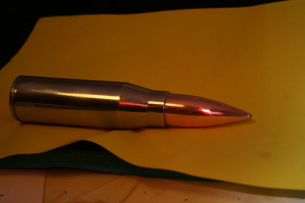

                    Turning copper was also mentioned above by SOD.
                    By coincidence I turned up a dummy rifle cartridge/bullet in brass and copper yesterday evening, for a mate.
                    Results below (for the shooters amongst us, I based it on a .50 BMG case, scaled up by 120%).
                    I turned the case out of a chunk of 1" brass bar I has lying around, and the bullet out of a piece of 5/8 copper bar. Overall length is just short of 7".
                    I also love turning brass, but as stated above, don't ask me what speeds, I just knew what was right, as it told me.
                    There was a bit of fiddling as I turned the extractor groove, plus mimicked a fired primer in the base.
                    And predictably, turning the copper bullet was a pain, horrible stuff, I would have been better turning a lump of Cheddar!
                    Five minutes on the polisher, and it was done.
                    But, overall result, not bad – in fact, I don't want to give it to him now!

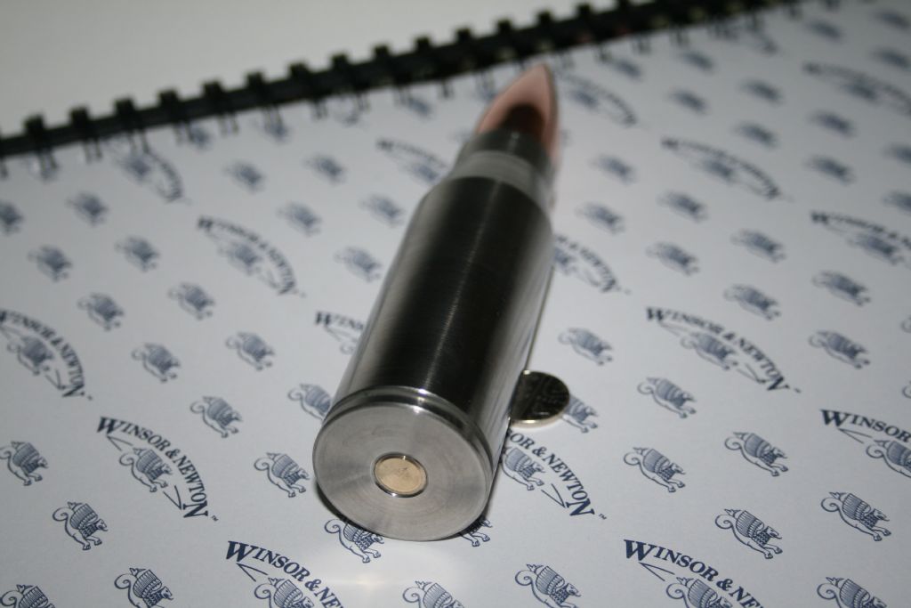

                        Honest …I was going to do a candlestick… make it up as I go , like you do … but I liked that bullet too much , so I converted it half way through and made myself one . blush
                        304 stainless case ,and I forged the bullet up to 1" dia , from a bit of copper bus bar 3/8" thick , that i had , and then turned it into shape . It's 7" long

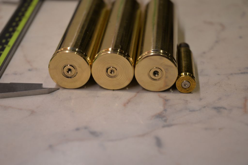

                              On a centrefire cartridge, the primer will have an indentation in it after the firing pin has hit it and it is fired. Nothing else, the primer doesn't go anywhere. So, strictly speaking, the primer showing in hacksaw's cartridge looks unfired.

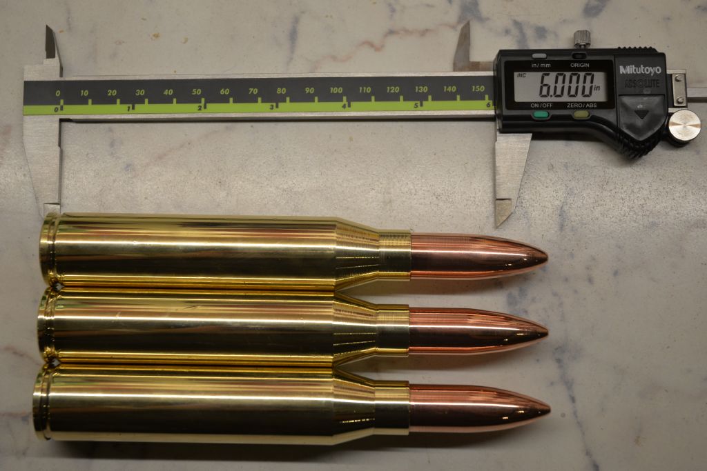

                                Earlier today I went into my local gun shop, and my mate that owns it saw my dummy cartridge and said he wanted one.
                                I solved this and the fact that I didn't want to give away the original, by making two more this evening devil.

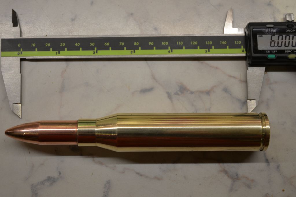

                                  I machined the bases of my dummy cartridges to look like they had a fired primer.
                                  On the far right is a real fired .308 Win case, showing the fired primer smiley. It looks tiny compared to the dummies! surprise

                                    Mine took a lazy /slow 4 hrs , but i had to fart about making a copper flat plate into 1" dia.. and the stainless was way oversize..so took a while to turn it down .
                                    I'm going to give it ,at xmas ,to a good friend / client , who shoots , and has everything money can buy . But he won't have one of these ! Sorry to pinch your idea !!

                                      Almost a kilo? I just weighed mine (yes, I'm that sad blush), two both weigh 504 gms each, with the third at 510 gms. Quite consistent considering there was no accurate measurement, I made each largely by eye!
                                      However, I am now feeling inadequate, but nevertheless eyeing the long bar of 50 mm dia 316 I have in the workshop devil

                                                    Mines solid …and heavy…I 've shrunk my bullet bit in with heat on the case , a lot , the bullet just slipped in ! ..it won't come out now without mullering it .I'll give it to him quickly ..laugh then he can have any problems !!
