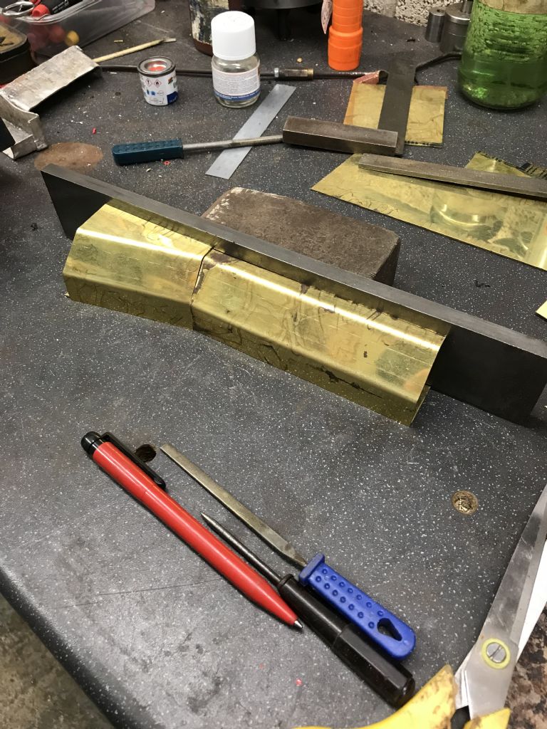

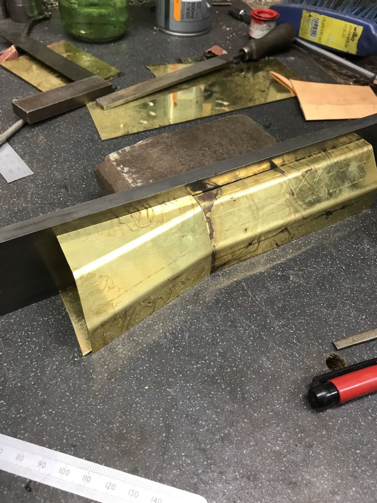

        I have now turned my attention to stripping and painting the tender for my 5" Class 7 loco.
        There is no tool tunnel fitted and i would like to add one.
        I searched out the series by Doug Hewson, and found the article.
        Using his template and dimensions i have cut and folded the parts, but they do not look correct.
        It all looks bit over size and the front end looks different when folded to the picture in the article.
        Can anyone help please.
        Brian

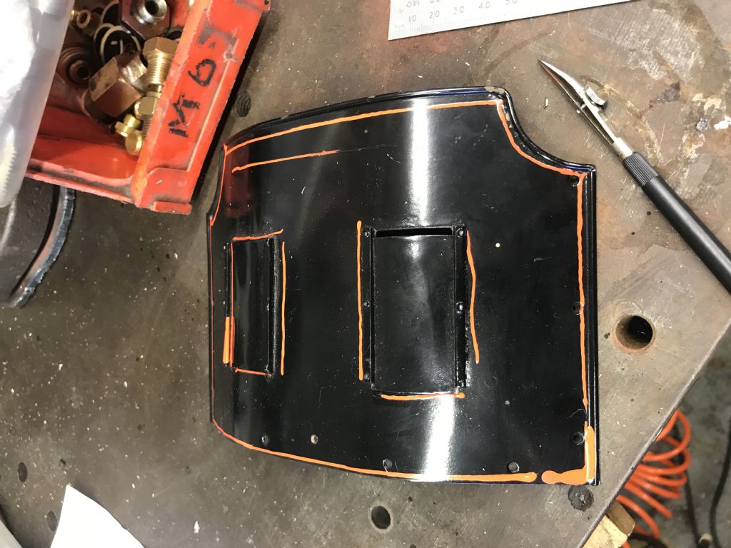

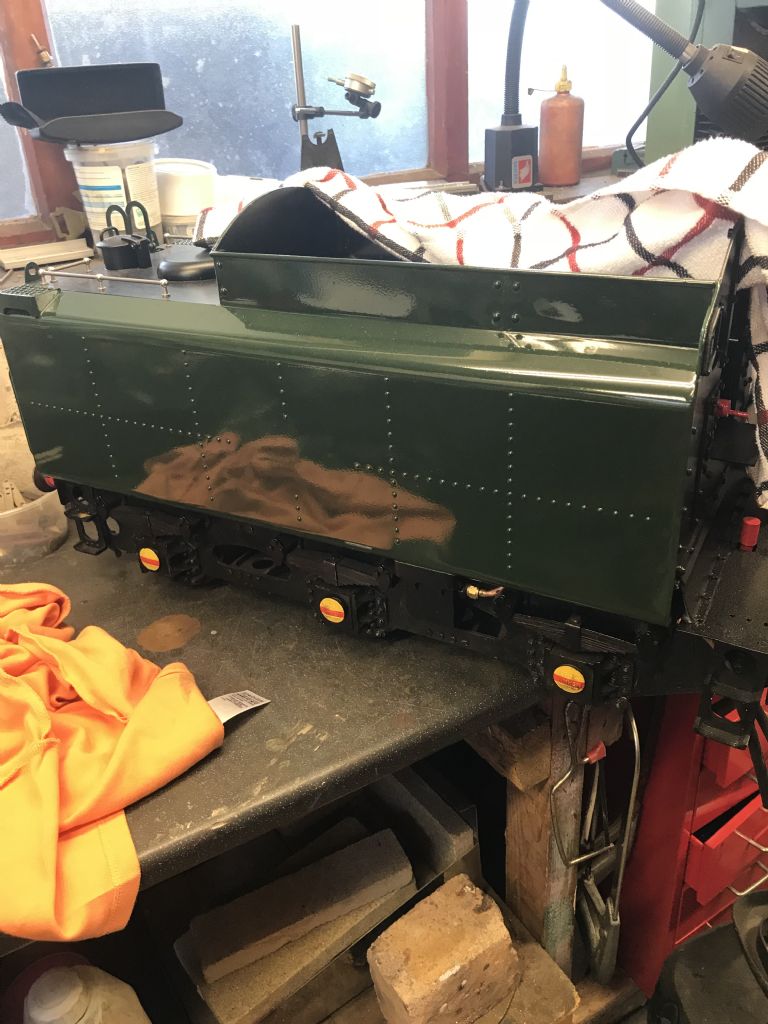

              Finally finished the tender rebuild and its now ready for some transfers and lining.
              I thought i might have a bash at lining myself. A club friend lent me some lining pens and i had some humbrol left from a 00 model paint job. So this is what i want to paint>>>>>>>>
              Brit tender
              And this is my over confident practice on an old loco roof. LOL. cheeky
              Old Loco roof
              Now i know it dont look good, and i need to practice.
              so this is my plan:-
              1. the pen does not hold a lot of paint. Need a better application tool.
              2. the paint was a bit thin. Buy some more.
              3. you have to start very carefully or you get flooding. This one is practice.
              4. its not put me off trying again. when i dont know, daughter comes tomorrow form NZ for three weeks with children. wink
              If all else fails i might try Fox transfers!!!
              Don't all laugh too loudly, i don't want to hear you all in Huddersfield.
              Brian
              #363398
                You need a Border pen if you want to hold more paint, they are a lot wider.
                #363399
                  You have my sympathy, Brian … and my respect for trying !!
                  I remember [decades ago] watching the chap in BSA, lining a petrol tank.
                  Tank supported on his left hand, and a fully loaded dagger brush in his right
                  The classic D shaped line was produced in a matter of seconds; then he flipped the tank around on his hand and did one to match on the other side [these are of course, mirror images!].
                  #363400
                  roy entwistle
                    @royentwistle24699
                    The draughting pen would normally use ink which I suspect would be a lot thinner than paint. Also you appear to have done the job freehand. I would recommend using a straight edge even if you use a border pen as suggested by JasonB
                    Roy
                    #363402
                    Jon Lawes
                      @jonlawes51698
                      Can I just say what a fantastic job you have made on that tender. I'll be attempting a 3.5 BR1D soon and if I can come close to the finish and fit of the one you have made I would be very happy. Nice work.
                      #363410
                      Boiler Bri
                        @boilerbri
                        I did use a ruler on a small part and then really just played around.
                        I will have a look at the border pen than you.
                        Bri

                          #363414
                          pgk pgk
                            @pgkpgk17461
                            Would low-tack pinstriping tape help?
                            **LINK**
                            It might be awkward for the curves so perhaps this
                            **LINK**
                            I've not tried the latter. When i did some lining on my RC heli canopies I used the thin blue 3m tape and eyballed two parallel linesarond the curves
                            pgk
                            #363421
                            Paul Lousick
                              @paullousick59116
                              Drafting pens are not suitable for applying paint. They are used with thin ink.
                              Pin striping is best done with a special pen with a roller at the end like a Beugler (rollers are available in different widths and combinations for painting double lines) or special  brushes with very long and thin bristles.
                              http://beuglereurope.com/english/index.html
                              Lots of videos on Youtube showing the application of pin striping.
                              You should also use a thicker paint, used by sign writers which contains more pigment than ordinary paint which is applied in one application only. Second layer difficult to apply.
                              Paul.
                              Edited By Paul Lousick on 22/07/2018 23:06:22

                                            RMA
                                              @rma
                                              Getting back to the tunnel on the tender, from my drawings the tunnel is parallel along it's length. Yours seem to expand into a cone shape. The cross section is a strange shape because it fits within the coal chute. I'm building a 3.5 inch Brit and the tender is a laser kit which doesn't have the chute, although he's cut a hole in the bulkhead. I am trying to make the complete tunnel, which looks much better.
                                              Looking at your photos, there seems to be a front bulkhead missing.
