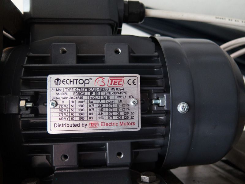

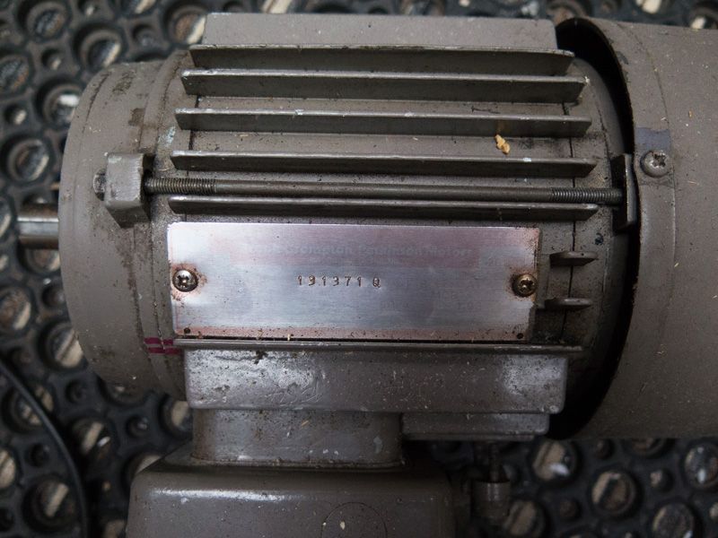

                        I also had the issue of a non dual voltage motor. The star termination points were buried deep inside the windings and not easily reached.
                        I ended up purchasing a new dual voltage motor to fit to mine. I also fitted a larger VFD than required for the reasons mentioned above.

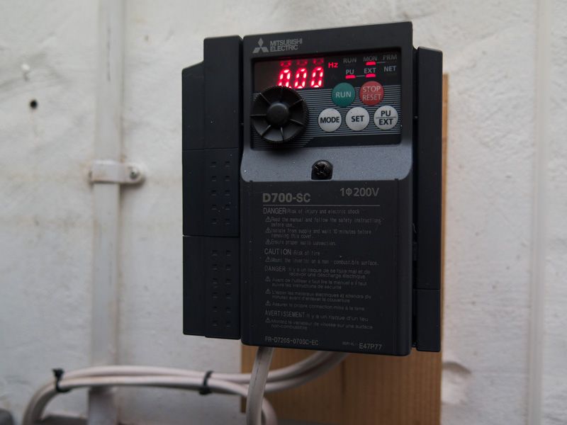

                          I used a 1.1KW Yasgawa inverter on mine, you could getaway with 0.75KW as it is a 1HP motor. I have used other brand inverters on my other machines so I am not "Brand" loyal.
                          No problems and straight forward installation.

                            Here are the images I said I would post.
                            It seems though that the motorplate of the original is no longer readable. But here it is anyway:-
                            But here is an image of the motor I replaced it with. This was a simple task and the pulley went straight on without modification or hassle.
                            And this is the VFD I used obtained from Newton Tesla of Warrington.
