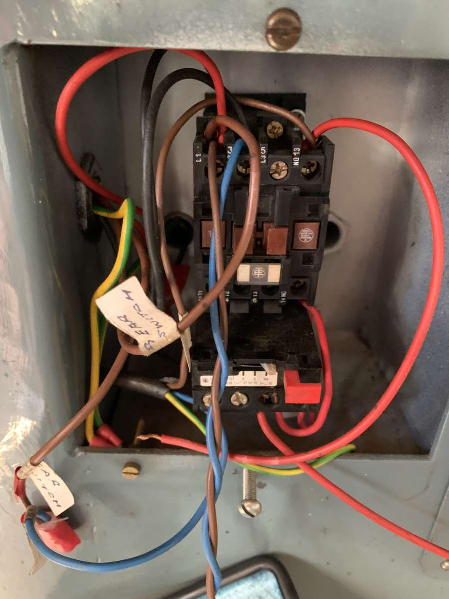

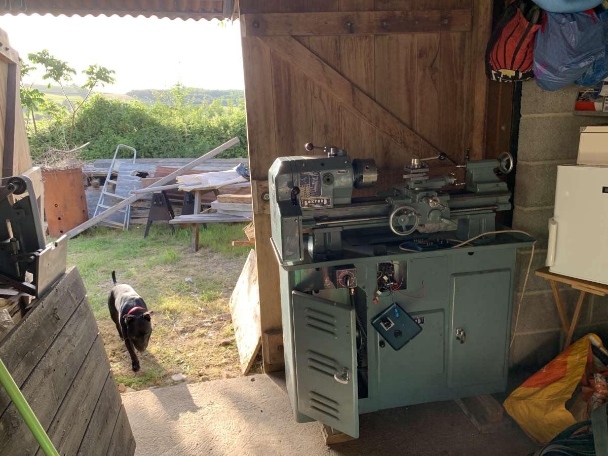

      I’ve just acquired a Boxford CUD which appears in decent physical condition but it comes with an electrical issue.

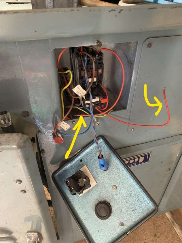

      Opening up the switch box reveals 2 red wires to the right of the connector box are detached:
      BXF 1
      IMG_6103
      Any advice as to where should these be reconnected?

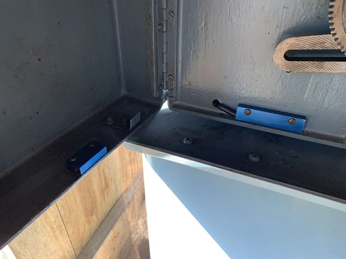

      There are also a series of door sensors which I assume are there for safety purposes? At least one of these has the wires detached.
      IMG_6101
      These appear to be add ons, for school use possibly?
      Any advice gratefully received and I’d be happy to employ a local specialist to come and sort it out if anyone has a recommendation for someone that operates in the SW / south Devon UK
      #849642
      Hollowpoint
        @hollowpoint
        Does the lathe run?
        The orange and yellow wires on my Boxford are for the safety interlocks or micro switches. They may have been disconnected to allow the lathe to run with the cabinet door open.

          No, not presently, the indicator lights up and I’ve now connected the 2 wires ot the start switch, powered it up, made a little noise but nothing else. I think I’m going to try a direct connection to the motor, to check thats operative at least.

            A little noise likely means no start capacitor/winding operational.

              I was just going to say that the wires should be connected to the start button. to test the motor all you have to do is put the power on and, with an insulated screwdriver, push the middle of the contactor in. The motor should start. Doing this bypasses all of the control wiring (door switches etc) It may latch on so be ready to cut the power should you need to.

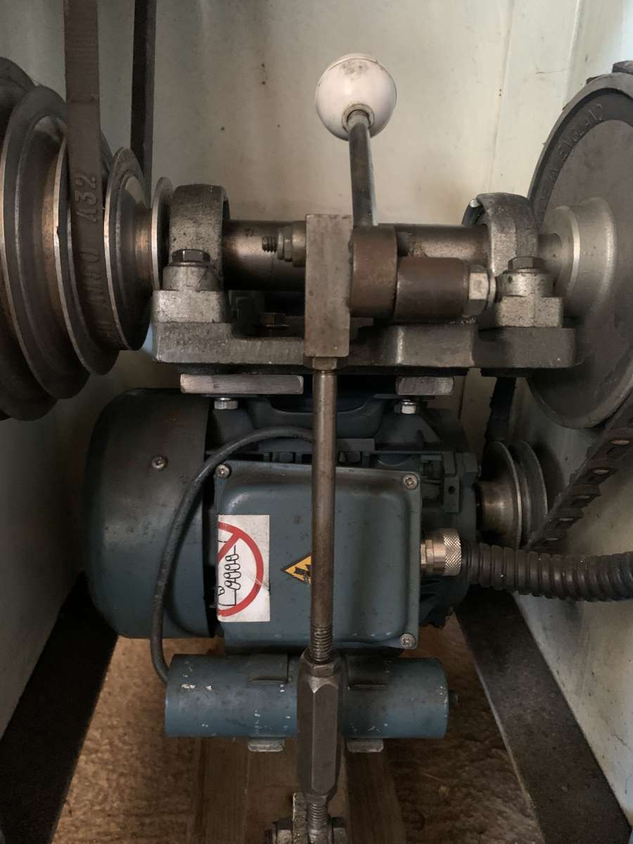

                Hi, do you know if it has a three phase or a single phase motor, if it’s a three phase motor, it won’t run on a single phase supply without an inverter of some sort.

                  I think you need to re-wire the lathe from scratch. You seem to be missing a switch or two for a start.
                  As Nick says some information on the motor would be a good staring point..
                  On the door sensors, only one of these has wires the other is just a magnet. The housings are indentical. The wired one has a reed switch which closes when next to the magnet.

                    Thanks all, I’m getting there. Taking Martins advice I’ve started it up by pushing the contactor in and it works fine both in forward and reverse, (240v single phase motor BTW).
                    So I suppose I’ll now need to check the reed switches in turn to see if any faults.
                    Are these safety switches needed for domestic use? If they are how many should there be? Presently on motor cabinet door, and gear cover, and the back gear lever.

                      Hi lucerne, you should have at least three, one on the range selector on the top, one on the change wheel cover, and one on the motor/belt cabinet door. I would urge that you do have them working for your own safety, as this is a fairly powerful machine, and you will get hurt if you get tangled up with it inadvertently, if you forget to stop it before opening any covers while it’s running.
                      Do you know the power output of your motor, as it really needs to be at least 1hp, but even with a 1hp motor, you won’t get the top speed, and probably not the next one down either. Not sure how the spindle lock button is fixed to the locking pin, so you may have to make one.

                          Yes, I agree and will make sure they’re working or replaced. They don’t appear to be expensive items. I know of at least 2 knife makers that have either died or been seriously injured by belt grinders.

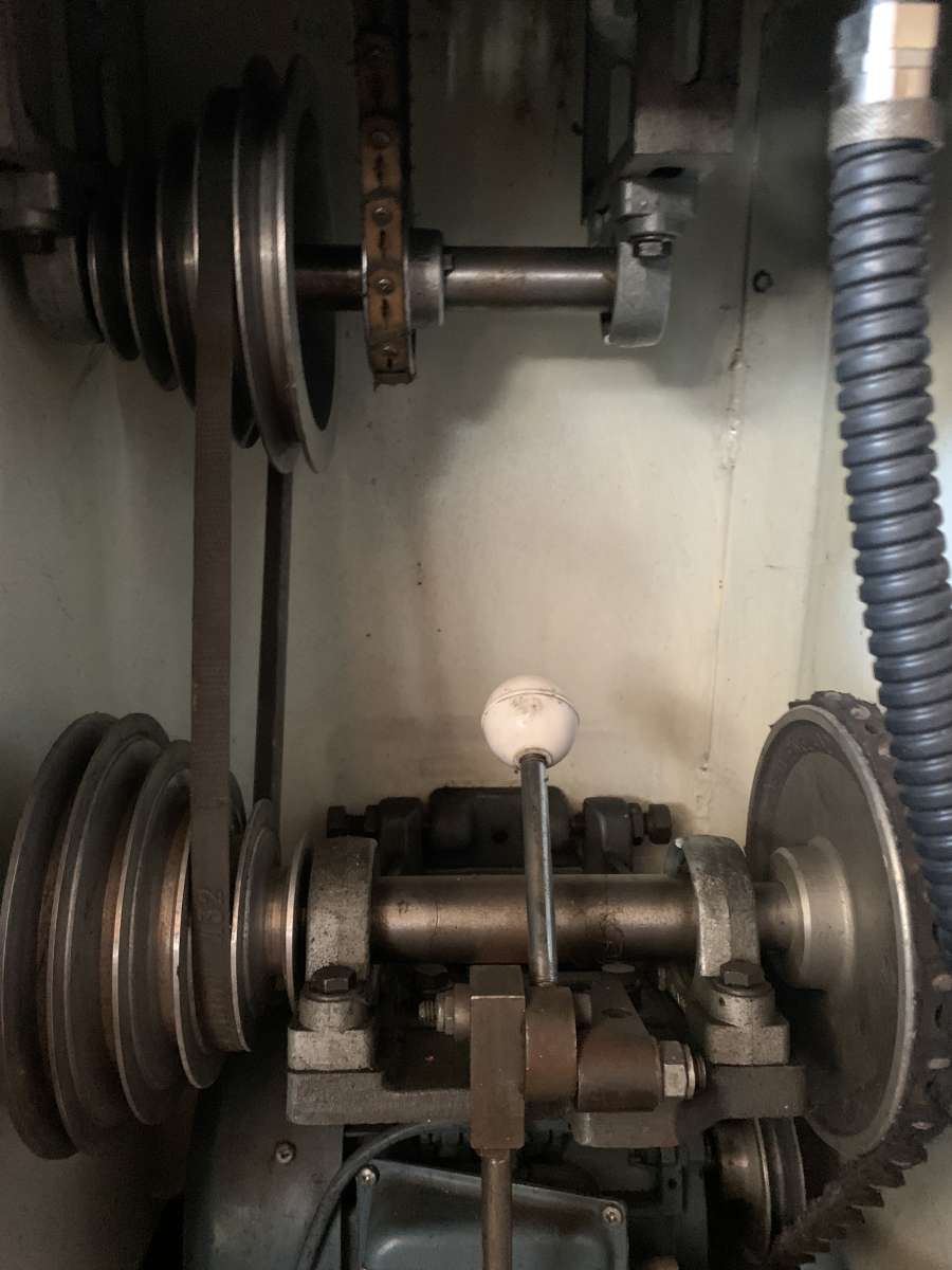

                          The motor appears reasonably hefty:
                          IMG_6111IMG_6110

                            Spindle lock button – essential for removing chucks, backplates etc.  Please don’t use “Engage backgear and use big hammer on chuck to remove !!!

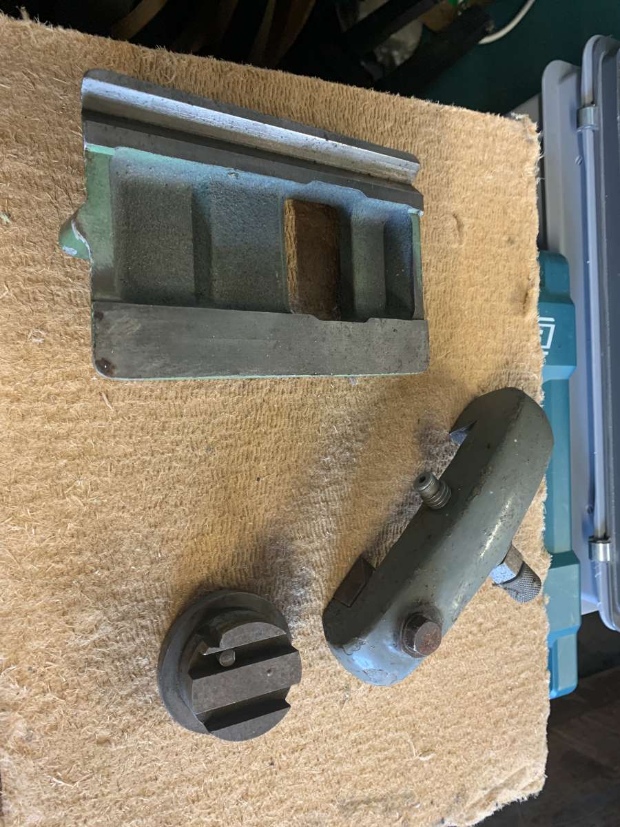

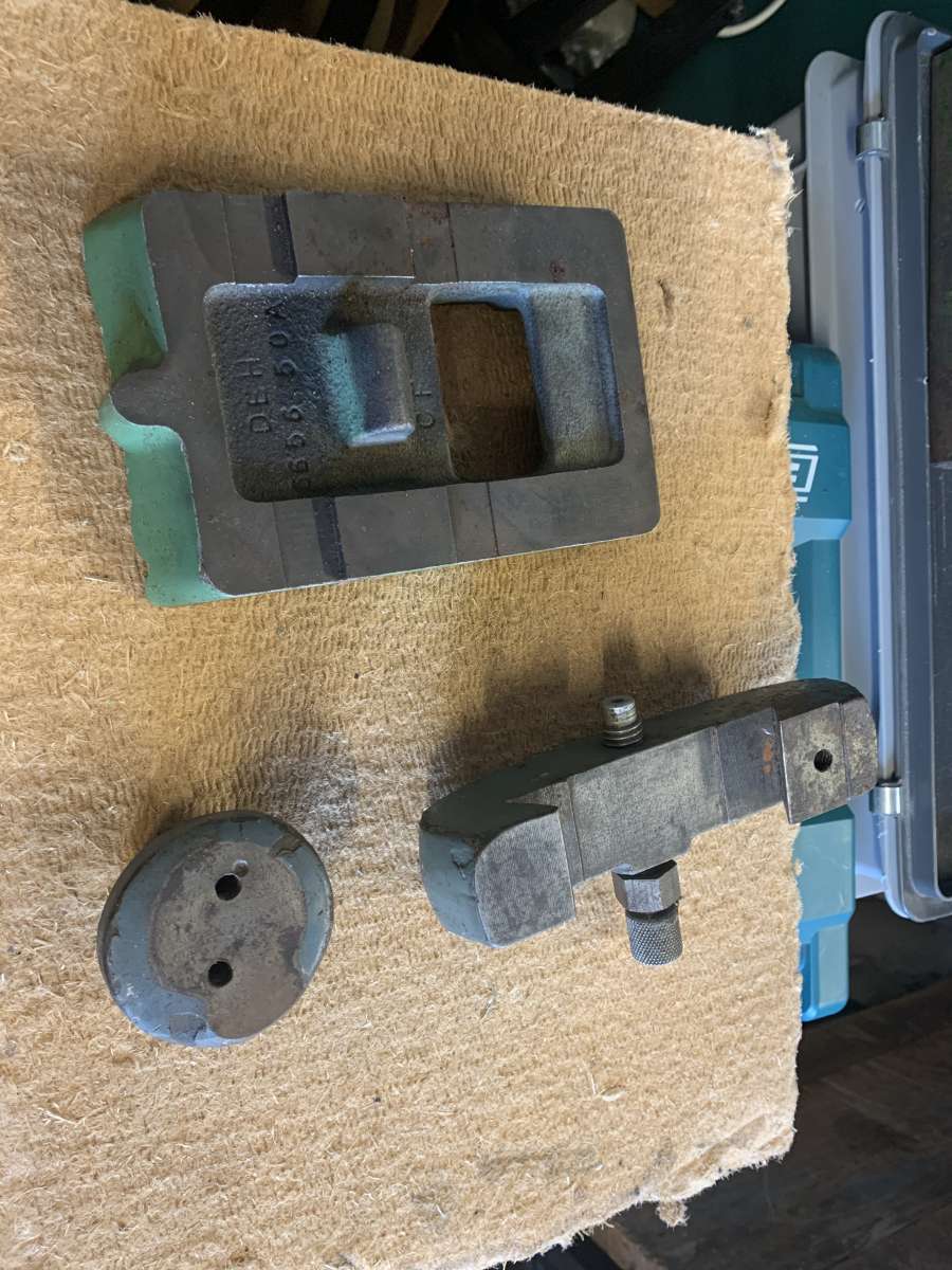

                                            In the meanwhile, does anyone recognise these parts which came with it, along with a good deal of tooling, vertical milling attachment, and a fixed steady.

                                              The item bottom right is an adjustable stop for the cross-slide. Useful for, eg, screw-cutting when retracting the tool on return pass. Others; dunno!

                                                Just realised, the rectangular item looks like the bottom half of a tailstock assembly.

                                                    The round object with two slots is / was the screw cutting half nut engagement lever unit that fits to the front of the apron but seems to have lost the lever. If the lathe has a replacement fitted then this becomes a useful piece of cast iron that should be kept with the lathe for the next six owners to ponder over.

                                                      Thank you, google confirms but it must be for another much larger machine.

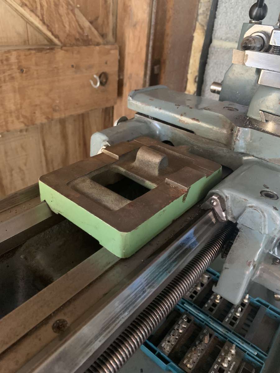

                                                      Yes! I was looking at in in plain sight when I took this pic but didn’t twig:

                                                      Ah, it must be a spare then as there’s one in place, and 😊
